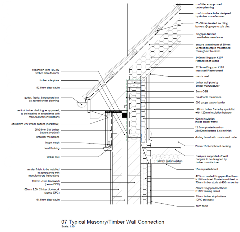

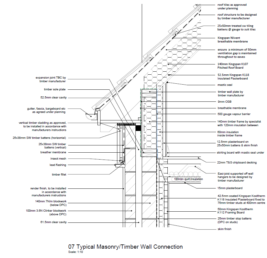

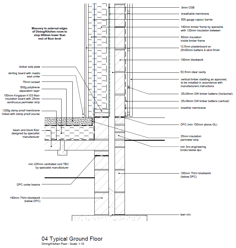

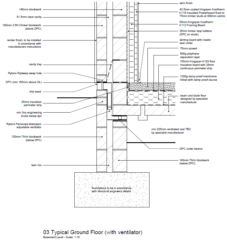

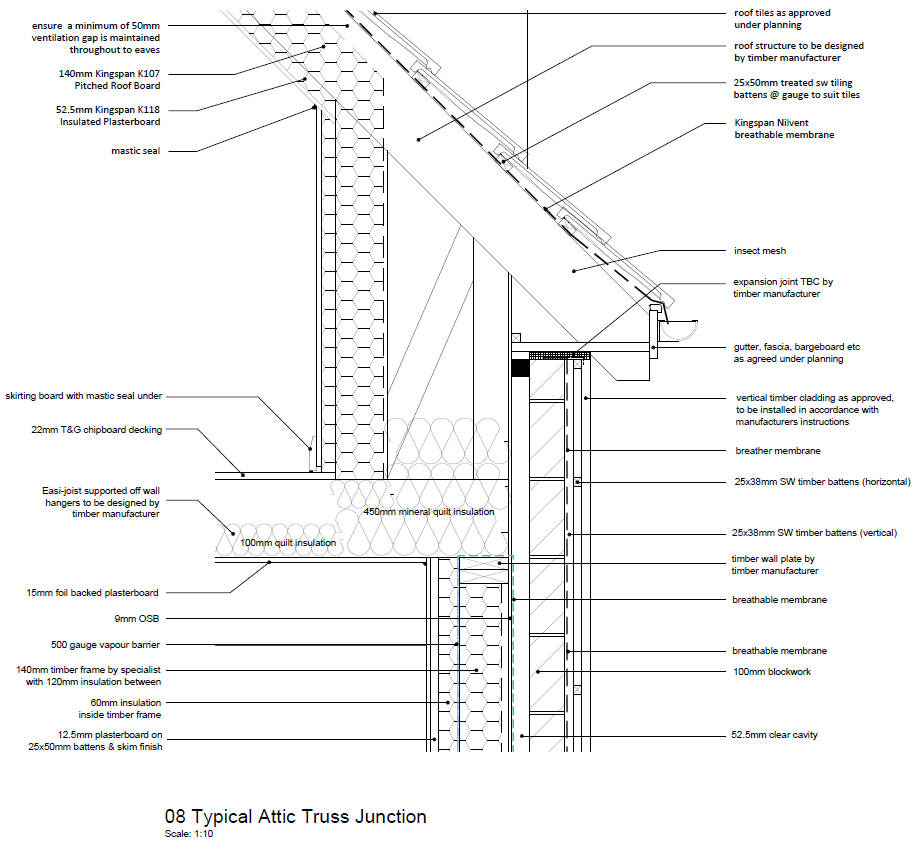

Below is what has been specced at the moment in the BR drawings in terms of wall/roof insulation, any views on how much we'd want to beef these up by to get to 0.15u?
Apreciate I'm putting a lot of info out there and asking a lot, the more I look a the detail the more I feel a little out of my depth, but I'm here for the education and it's much appreciated 👍

Be sure to set aside some funds for airconditioning and/or external blinds if you haven't already.
If the house is built as designed I wouldn't be terribly optimistic about small energy bills either.
The good news is that you're early enough to do something about it. Looking at your architects drawings they're probably not the best source of advice.
Perhaps query with them the cooling and airtightness strategy to test the water.
To echo what @Iceverge says… you need to look quickly at that design as it is barely building regs for insulation ..! What is the purpose of this 140mm block with another skin for the render ..? The mix of TF and blockwork doesn’t make sense, and the blockwork insulation is definitely not enough.
Airtightness in this will be a real challenge and there are gaps in the VCL (vapour control layer) that are visible in the plans above.
Roof design makes no sense either - they have specced Kingspan NilVent (clue in the name here ….. ) which is a breather membrane requiring no air space below, and then spec a minimum 50mm air gap.
I would hazard a guess that they also had lunch with the Kingspan rep last week as I’ve never seen it specced so much on a set of plans ….

Why aren't you insulating the cavity (and making it bigger)? PIR and insulated PB is expensive and 90mm overall is not really that great.

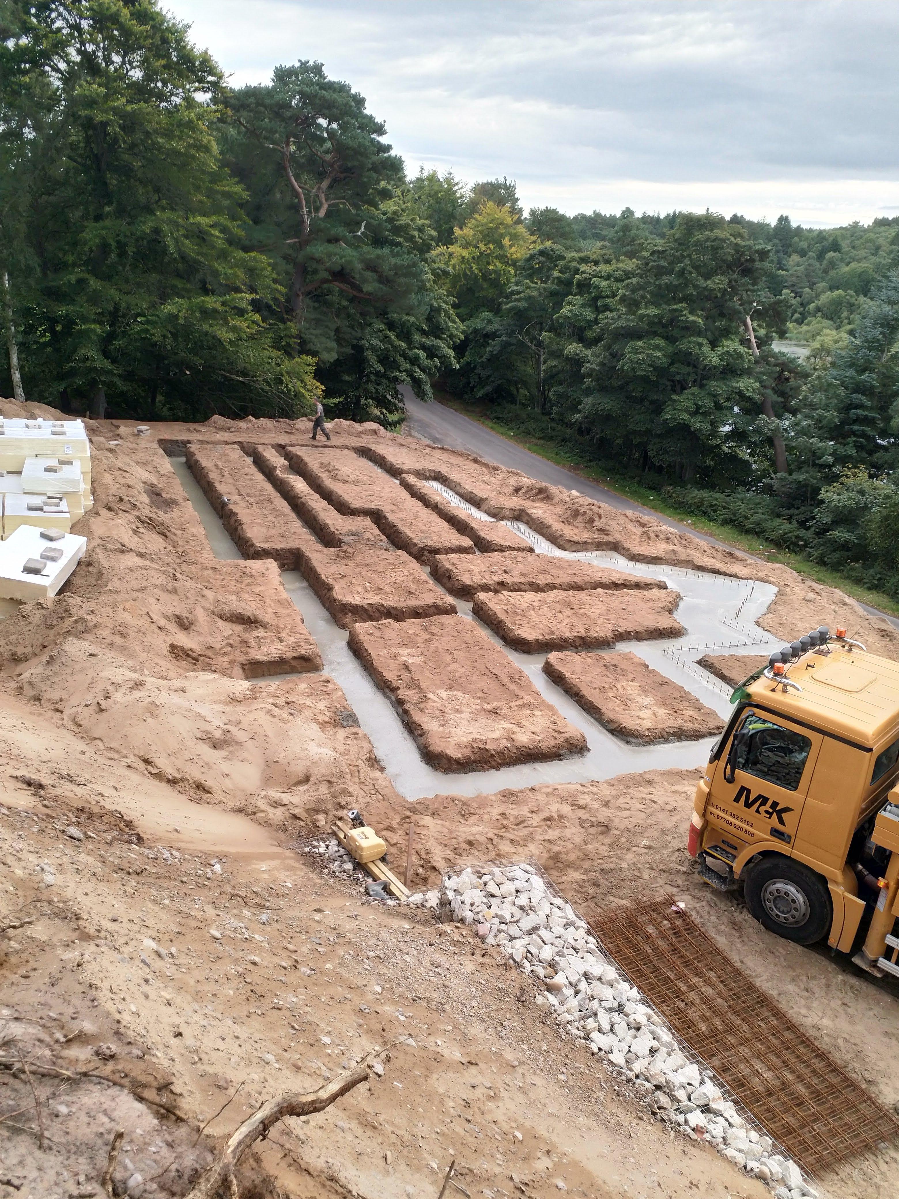

Depending on your soil conditions I would look at an insulated slab rather than beam and block.
Our roof makeup is 0.15 and has been specified as 150mm PIR boards between rafters (600mm) and 37.5mm insulated Plasterboard. This is for a second floor which is in the roof. Unventilated roof.

However I think it's shortsighted not to maximise insulation and airtightness in the fabric where it will be expensive and likely impossible to improve it post build - the two need to go hand in hand but very few architects will take that approach.
Very much a 'here is a pretty and functional dwelling, we'll figure out later how to get it to meet regs' approach.

We're in rural Hertfordshire, soil is clay and pretty heavy, we've had a soil report done and it will fail an infiltration test.

Pretty much any system can work with any shape / size. When you have below ground elements then timber is out for that part but IFC would be appropriate, or even a block or cast concrete system, with appropriate waterproofing (SE specced) for your ground conditions.
The MBC passive slab is not that complex and we replicated it for our basement and ensured that when we got to ground level, the profile matched what their timber frame would have required with their own system - i.e. an EPS insulated perimeter of sufficient thickness to meet the outer leaf (we used 200mm) and a 300mm thick concrete wall (they needed less) to take the soleplate for the load bearing inner leaf - plus structural support for other point loads inside the envelope. Best way to figure that out was to get MBC to design the frame sans slab and hand that design to a SE (or use theirs) to design the sub ground structure.

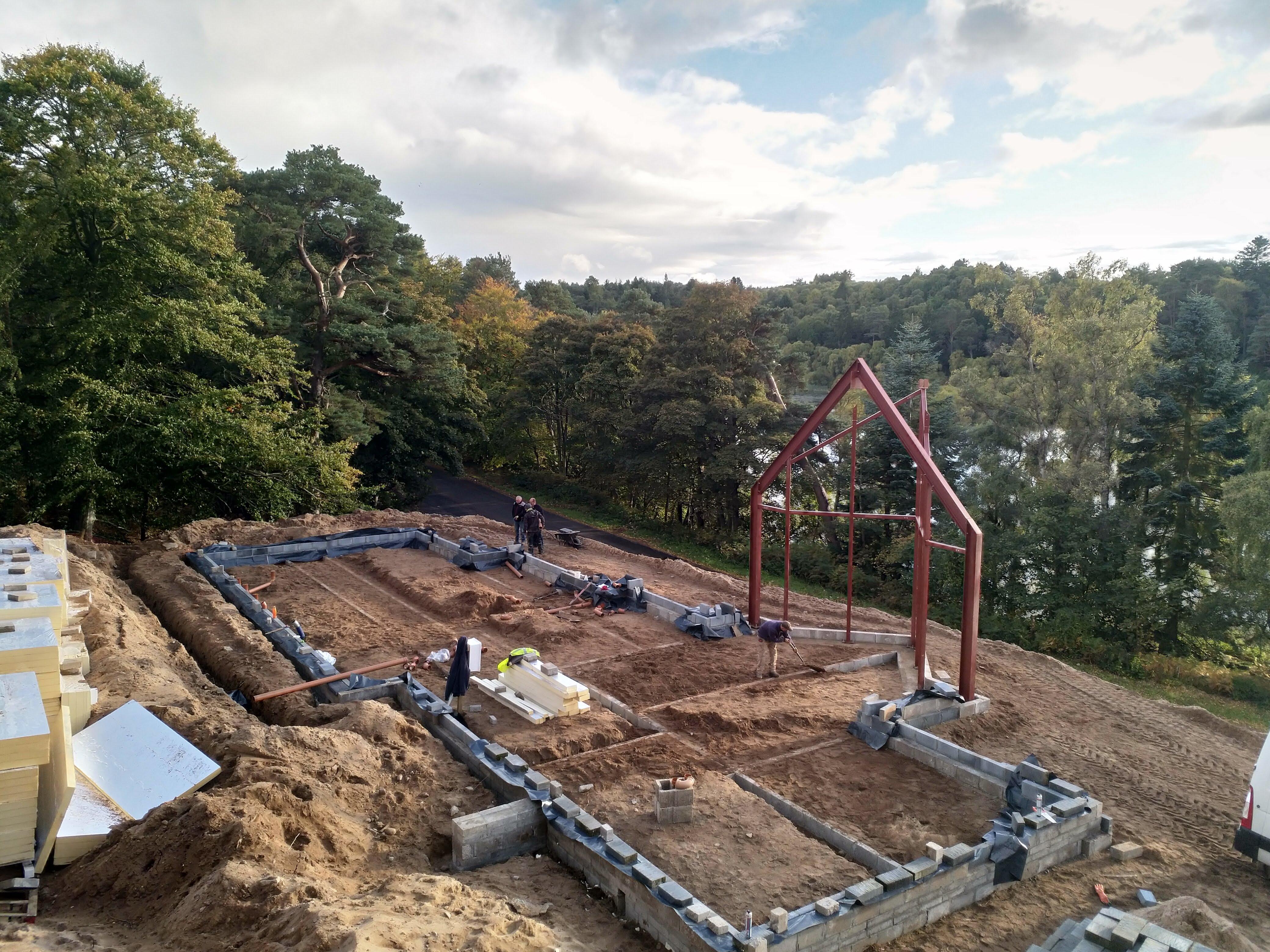

To give you an idea of a normal (ish) foundation on sand (although is really an old sand dune, which is now 10 miles from the sea).
First photo strip foundations, the front wide ones are all reinforced.
Second photo has insulated retaining walls up to DPC and stub walls where structural walls are going. Everything is thermally broken using thermolite blocks
Following this ground leveled, then DPC, two layers of rebar, 160mm concrete.  Then 200mm of PIR, then DPC and UFH pipes then another 100mm of fibre reinforced concrete.
A passive slab would have been way less work.
