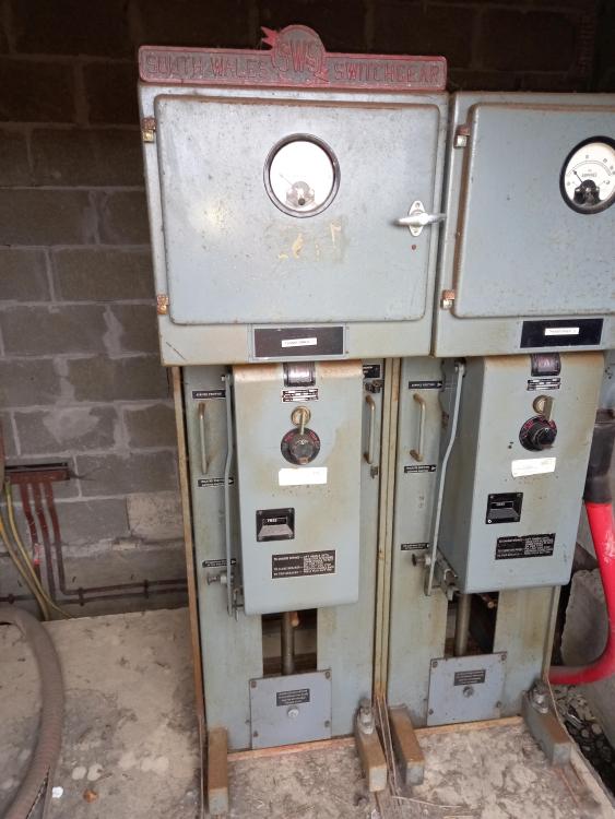

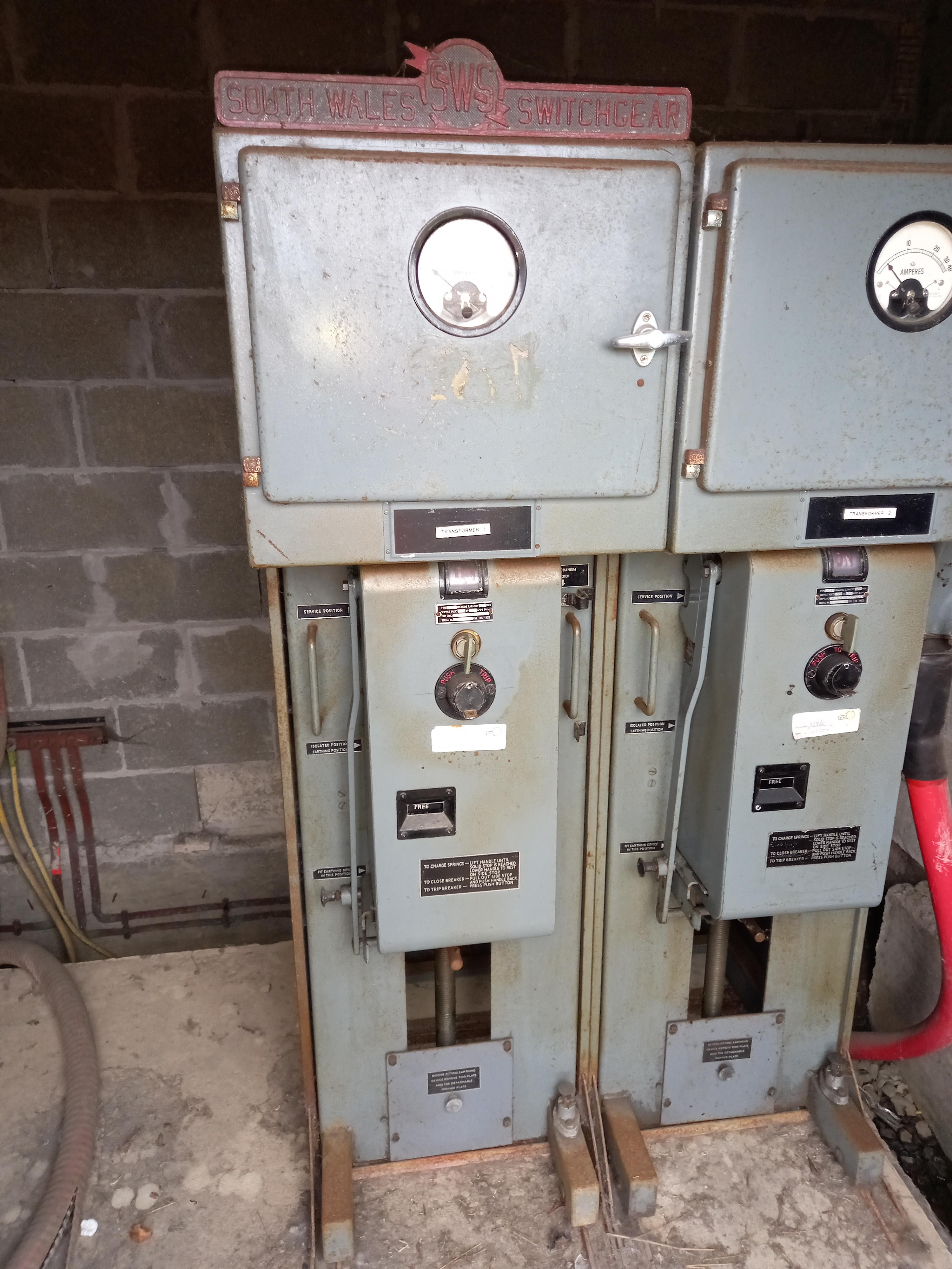

Carrerahill Posted March 16, 2022 Posted March 16, 2022 We all like photos, I took this photo yesterday doing a site survey. These are 2 11kV 400A breakers which protect two transformers. Note the 11kV cable coming in on the right, dropping out the back at low level and going into the trench are the 2 outgoing 11kV cables going to 2 transformers. This is actually client owned as the point of connection from SPEN is 11kV - behind this wall is a 11kV ring main tap using a MEM ringmaster unit - basically a 11kV cable in from the grid, and back out, then a single cable into these two boys. You will note on the right hand breaker the load is shown as about 4.5 (x10 multiplier) - that is 45A at 11kV! Pretty serious! This is what protects a 5 industrial units and 15 little modular offices. 1
