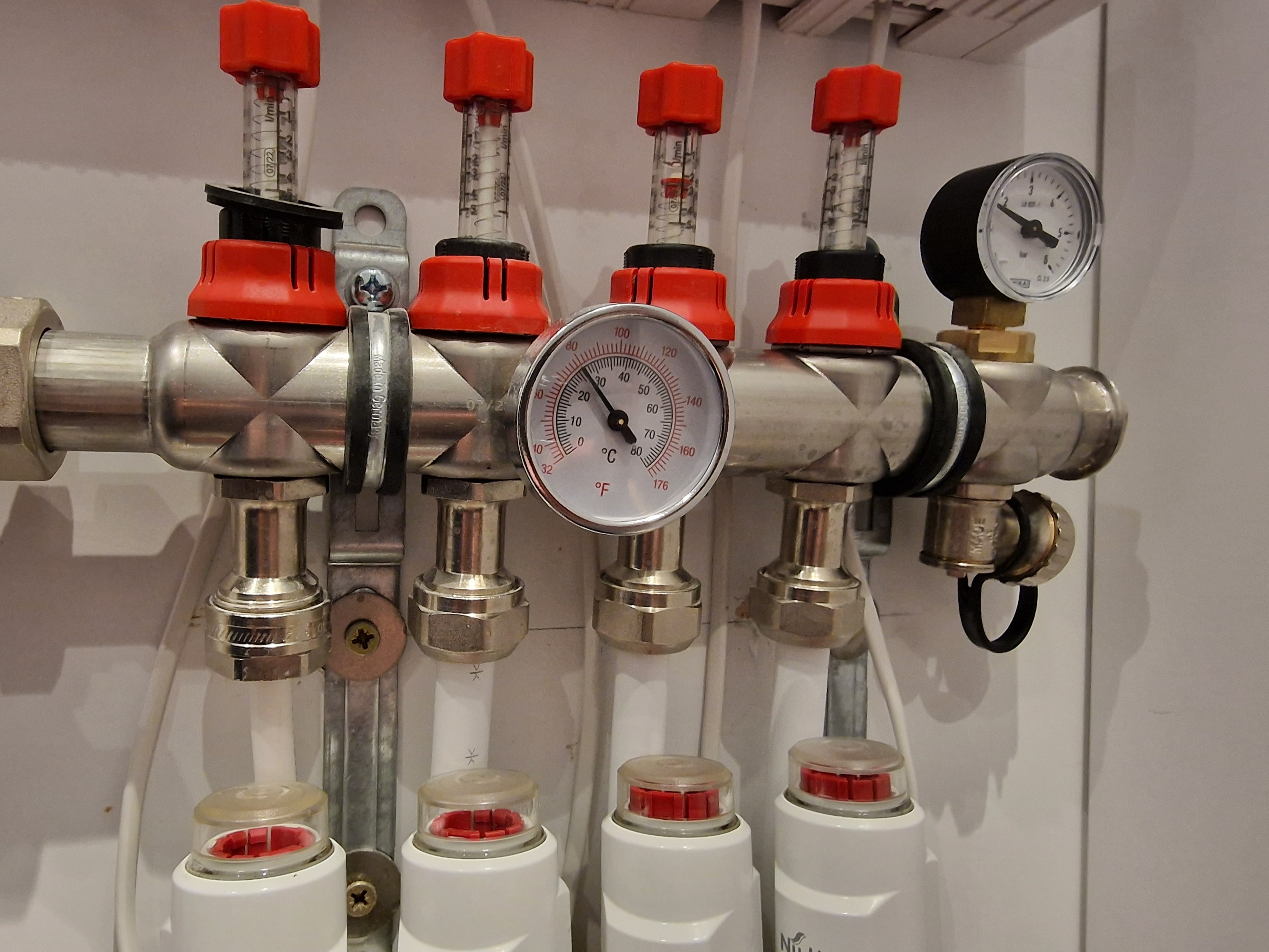

  1. Thanks it has never worked. I thought it was an air lock and tried to vent it myself but the hose got to bar pressure 3 and then popped off. Couldn't imagine an air lock could cause that sort of pressure issue but perhaps it could? Sounds love it is a plumber job, will just have to wait until after Xmas!
  2. Hi, A bit if a novice at this but trying to work it out. We've been in our self build a couple of months now and heating has gone on, but one of the zones doesn't seem to be heating at all. The thermostat calls for heat and actuator pops up to open for water to flow, but there is no flow at all showing in the flow meter - it simply doesn't move. I've got a nu heat UFH system and gave them a call they suggested it might be a fault with the flow meter and to screw the flow meter out and swap it with another that I know works, but I simply can't screw it out, it just screws out a bit and never seems to actually pop out. I'm a bit out of my depth to be honest but can't seem to get a plumber to look at it before Christmas! Any thoughts greatly appreciated
