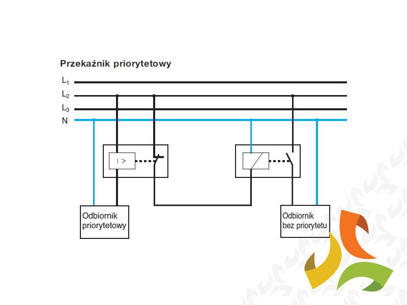

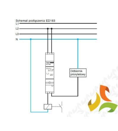

Onoff Posted March 15, 2022 Posted March 15, 2022 On 15/03/2022 at 20:03, ProDave said: I assume with the low current rating, it is used with a current transformer. And the NC contact would hold a contactor energised (wasteful) that would be released and turn off a big load if the max current was exceeded. Expand Also called an intensity relay that: The priority relay is designed to prevent overloading of the building's installation due to the simultaneous activation of many large power consumers (e.g. a flow heater).The coil of the ED183 priority relay is connected in series to the receiver with priority.When this receiver is switched on, an output contact opens and the switch on the receiver switches off without priority. Bioenergy switch: • automatic disconnection of the supply voltage (phase cable) from the receiver or group of receivers, in the case of detection of no load, • automatic operation - disconnection of the power supply for 3 seconds when detecting no load or switching off the receiver, monitoring of the state of the powered circuit and re-application of the supply voltage after detecting that the receiver is turned on (electricity consumption) • manual operation (switching by means of a switch) - the voltage is supplied to the receiver continuously, without monitoring the load condition, • parameters of the output relay: 1NO 16 A 250 V AC AC1, • voltage monitoring the state of the receiving circuit: 15 V DC. also suitable for electronic flow heaters Output: 1 NC contact, 250 V / 1 A AC-1 rated current range: up to 39 A Relay operating current: 3.1?And?5.7 A flow heater: up to 27 kW
SteamyTea Posted March 15, 2022 Posted March 15, 2022 On 15/03/2022 at 20:45, Onoff said: relay is connected in series to the receiver with priority Expand Does that mean there is some other kit that goes with it?
Onoff Posted March 15, 2022 Posted March 15, 2022 (edited) On 15/03/2022 at 20:52, SteamyTea said: Does that mean there is some other kit that goes with it? Expand Best I can find at the mo. Relay on the left translates as "receiver priority" on the right "no priority". I'll try and find it in English Edited March 15, 2022 by Onoff
