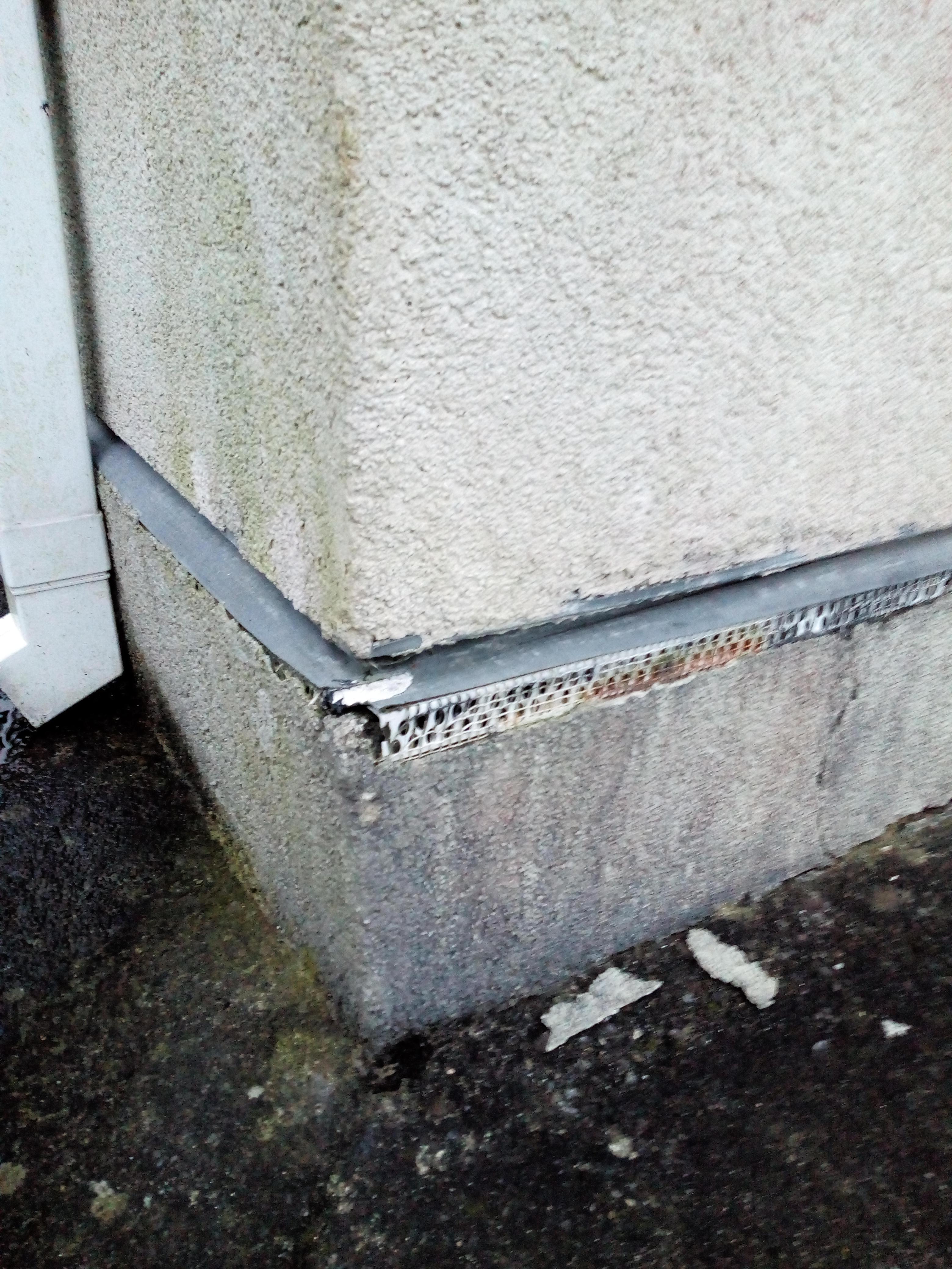

Naoma Posted March 14, 2022 Share Posted March 14, 2022 We recently bought a small timber frame bungalow, which requires some repairs to the exterior render, as there is damaged to the section where the plinth meets the wall, I have attached pictures of the area. Unfortunately, so far we could not find anyone, who could offer use an explanation or solution to the problem. As seen on the picture attached the grey tape (which seems to be some sort of flashing tape) is broken and coming off on several areas around the house, exposing the metal edge guards and allowing cold and moisture into the walls, as on the interior the skirting boards are cold and when furniture are places directly on the wall causing condensation and mould. ( as a short term solution, We have now left a minimum of 10 cm between the furniture and the walls, which seem to solve the problem of sweating skirting boards and mould). Q1: Does anyone recognise what this exterior gab between the plinth and the wall is for?! is it just decorative or does it serve any purpose, like breathing of frame or expansion gab? Q2: can this gab be closed and the house completely covered with an additional layer of acrylic render? Q3: if the gab needs to be kept, how can we repair the damage? Any help and advice is greatly appreciated! PS: As far as we can tell the house is built up of the following layers, starting on the inside: plasterboard, yellow insulation wool, OSB board, insulation board, acrylic render with embedded mesh and sits on a concrete foundation. Link to comment Share on other sites More sharing options...

Naoma Posted March 15, 2022 Author Share Posted March 15, 2022 Here are the pictures, sorry for the delay Link to comment Share on other sites More sharing options...
Naoma Posted March 15, 2022 Author Share Posted March 15, 2022 Link to comment Share on other sites More sharing options...
markc Posted March 15, 2022 Share Posted March 15, 2022 Shabby! what level is the ‘gap’ compared to the inside floor level? the tape isn’t the problem here, it’s water getting inside through the perforated corner bead. Plus whatever is getting blown or pulled into the gap and then behind the upper render. I think this really needs to come off from just above the joint line downwards and re applied. can you see what is behind, especially the lower section? Link to comment Share on other sites More sharing options...
ProDave Posted March 15, 2022 Share Posted March 15, 2022 The upper part, the render, looks okay, terminated with a bell cast bead. It's the lower part that is just wrong, I have never seen it done like that. If it's done properly, the upper render will terminate at the same level as the damp proof course. the lower part is then usually rendered with smooth render. No beads needed, it goes right up to the underside of the bell cast and is a thinner coat so it does not stuck out as far. So I would be wanting that whole bottom section removed and re done properly without that silly gap. You can see from rainwater downpipe, that this bottom render sticks out further than the bellcast of the main render which is totally wrong. Link to comment Share on other sites More sharing options...

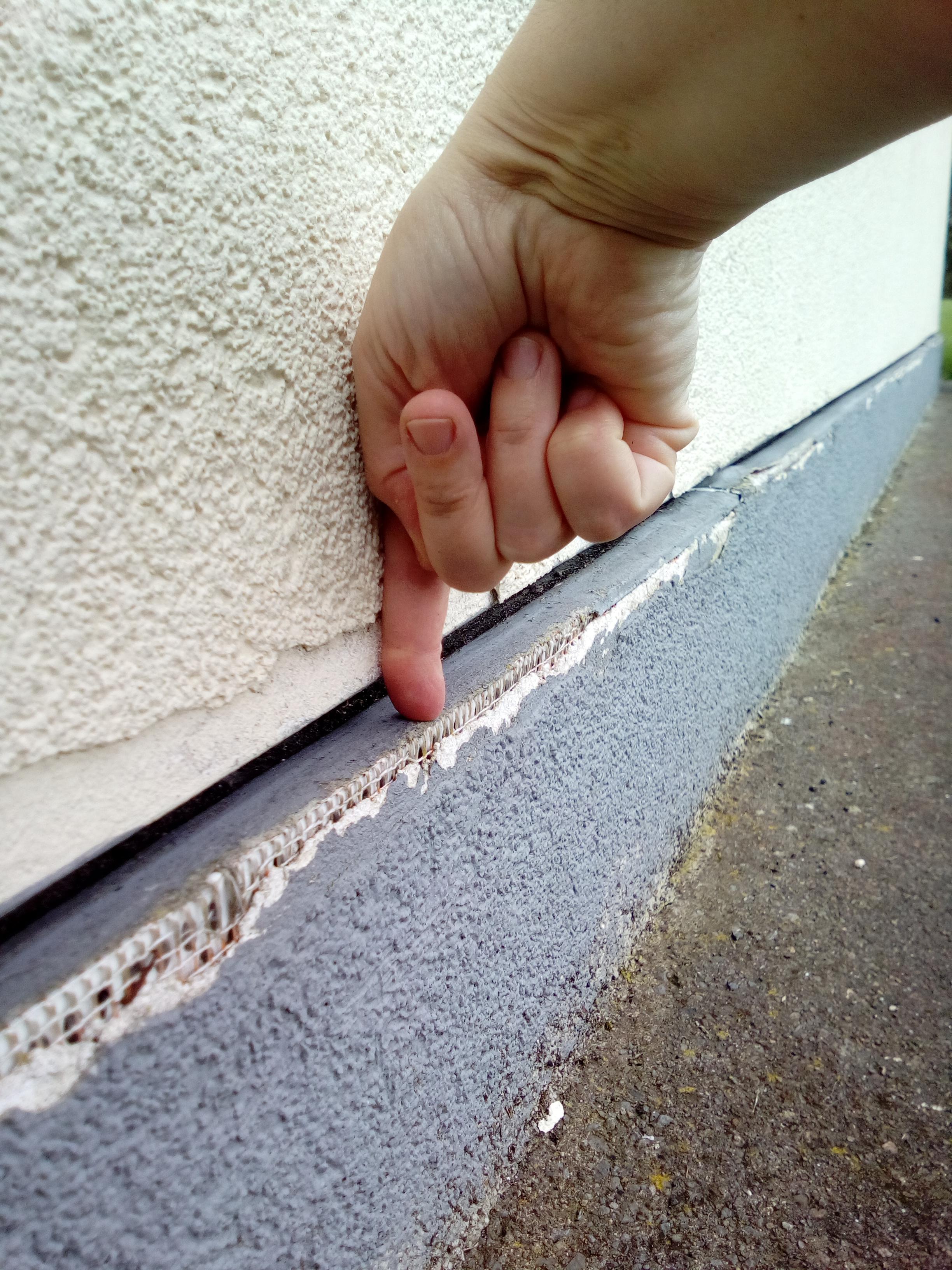

Naoma Posted March 16, 2022 Author Share Posted March 16, 2022 14 hours ago, Iceverge said: Hi Naoma, Welcome to the forum. Sorry to hear of your problem. It looks unfortunatly typical of celtic tiger lack of care and attention. However you are in the right place to get help. Do you have any pictures of the interior skirting board, both where the render is damaged outside and where it isn't? Can you privide a wider picture of the plinth detail too please? Did an engineer survey the property an provide any guarentee for you? Here are some more pictures, also showing how much the grey area stands out. Link to comment Share on other sites More sharing options...
Naoma Posted March 16, 2022 Author Share Posted March 16, 2022 There is no damage visible on the interior skirting boards, they just get wet when furniture are too close and eventually get mouldy, which so far we were able to clean off. Hope the above picture from outside is useful Link to comment Share on other sites More sharing options...

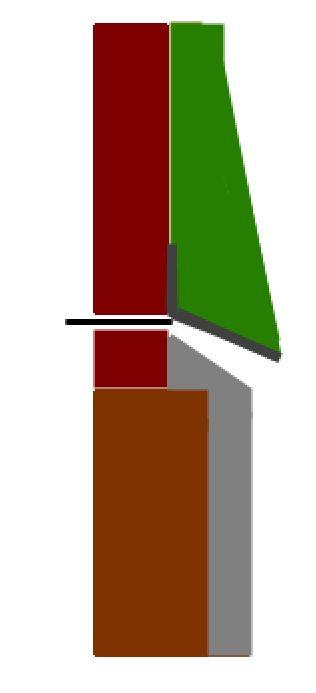

Temp Posted March 16, 2022 Share Posted March 16, 2022 I think the bell cast above the gap should have been much wider and the top of the grey plinth sloped down and out. Something like this.. Perhaps this wasn't possible for some reason. Can you tell if the DPC is at the top or bottom of the gap? Link to comment Share on other sites More sharing options...

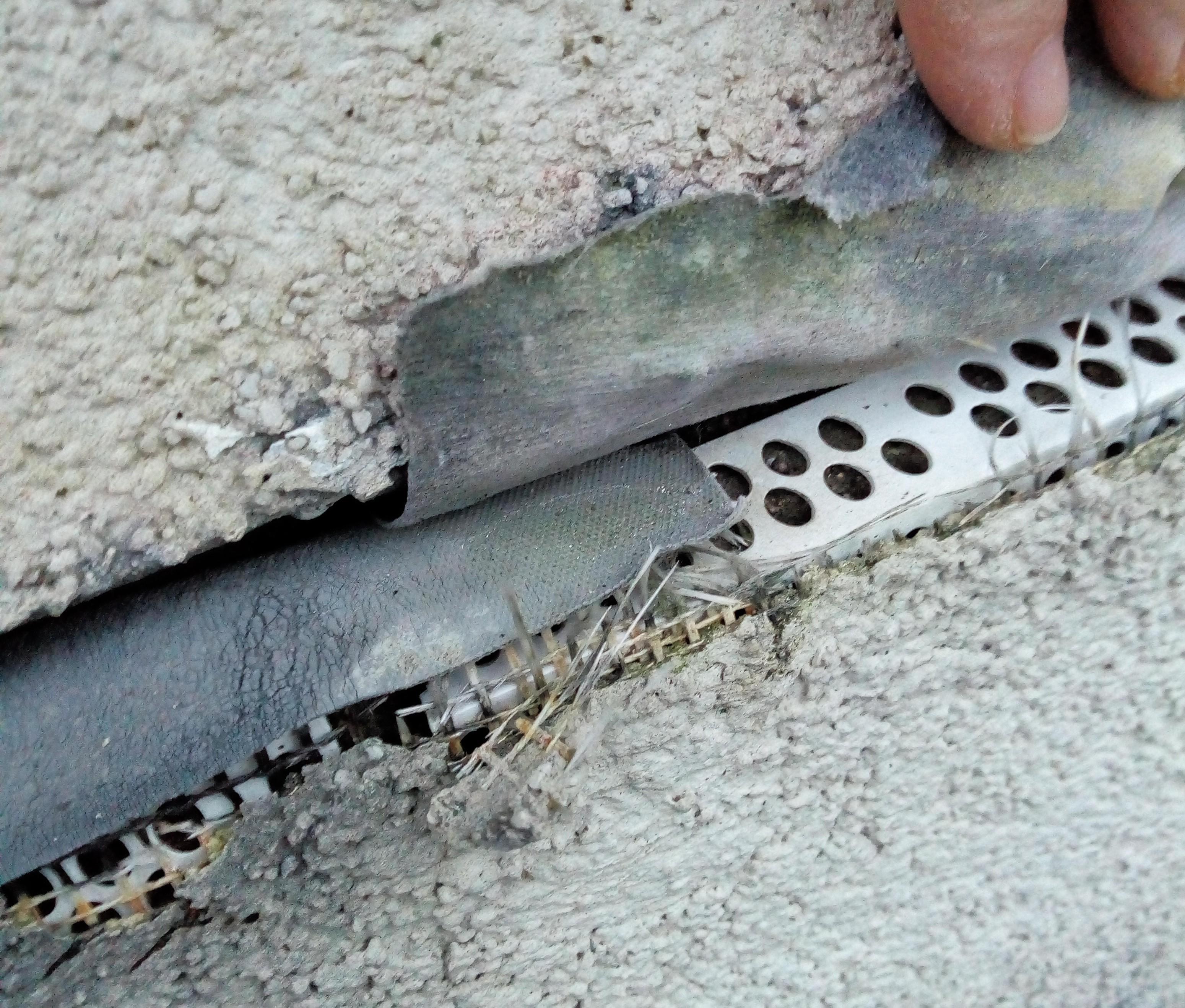

Naoma Posted March 16, 2022 Author Share Posted March 16, 2022 3 hours ago, Temp said: I think the bell cast above the gap should have been much wider and the top of the grey plinth sloped down and out. Something like this.. Perhaps this wasn't possible for some reason. Can you tell if the DPC is at the top or bottom of the gap? I would say on the top, I will try to get some pictures from the area where the grey tape peels back the most, to give you as much info as I can Link to comment Share on other sites More sharing options...

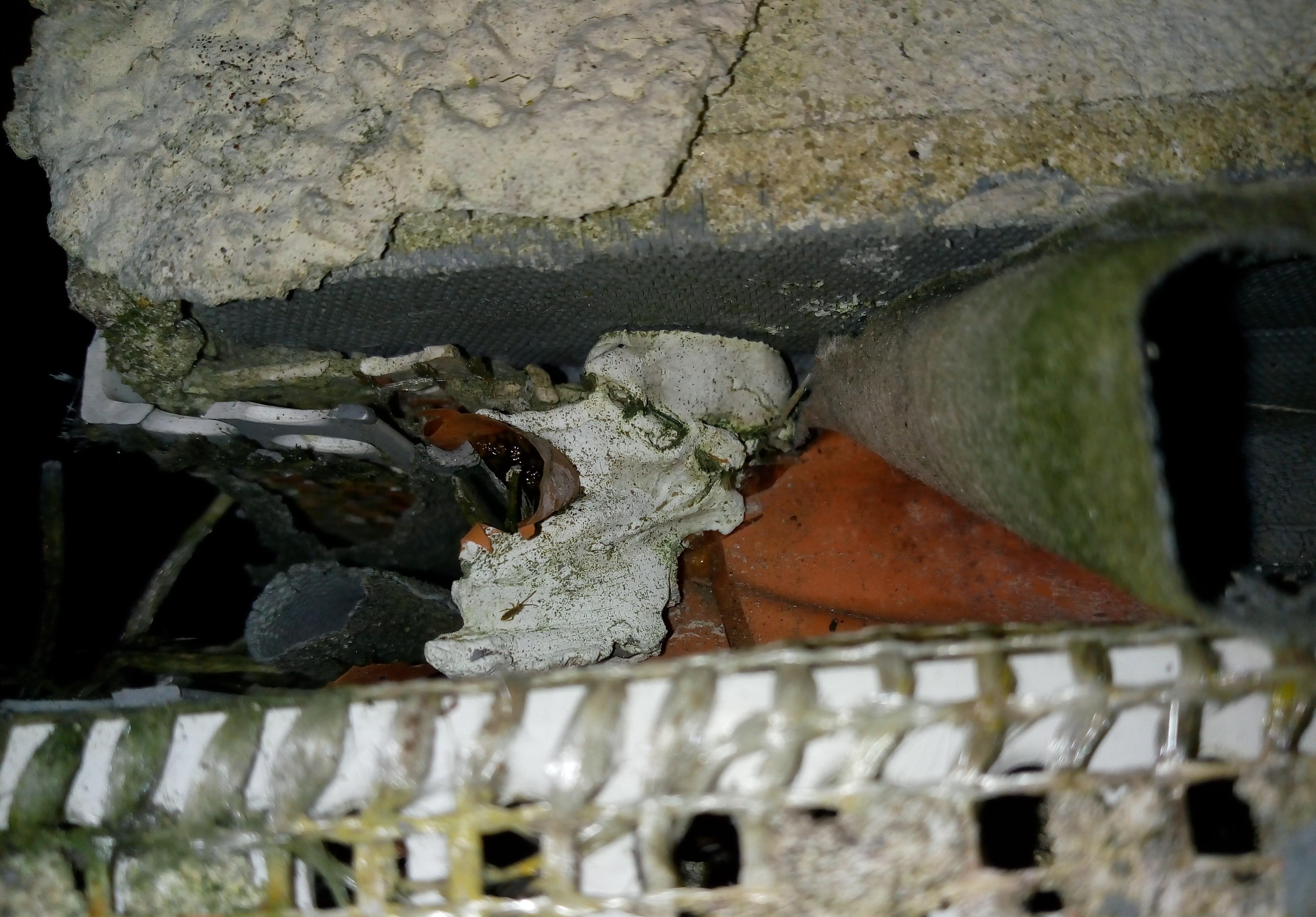

Naoma Posted March 16, 2022 Author Share Posted March 16, 2022 This is the close up off the section with the grey tape pulled back Link to comment Share on other sites More sharing options...

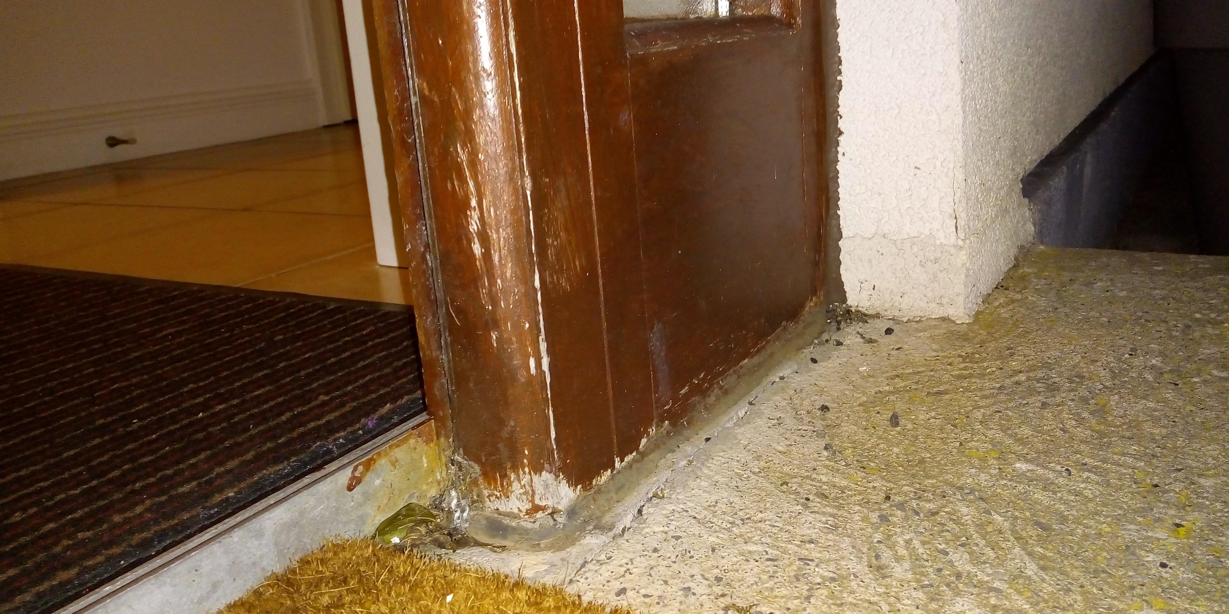

Naoma Posted March 16, 2022 Author Share Posted March 16, 2022 This a picture of our front door, showing the floor level on the inside in relation to the gap on the outside, I hope this useful (sorry had to take the last two pic in the evening) Link to comment Share on other sites More sharing options...
