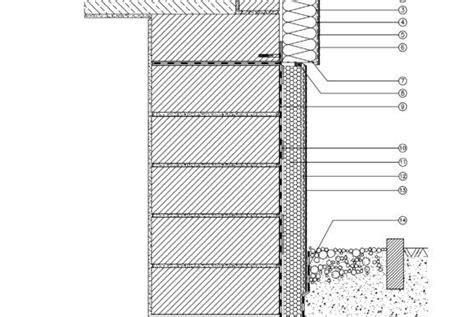

18 hours ago, Naoma said:
How would the correct detailing look like, so that water would always drain away properly?
Note the overhang of the top part over the bottom part and the layer of insulation outside the foundation rising walls. Most installers will try to fob you off and terminate the external wall insulation 150mm above the ground. It is very important in your case to keep the bottom of the timber frame warm to prevent condensation.
Iceverge, again thank you so much for your explanation.
As on the pictures, we have around most of the house a concrete path, would we need to break it to get the insulation below the ground or would it be sufficient to let it go down flush with the path?
It would help but ultimatly not be the best solution. EWI suppliers will tell you it'll be fine but thats because of the generally terrible understanding of how thermal bridging works, and they don't want the hassle of digging and replacing footpaths etc. Have a look at the below post to see the difference with and without taking insulation down to the foundations.
You're better off tackling this once and properly, treat it as not only remedial actions but a comprehensive thermal upgrade. Remember if it's left your house will gradually rot away and if done well you will have a much warmer and really cheap to run house.
The wide soffit is good news. you should be able to do another layer of ewi without going near the roof.
Assuming the wall structure is ok inside I would proceed as follows.
1. Dig out the footpaths.
2. remove the soffit
3.Apply another layer of EPS EWI outside the current one, the thicker the better .
( you may need to remove the current layer, you may not)
Take it from as high up behind the soffit as possible to ensure it meets the roof insulation right down to the foundations. It may be 300-900mm below the floor level. This will have the benefit of defacto insulating your floor too.
4. Move the windows and doors out into the insulation layer if they're not there already.
5. make sure the insulation goes around all sides of the doors too including below You currently have some bad thermal bridging here.
6. Render the New EWI, replace the soffit.
7. Install a comprehensive french drain and gravel boundary around the house.
