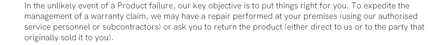

TW9 Posted March 11, 2022 Posted March 11, 2022 What does the warranty say? I think it's on their website.
Nickfromwales Posted March 11, 2022 Posted March 11, 2022 2 hours ago, TW9 said: What does the warranty say? I think it's on their website. A veritable jungle, very much in need of a total and in-depth read, re-read, and digestion. Regardless of fault, ( eg if the fault cannot be resolved by a call-out engineer ), the owner is responsible for the removal of ( DE-COMMISSION OF ALL PLUMBING AND ELECTRICAL CONNECTIONS AND REMOVAL FROM THE RESIDENCE ), and the costs of transportation ( palletised ) to / from SA, and the re-installation of the unit. If this is your only source of DHW, then you will have a home which is inhabitable for that duration. "or ask you to return the product"....Deliciously shy on detail in that instance........ If you purchase outside of an approved installer, you will be subject to the terms and definitions, as set out by SA, and would likely be quoted "a non-standard installation" when refused your claim. For context, I went out to a property with a Telford UVC, some 5 years after its installation. It had failed and the owner asked me to come and replace it. I petitioned Telford and they DELIVERED FOC a replacement unit the following day, delivered by a courier they paid for, with the only condition given that they wanted the same delivery driver to be able to collect the failed unit at that same time. For further context, in 15+ years of being heavily involved in the heating and hot water industry, encompassing the installation and service of both unvented hot water cylinders and Sunamp units, I've only been back to the 2 aforementioned UVC's where the manufacturer paid up for one. Sadly, the number of failed SA units I was asked to attend to ( by both SA and the clients they refused to service ) is 'substantially' more. The message here is about the correct design and informed implementation of whatever your chosen DHW device is to be.
ProDave Posted March 11, 2022 Posted March 11, 2022 3 minutes ago, Nickfromwales said: A veritable jungle, very much in need of a total and in-depth read, re-read, and digestion. Regardless of fault, ( eg if the fault cannot be resolved by a call-out engineer ), the owner is responsible for the removal of ( DE-COMMISSION OF ALL PLUMBING AND ELECTRICAL CONNECTIONS AND FEMOVAL FROM THE RESODENCE ), and the costs of transportation ( palletised ) to / from SA, and the re-installation, of the unit. If this is your only source of DHW, then you will have a home which is inhabitable for that duration. "or ask you to return the product"....Deliciously shy on detail in that instance........ I had that nonsense with my first dead ASHP where they wanted me to return it for repair. Until I found the parent company and involved their CEO. 1
ProDave Posted March 11, 2022 Posted March 11, 2022 7 minutes ago, Nickfromwales said: For further context, in 15+ years of being heavily involved in the heating and hot water industry, encompassing the installation and service of both unvented hot water cylinders and Sunamp units, I've only been back to the 2 aforementioned UVC's where the manufacturer paid up for one. Sadly, the number of failed SA units I was asked to attend to ( by both SA and the clients they refused to service ) is 'substantially' more. The message here is an UVC does not have much to go wrong with it, and anything that can go wrong is easily repaired. But a Sun amp has some complicated controls, and it appears from other threads, a heating element that cannot be replaced easily if it fails. I think you have to have a very good specific reason to choose a Sun Amp, e.g you really need it's lower standing heat loss or you really need the more compact unit compared to an UVC. If you don't need either of those features I would choose an UVC personally. 1
