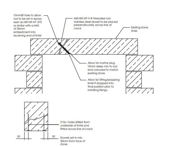

To expand the same subject, we have 2 ashlar concrete lintels which have cracks. they are in line with the outer skin of masonry only, with the remainder supported by very hefty oak lintels. My proposal was to jack the stone up the 1mm or so it has displaced, then drill through the oak into the granite and bolt them together (no rubble).  The Engineer's proposal is to drill up through the crack and bolt it back together.
Again I am reluctant but not so much so.....if it works.
We have found a good mason, so he might have experience or views...he hasn't seen this......but there are more of you and  with a variety of experience.
Any thoughts?
