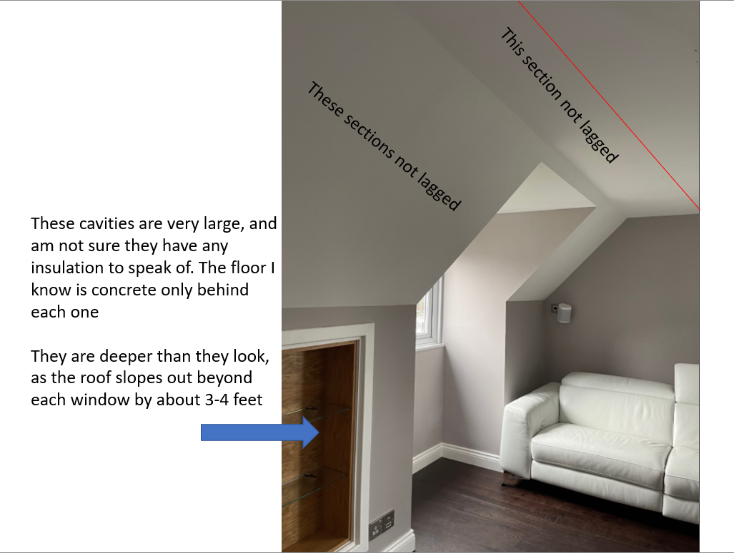

HI Everyone, I have a large 3 bed 2nd floor flat which cannot have gas. I had it refurbished 3 years ago. I took the decision rightly or wrongly to install water piped underfloor heating with a 14.4Kw electric boiler. Sadly I did not project manage the job and the builders were not good at all. They never checked the floor levels before they installed the underfloor heating, and ended up cheating in two of the largest rooms by pouring latex over the top of the heating to get rid of the undulations in the floor. They have since gone bust:-(
My issue is the heating is so expensive to run. I am facing an annual electric bill of £8000 or more now, and that is with the cheapest supplier I can find. So I am looking at all of my options to try and reduce the cost.
I know I can improve the insulation in the apartment, as there are a lot of cavities around the walls, as being top floor I have vaulted ceilings in every room. Whilst the loft is fully insulated, the purchase of a thermal imaging camera as shown that there are big areas around the sides of most rooms which could not be as easily accessed, and were left by my lovely builders. But insulation aside, I need to try and find a more energy efficient way to heat my home as this is killing me
I have considered a heat pump boiler, but I do not believe I would be allowed to install the outside unit here as being a block of flats, putting anything outside is a no go. I have spoken to a heat pump installer who has informed me that the unit cannot be installed in a loft, even if I created a well ventilated area, as it still will not be enough air circulation etc.
The boiler I have is slimJim (see link below), I am wondering whether there are other more efficient electric boilers out there, or are they pretty much the same? I am really struggling to think of any other options tbh, and wondered whether any of you guys who are much more knowledgeable might be able to help. I might freeze next winter if not!!!

The underfloor had a thin layer of insulation, and then the thick pads that the pipes clip in to. Its concrete floor. I cant hang anything on the outside walls as my lease does not allow it. Landlord very fussy:-( in this block we are all in the same boat really. The flat is very large. probably clos to 2000 sq ft or so.
I have suspicions that the dry lined walls have little or no insulation. I may be answering my own questions based on the current feedback so far here. But the attached image shows a corner of my lounge and the areas of concern for insulation

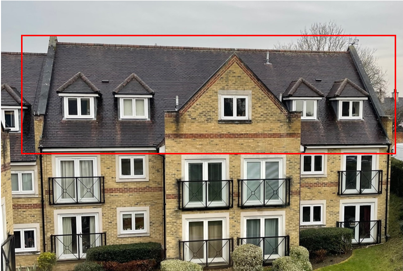

So this flat is basically the roof space of the block if it is all like that.

The concrete floor is less of an issue if it is just the divider between you and the heated flat below. In fact you should be effectively benefiting a little from their heating.
Your issue is clearly those large uninsulated ceiling and wall areas, all your heat is just disappearing as if you had your windows open. If you don't want to move then, as @ProDave says, it should be possible to strip out and insulate properly. It won't be cheap but to be honest, properly insulated I'd expect you to easily save between £4 and £6k per year on your bills.

Yes I cover the whole top floor. The flat is large which is both a blessing and a curse! The one across the way pictured is similar.
My thoughts regarding insulation so far are
I can access the big void areas, as pictured in my message above, so was thinking of getting these all insulated. I know they are not great as food smells come up inside them from the flats below. Plus the amount of cold you can feel when near them is telling.
As for the main walls, which are all dry lined. I was thinking of getting the natural grain type insulation, which is completely safe and fire retardant etc. Then making holes in the dry lining around each room and filling them.
Lastly, I have not been in the loft and surveyed properly yet, to see why the builder didnt take the insulation right to the ceiling edges, but am guessing access is blocked some how

I do own the leasehold of the flat, so insulating etc isnt an issue, but they will not allow anything bolted on the walls outside. I could sell and move, but I would not hide the massive heating issue from a potential buyer, so it would probably devalue the property to some degree

This was my thoughts yes. I can access from the inside by making holes in the dry lined walls, and the cavities can be access quite easily. This is the stuff I was thinking of. Ignore the price though, you can buy a lot cheaper elsewhere

That will be a cold roof so you have to leave some space for ventilating the outer surface particularly on the sloping bits.  Attention to detail when doing this is what makes it good or bad.
I would certainly make a loft hatch up into the roof space if there is not one already and have a look at what is there.  You might be able to look down into the sloping areas to see what is in there and how thick the rafters are,
The floor level eaves spaces should be made accessible with a trap door if not already and you can see what you can do there to improve things.  Detail is everything.
Looks like those wooden shelving inserts might give easy access if screwed into place.
there are a few of them, but many do not have easy access sadly. So will be a case of opening them up and then having them repaired and plastered after.

I would take one of those shelving units out and I think you’ll be surprised as you will be able to get all the way along in the eaves I expect. First job, get PIR cut and fitted into the vertical wall panels from behind, and then work back and just roll back cheap loft insulation on the floor behind those walls and then leave it.
The attic space, get up there and get 400mm of insulation up there, and then seal it and leave it. Not sure how old they are but I’m surprised that there isn’t min 250mm up there already.
That will leave the skeilings which are a pain to do without stripping back but they are a small area so this should start to improve things.
