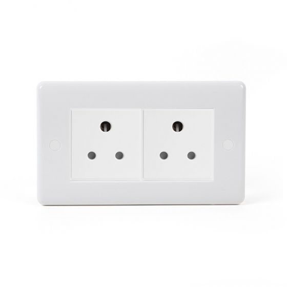

ToughButterCup Posted February 24, 2022 Share Posted February 24, 2022 I'll put in a double socket for our 5 amp circuit I thought... way back when ... Now I know. You can't get a double 5 Amp socket like a 'normal' one. Oh dear never mind what a shame. Can't take a joke? Etc. Single 5 Amp feed to a double socket..... Got a double (that is 2 singles placed side by side) socket and a double socket back box. What to do? Wire in a normal socket and label it 5 Amps only ? Wire in one of the two five amp sockets. Blank the second socket? Can't find a socket cover for 5 amp socket. Ask the BH Hive Mind what to do? That's the one. Please. Fanx Link to comment Share on other sites More sharing options...
ProDave Posted February 24, 2022 Share Posted February 24, 2022 Two single 5A sockets side by side is fine. They are the same size face plate as any other socket or switch so no problem finding a blank plate. Or do you mean something else when you say "socket cover"? Link to comment Share on other sites More sharing options...

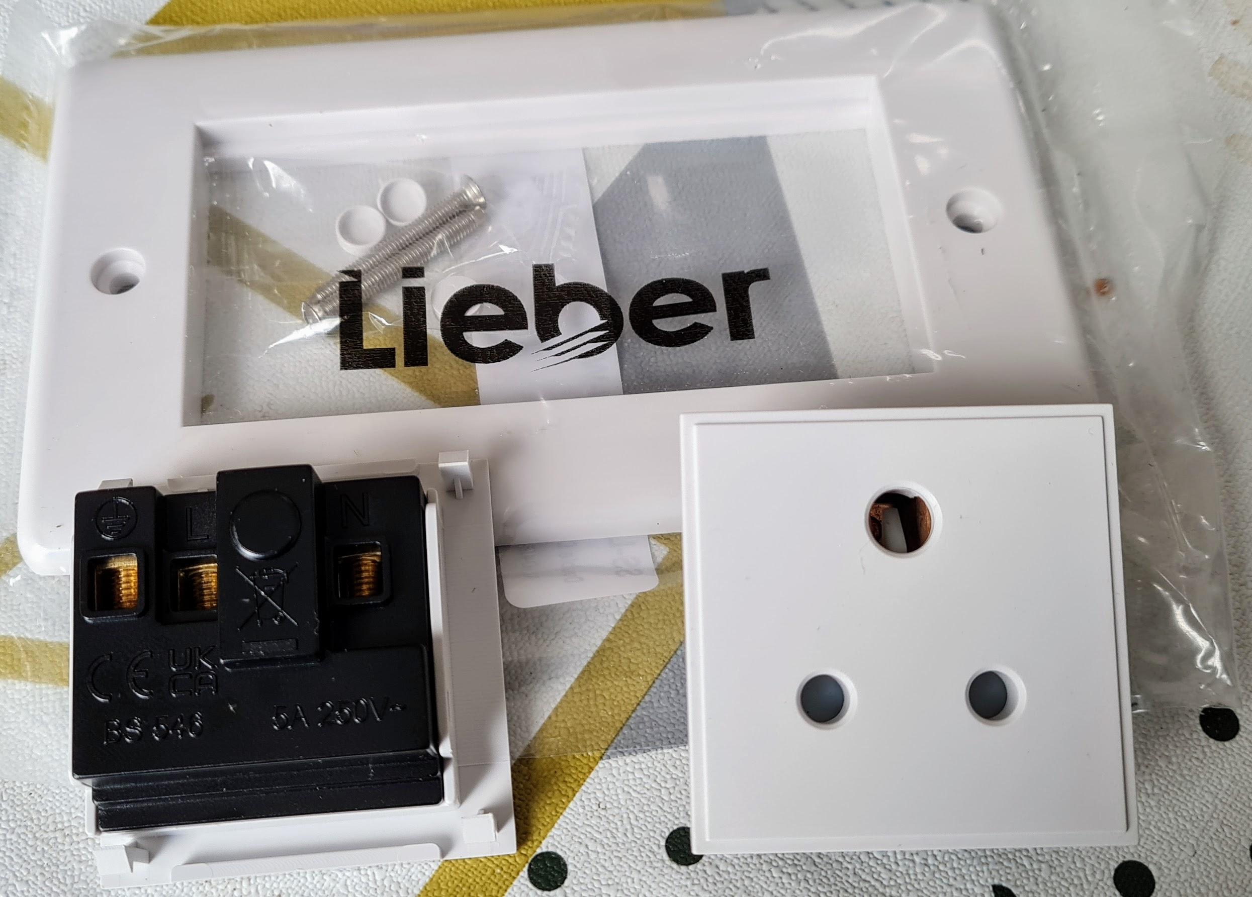

ToughButterCup Posted February 24, 2022 Author Share Posted February 24, 2022 (edited) Thanks Dave. I have only one feed. As I understand it, that feed is only OK for one socket. Is that correct? Or am I wronger than usual? In other words, I can't just loop across from one socket to the next can I ? Edited February 24, 2022 by ToughButterCup Link to comment Share on other sites More sharing options...
SuperPav Posted February 24, 2022 Share Posted February 24, 2022 Feed to switched/unswitched FCU with 5 amp fuse in it, then run whatever socket(s) you want from it (ideally label 5amp on it) 1 Link to comment Share on other sites More sharing options...

ProDave Posted February 24, 2022 Share Posted February 24, 2022 8 minutes ago, ToughButterCup said: Thanks very much. The entire 5 Amp circuit is already on an RCBO ..... ?, however I'll put a Fused Connection Unit (FCU ) in somewhere. You can feed as many 5A sockets as you want from one 6A MCB, that is called a radial circuit. What you are thinking of is a 32A ring final where a spur from that can only feed one socket unless fused to a lower rating e.g. with an FCU 2 Link to comment Share on other sites More sharing options...
ToughButterCup Posted February 24, 2022 Author Share Posted February 24, 2022 1 minute ago, SteamyTea said: How irritating. Exactly so. Bought from a company in Kernow 'n all. So it's not all bad. But the socket is not built the same as 13Amp sockets with connectors already built in (hardwired) at the back of the unit. It has two separate connections, one for each socket. And, I might be wrong, but the IEEEEEEEEE (number of EEs correct?) regulations say I mustn't loop across from one to the other. So I can either put a fused connection unit in (despite having circuit with a low rated RCBO) or have one blank plate next to one live socket Or maybe, as usual, I am missing the point you wished to make ..... Link to comment Share on other sites More sharing options...
TonyT Posted February 24, 2022 Share Posted February 24, 2022 It’s fine loop away! just think of them as single sockets not on the same face plate Link to comment Share on other sites More sharing options...

ProDave Posted February 24, 2022 Share Posted February 24, 2022 17 minutes ago, ToughButterCup said: But the socket is not built the same as 13Amp sockets with connectors already built in (hardwired) at the back of the unit. It has two separate connections, one for each socket. And, I might be wrong, but the IEEEEEEEEE (number of EEs correct?) regulations say I mustn't loop across from one to the other. So I can either put a fused connection unit in (despite having circuit with a low rated RCBO) or have one blank plate next to one live socket Se reply above the post I quoted. It is only ring final socket circuits that are a special case and can only have 1 spur. This is a perfectly normal radial circuit fused appropriately 1 Link to comment Share on other sites More sharing options...
