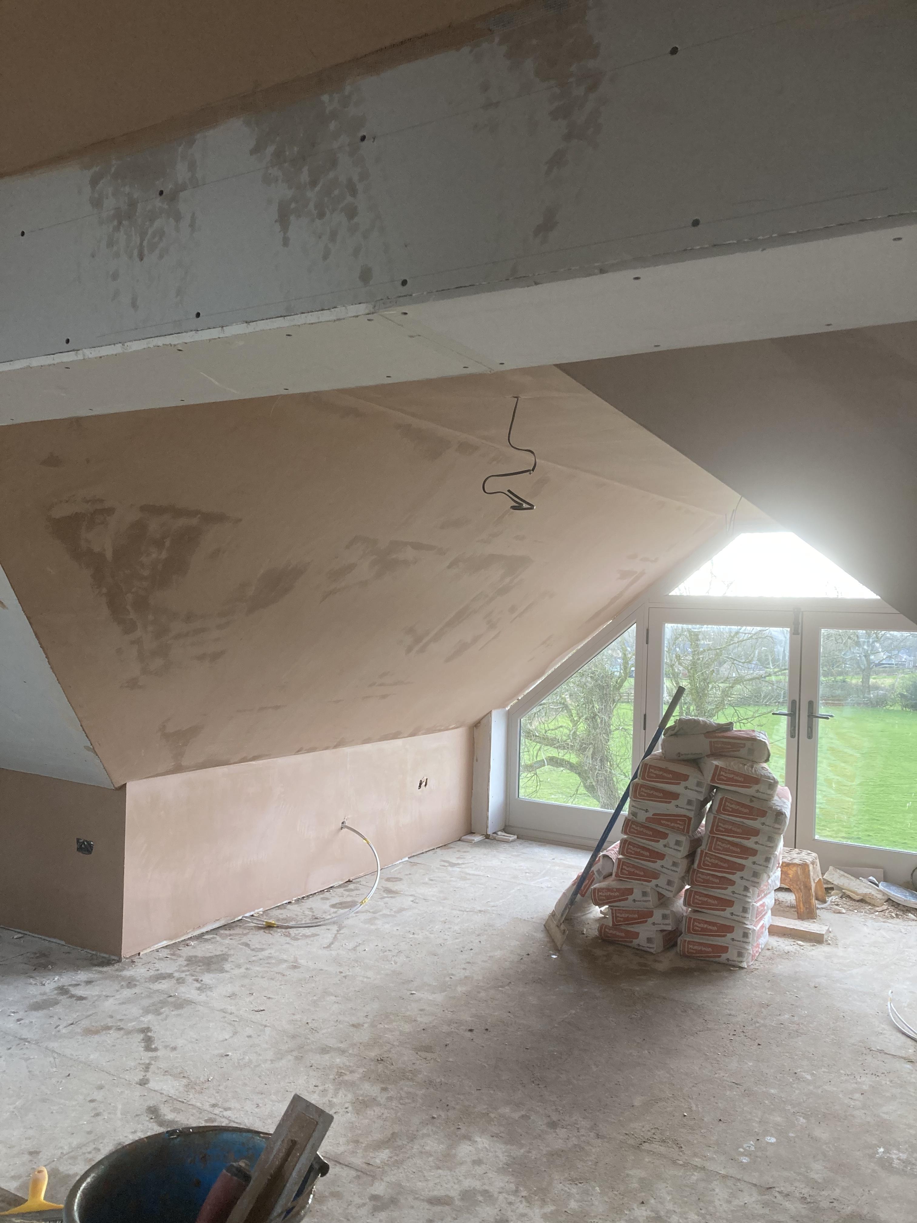

Kernow Posted February 23, 2022 Posted February 23, 2022 Hoping someone can help with a bit of advice as to whether we need a vapour barrier in our roof construction. Roof make up is raised tie trusses, 150mm pir between trusses, 60mm pir on the underside of trusses, taped to form a vapour barrier, then plasterboard. On the flat sections of ceilings we will have 350mm of Rockwool type loft insulation. My dilemma is do we require a vapour barrier fixed to the underside of the ceiling timbers, and taped to the pir on sloped ceilings, before we fixed plasterboard? Is standard green vapour barrier suitable? My thoughts are using this will help with air tightness and limit moisture travel upwards? Any opinions would be appreciated.

Radian Posted February 24, 2022 Posted February 24, 2022 13 hours ago, Kernow said: Roof make up is raised tie trusses, 150mm pir between trusses, 60mm pir on the underside of trusses, taped to form a vapour barrier, then plasterboard. I'm not sure my previous reply makes sense without further info: Does the 150mm pir stop at the raised tie level or go on all the way up to the ridge? From what you described the space above might even be ventilated.
Kernow Posted February 24, 2022 Author Posted February 24, 2022 16 minutes ago, Radian said: I'm not sure my previous reply makes sense without further info: Does the 150mm pir stop at the raised tie level or go on all the way up to the ridge? From what you described the space above might even be ventilated. Perhaps the attached photo makes more sense? pir between trusses stops just above ceiling height. Loft space to be unventilated 1
James94 Posted February 24, 2022 Posted February 24, 2022 This is exactly what we have done, but we have added a vcl to all ceiling areas with 50mm service cavity. we made sure we took the PIR on the sloping elevations far enough up into the loft to meet the top of the 500 mm loft roll, also maybe not necessary but felt better with it like this. Regards. James
