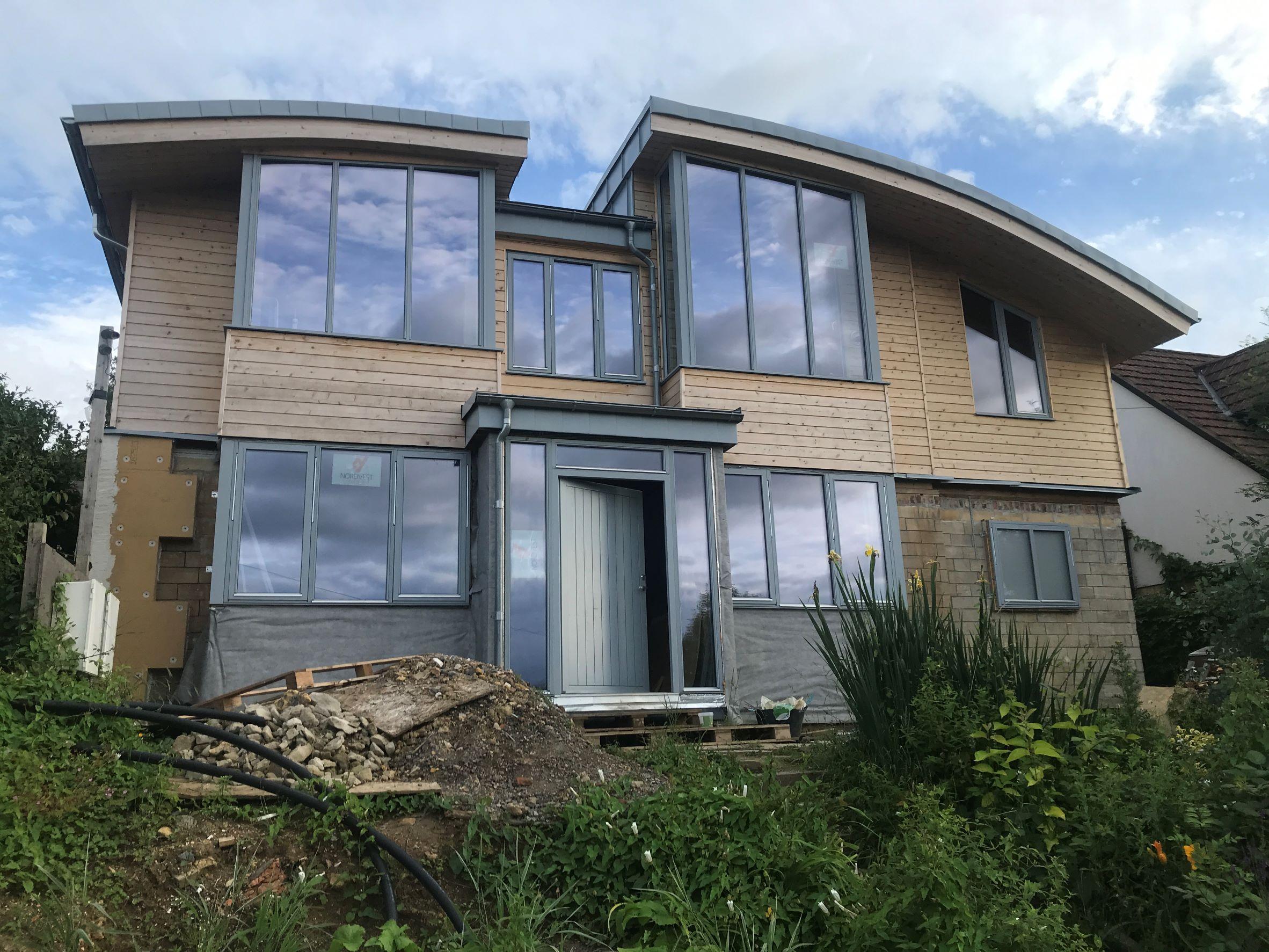

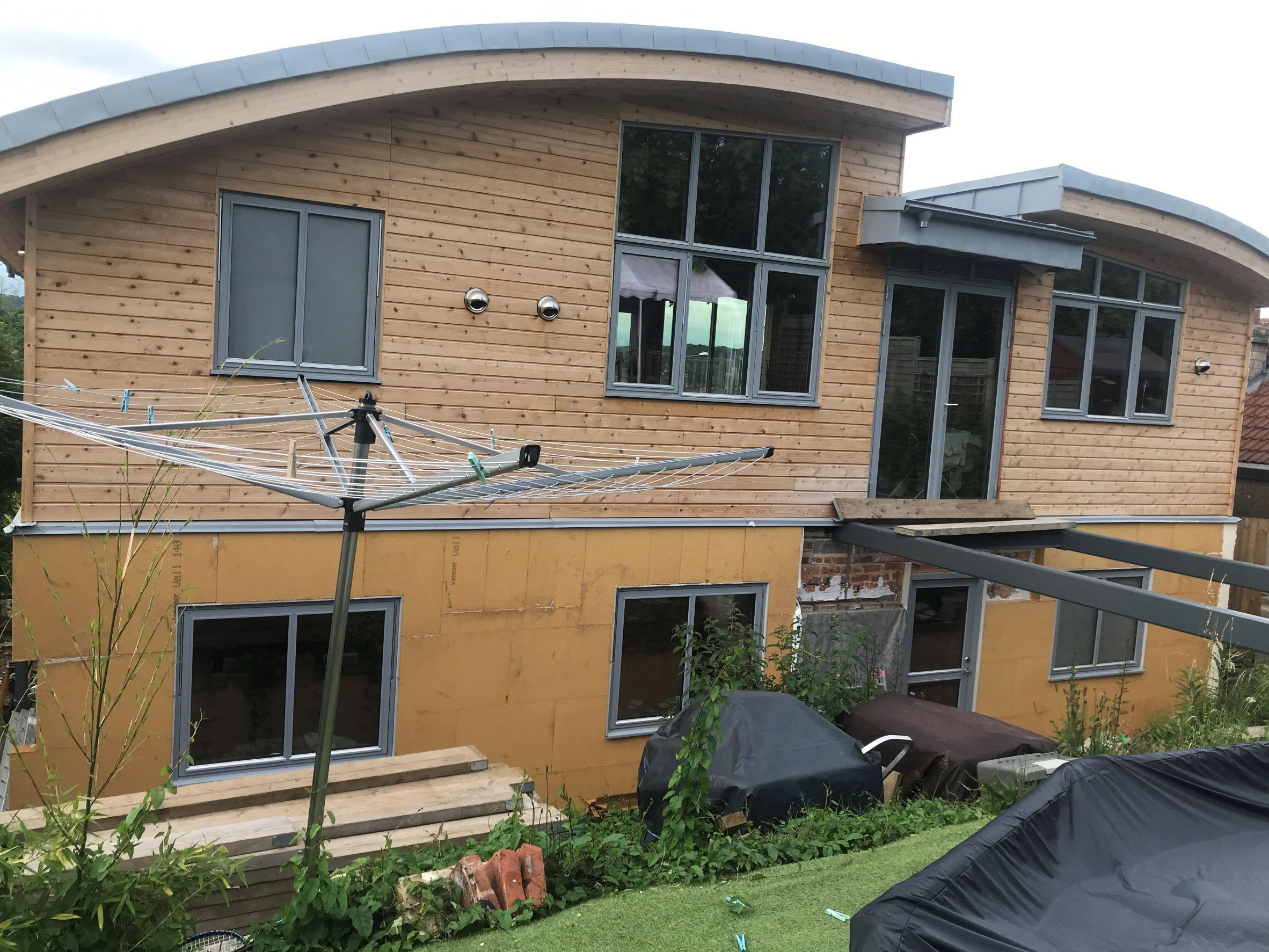

SimonD Posted February 13, 2022 Share Posted February 13, 2022 (edited) 5 hours ago, Nickfromwales said: How did they compare on price? Did you get ( like for like ) quotes from anywhere else? I got as close to like for like quotes as I could from the list of: Norrsken Nordan Rationel Green Building Store Jeldwen (priced direct with them rather than through a merchant) and a couple of others. ages ago I'd also got a quote from Velfac but this was for Aluminium windows the architect spec'd rather than timber we eventually went for. They were competitive price wise and rather than relying on a ridiculous negotiation process for the sake of it, just gave us a good price up front. About 7k or so less than GBS for 3g windows that had a whole window average u-value of 1.05 including the doors (We weren't looking for PH performance in ours so didn't spec this) . The Nordvest windows were slightly better on G-value (we've got lots of south facing windows shielded from summer sun with large overhang but wanted the winter gain - and can attest now that this works well). Rationel was the best quote on base price but Rationel couldn't do our 1st floor egress window as designed, nor could they do our front door IIRC, nor did they include the sills or transport in the quote. With Nordvest they quoted including timber sills, pretty much everyone else wanted extra for the sills of course, especially the aluminium ones. Nordvest also included transport in their quote so you basically knew everything was covered. What really made the difference with Nordvest is that they actually looked at the designs and window schedule and instead of just quoting for what was on there, they came back and suggested alternative arrangements for window openings etc. So, for example, they suggested tilt and turn windows at some places and fully reversible top swing in others etc. With the front door, I think only one other company could do our size and Nordvest said they only supply front doors with an Accoya external face and it was to be steel reinforced due to the size, which was reassuring. I also like their window profile which was 109mm deep x 56mm. This helped because with their frames I was able to bring them out further from the timber frame to cover the 50mm insulation installed externally and not have to use deep aluminium sills. I only needed 65mm timber sills rather than the 120 + mm aluminium ones. There are also some other neat additions to the design. For example, even on the timber only windows they include aluminium profile as cladding on the top of the bottom rail which clips on just above the bottom bead. As I understand it, this is one of the weaker areas of a timber window and this profile provides better protection. We ended up spending more with them as we decided to increase some sizes, like for the french doors and up the spec of a few bits and bobs but we still ended up paying marginally less less than Rationel would have been with sills and transport included. In total it was just over 20k plus VAT. Can share full schedule so you can see all the details if you'd like. Windows & doors not long after installation. Bays have fully glazed returns: Edited February 13, 2022 by SimonD 1 3 Link to comment Share on other sites More sharing options...

Chanmenie Posted February 14, 2022 Share Posted February 14, 2022 That looks a lot of windows and glass for £20k are they timber or Alu-clad timber Link to comment Share on other sites More sharing options...
SimonD Posted February 14, 2022 Share Posted February 14, 2022 28 minutes ago, Chanmenie said: are they timber or Alu-clad timber Timber but with the alu-cladding on the bottom rail. Link to comment Share on other sites More sharing options...
