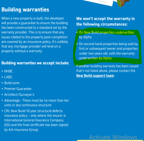

Dave Jones Posted February 6, 2022 Posted February 6, 2022 you will need a completion cert and warranty. 1

Dave Jones Posted February 6, 2022 Posted February 6, 2022 14 minutes ago, CalvinHobbes said: Hoping not to have to borrow for our build (maybe the credit union will get a touch on the finish) but just in case what warranty? Have a look at your lenders approved warranty provider list. bit late if you haven't got one in place as they need to inspect from the start. 1

CalvinHobbes Posted February 9, 2022 Posted February 9, 2022 file:///C:/Users/pc/Downloads/new-build-guide.pdf Who are this Alpha crowd?
Dave Jones Posted February 9, 2022 Posted February 9, 2022 good to see they accept CRL warranty. They are the ones that went bust leaving their policies worthless.
