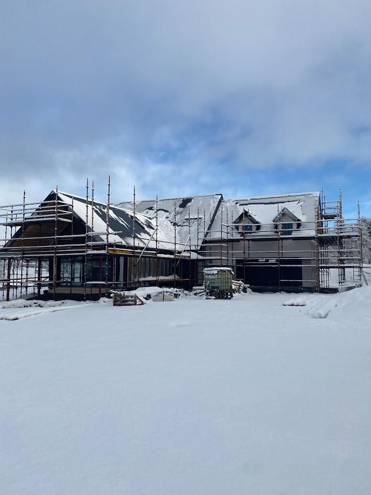

SuperJohnG Posted February 1, 2022 Share Posted February 1, 2022 I already know the answer to this question will likely be a resounding yes, even in my own head I think yes just get more for all the right reasons, it'll reduce the energy usage/ it's too hard to do later/ Later I'll wish I'd done it. But - I've not currently planned to do it. SIPS kit with 169mm wall thickness, with 219mm thick Roof section. We have an insulated slab for reference Current U Values: I have been considering adding 50mm PIR internally on the walls and roof, I'm nervous that we will get in and I'll regret not adding it. This is somewhat driven by when the snow came a few weeks back I took the picture below. You can see the snow still solid on the canopy section, but right behind it melted quite quickly above a section which is my open plan area. Now the internals haven't even started so it will improve from there but you can see the difference with the snow melting there. So i am at a conundrum right now, I shoudl move inside in around a month, I've been at it a year already costs are above budget significantly (nothing horrific that I can't eventually afford) so hadn't allowed the costs or more importantly the time but also thinking I shoudl just suck it up and do it. I shoudl maybe look at the U value increase for the adding 50mm PIR then assess from there, cost will be around £4.5k plus VAT for the PIR (500 sqm). Or do I just focus on doing the airtightness aspect as this will make a more significant difference? as I am already a t a decent level of insulation in the SIPS kit. Bear in mind - I currently live in a 1975 thermalite block house with on ceiling insulation (done badly) and it's as leaky as a sieve. Link to comment Share on other sites More sharing options...
Russell griffiths Posted February 1, 2022 Share Posted February 1, 2022 I would think looking at that pic, that you have a bad join at the ridge join, I would look if you have a solid timber up there, if so insulate that and get at it with airtight foam. Link to comment Share on other sites More sharing options...
MikeGrahamT21 Posted February 1, 2022 Share Posted February 1, 2022 (edited) Your u-values look good...if you've achieved them. Check for gaps, airtightness and thermal bridging. £4.5k is a lot to spend when you've so much insulation already. Also...did the other side of that roof melt in a similar manner? If not, it could just be the sun warming up the very dark tiles + a bit of heat leak, wouldn't take much to cause snow to slide on the smooth surface. Edited February 1, 2022 by MikeGrahamT21 Link to comment Share on other sites More sharing options...
SuperJohnG Posted February 1, 2022 Author Share Posted February 1, 2022 36 minutes ago, Russell griffiths said: I would think looking at that pic, that you have a bad join at the ridge join, I would look if you have a solid timber up there, if so insulate that and get at it with airtight foam. Unfortunately I have a steel ridge beam that bridges the apex in between the panels - not a very good design. But I have planned to cover it internally with 50mm (more if I can) PIR foam around the edges. Link to comment Share on other sites More sharing options...

SuperJohnG Posted February 1, 2022 Author Share Posted February 1, 2022 2 hours ago, MikeGrahamT21 said: Your u-values look good...if you've achieved them. Check for gaps, airtightness and thermal bridging. £4.5k is a lot to spend when you've so much insulation already. Also...did the other side of that roof melt in a similar manner? If not, it could just be the sun warming up the very dark tiles + a bit of heat leak, wouldn't take much to cause snow to slide on the smooth surface. We haven't done the internals yet so still do sort gaps, airtightness etc. I can't remember about the other side actually, but this was the side with the sun. The other side does stay very cold as it never sees the sun in winter. 15 minutes ago, BenP said: We've insulated over our timber frame with a complete layer of wood fibre and it is fantastically reassuring knowing there's very little in the way of cold bridging ? That is the bit I think I would like as it will remove all those cold bridges in the timber's in the roof panels and at points in the wall, albeit any joining ones are SIP splines in walls. Link to comment Share on other sites More sharing options...
