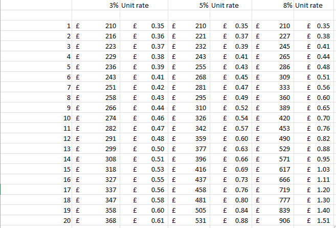

On 02/02/2022 at 10:14, Nickfromwales said:
Budget for midnight to midnight at 30p/kWh.
I redone these calcs (I'd actually made a mess of them before) for 17p/kWh and then redone for 30 and 35p too..
Results for over 20 years assuming a COP of 3 on the ASHP and usuing my 900m2 of wall and ceiling area. I've attached the excel for anyone who would like to figure this out in the future.

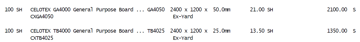

I had some pricing back for 25mm and 50mm PIR, this was for 100 sheets of each just for comparison, which would be around the area of my internal roof (300 sqm), so vs the figures above it would be 3 times the costs (as above is based on ceilings and walls at 900m2) so for 50mm to do above it would be £6300. At 3% starting at 35p/kWh over 20 years, the cost won't theoretically have been recovered. That is just on the basis of pure heat loss, doesn't factor in thermal bridging or airtightness which are seperate issues.
I still may do it but helps make an informed decision.
Now reading seems insulation is law of diminishing returns which I haven't quite figured out yet where the optimal balance of my existing insulation and adding extra becomes not value for money.

The price is compounded per yer, so starts at 35p now, and ends up at 61p (jesus (expletive deleted) can you imagine!) in 20 years, even worse at 8% that will be £1.51 per kWh
Yup. And all the current nay-sayers moaning about the lack of returns on the PV installs will all be crawling over broken glass to fit some then. Prob is, then the PV will have gone up too.
We've just quoted 9kWp at £11.6k ( before VAT ) with a breakeven point in year 6.5!! 80% performance warranty ( guaranteed ) for 25 years. Irrefutable sense, and PV is your best defence against rising electricity prices. Hoping to get time to do mine this year.......fingers crossed. Sun will keep rising, so will fuel costs.

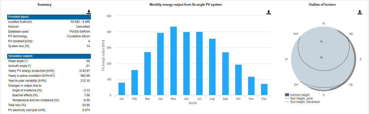

Absolutely makes sense to do. Interested in how you can get a realistic PV generation value- just use PVGIS? I'd like to do the sums on that just now.

edit- just did it:
seems like 3143 kWH per year just need a realistic utilisation figure now, doing some sums on 50% utilisation and 3% interest  starting at 30p/kWh now payback is around 10 years (assumed total install costs £5k for a fully installed system with me managing subcontractors).
Link to comment
Share on other sites
Yup. Plus a reasonable amount of diligence with a site survey before submitting figures.
Just about every single proposal we’ve ( collectively ) put forward for my projects have either met or exceeded expectations. It shows the software allows a bit of ‘real world’ accountancy.

The PVGIS ones? Thats good, so reasonably I can assume that say 75% would be generated and then its just a utilisation question.
Yes, that would be a healthy benchmark for sure. Also, the figures usually do not allow for maxed out self-consumption either, so the projected economics can be improved upon by something as simple as a PV diversion controller to DHW. Adding an EV charger of the same family / software base ( eg so they ‘talk’ to each other ) would allow pretty much 100% self-consumption, if the EV is routinely tethered during the hours of sunlight of course.
Cases change for retired / working full time / working from home etc so no 2 scenarios are really the same.

Going to likely add 50mm PIR to the ceilings internally which works out at 300m2. Cost of this is £2100 plus my labour time which is free. The simple economics of this don't really add up as even considering 33p/kWh, with a COP of 3 on the ASHP, the saving over 20 years is only £1700 and that's allowing for starting point of the 33p compounded out at 3% - however it will remove the thermal bridges in the ceiling which is my main focus there.
In stark contrast - given the same 33p/kWh and allowing for the same 20 years and compounded interest with a 4kWp array and getting 50% utilisation from that I would recoup £8k, from generating £14k worth of kWh minus a £6k outlay right now. Which is quite significant. If I up that utilisation to 75%, which shoudl be easily achievable with a PV diverter that £8k increases to £15k which is unreal.
