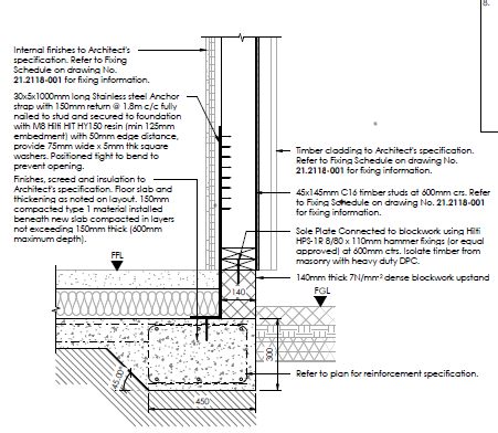

saveasteading Posted March 6, 2022 Share Posted March 6, 2022 I spot people with recent knowledge of foundations. Our Engineer has designed something I think is suitable for forklifts. Any of you with timber frame able to copy or describe what you did for footings and floor slab? ground bearing slab or raft? footings connected or separate? how much reinforcement? sub-base/concrete /insulation / screed or simply sub-base /insulation/ concrete? Steel straps to hold the building down? That sort of thing. Link to comment Share on other sites More sharing options...

saveasteading Posted March 6, 2022 Share Posted March 6, 2022 Sitting on polystyrene. Excellent. And it hasn't sunk into the ground or blown away yet? We have that sand as natural ground but the engineer wants us to dig it out and replace with type 1, then doubly reinforced slab, then insulation then screed. I might suggest that the extra cost comes off their bill, which will mean that they owe us. Link to comment Share on other sites More sharing options...

saveasteading Posted March 7, 2022 Share Posted March 7, 2022 When questioned on the heavy construction we (not me unfortunately) were told uplift, down force, thrust.....all of which exist but i think are overestimated here. We will be asking for the calcs, and i will get the red pen warmed up. Most glaringly is....remove 150mm of natural sand and replace with 150 type 1.....then put PIR on it before screed. Perhaps type 1 is the default and no further thought is given. I'd most like to see either a standard drawing of a kit timber building onto a conventional edge footing, or photos of same. Link to comment Share on other sites More sharing options...

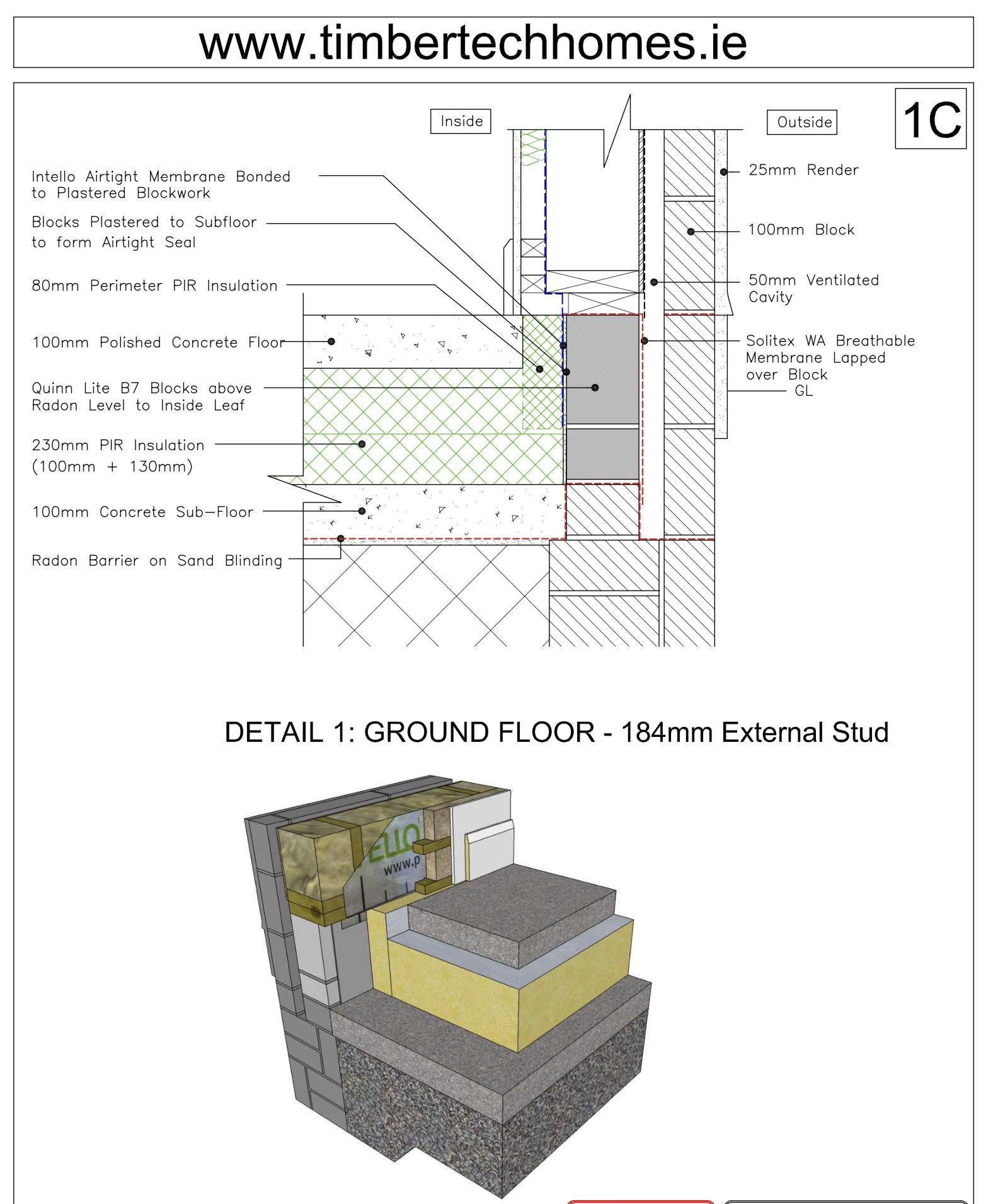

Iceverge Posted March 7, 2022 Share Posted March 7, 2022 Here's a nice one. 2 Link to comment Share on other sites More sharing options...

saveasteading Posted March 7, 2022 Share Posted March 7, 2022 10 minutes ago, Bitpipe said: This is not flimsy packaging polystyrene No, of course not, but it is not concrete either. Very impressive, and a benefit of the package process of joined-up thinking. 58 minutes ago, Iceverge said: Here's a nice one. What purpose do you think the bottom concrete has, other than tidyness? Link to comment Share on other sites More sharing options...

Nickfromwales Posted March 7, 2022 Share Posted March 7, 2022 12 minutes ago, saveasteading said: What purpose do you think the bottom concrete has, other than tidyness? It is a bridge over the possibly unstable ground in between the trenches. A raft over trenches in essence. It also gives a uniform level platform for the insulation to sit on too. Not necessarily a problem with a poured floor / screed, but a nice surface to work from nonetheless. Ground conditions are everything with foundation designs so proposals will differ site to site. Link to comment Share on other sites More sharing options...
Iceverge Posted March 7, 2022 Share Posted March 7, 2022 As @Nickfromwalessays it may be a structural requirement. It does make it easy to lay radon barriers/ DPM and makes the builders life easier during the build. In this case assuming the ground is ok it may have been done because of the polished concrete floor. This pour could have been left very late in the build, reducing the chance of damage and being able to tightly control the concrete curing to avoid cracks. Another possible cause is that's it's a hangover from the days of drafty fossil fueled houses that need an intermittent quick response heating system. There's still loads of people employing <100mm screed without giving a thought to this. Link to comment Share on other sites More sharing options...

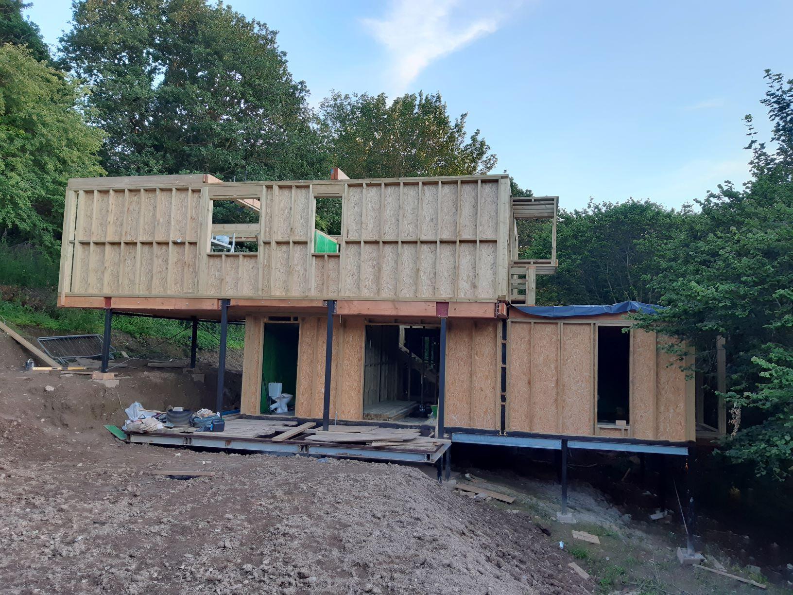

redtop Posted March 7, 2022 Share Posted March 7, 2022 (edited) Well we had 47 piles, concrete caps then steel posts, steel ring beams and then timber frame up from that. House sits at 300mm of the ground one side to 2.5m the other, thats over a distance of about 6m max so its on a pretty steep slope with trees all round. Edited March 7, 2022 by redtop 2 Link to comment Share on other sites More sharing options...
saveasteading Posted March 7, 2022 Share Posted March 7, 2022 Thanks all. Confirming what I knew really. This is conservative for a 6m span timber building with no upper floor and a central prop. Especially as it requires us to dig out the strong sand base and replace with type 1. Bottom slab is shown as 125 thick with 2 layers A252 Edge beam 2no layers of B1131 and pairs of 12mm links at 300cc. Link to comment Share on other sites More sharing options...
