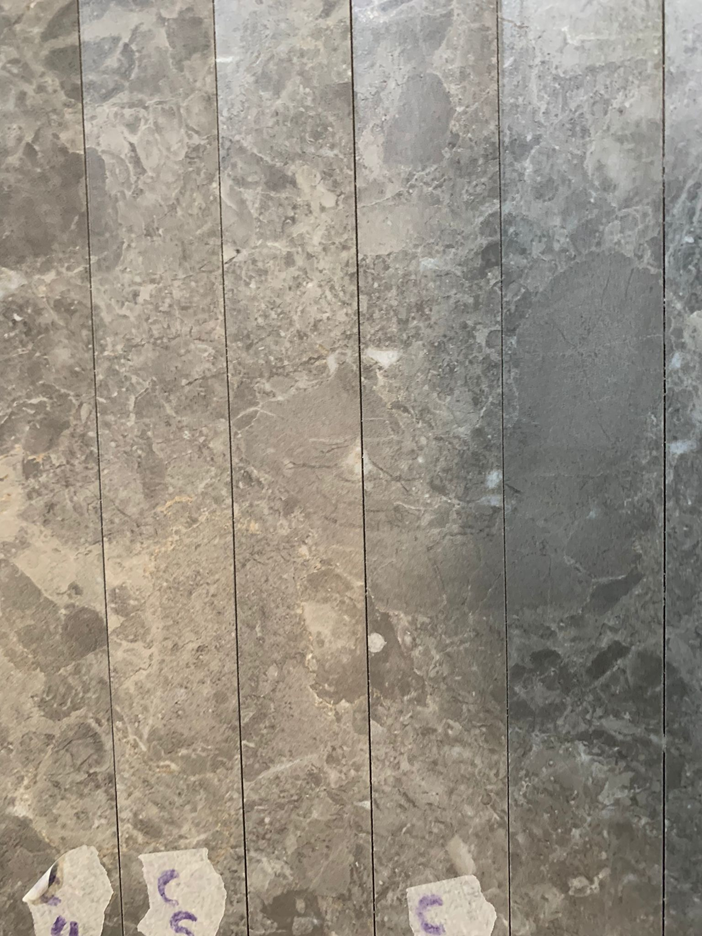

Adsibob Posted January 28, 2022 Posted January 28, 2022 I'm trying to work out if the following could give rise to mould. We are tiling a wet room. The substrate has been tanked and we are installing a series of 6mm thick porcelain tiles on a curved wall, in long narrow strips. The strips are 40mm wide and very long (about 60mm long). Photo below. You can't tell from this photo but each strip is exactly the same width, the visual distortion in widths is because each is on a slightly different plane to the next one so that after 13 or strips the wall curves through 90 degrees. I wasn't expecting the tiles to be so close together. In my head, when we were considering this design i assumed grout would go in between the strips and that whilst that would break up the pattern of the stone a bit, as long as we kept the grout lines thin, say 1.5mm or 2mm, one would still be able to appreciate the pattern. But when the tiler put this in, for some reason that didn't happen, so this part of the shower area will be groutless, with tiny gaps between each strip of tile that is probably just under a 1mm wide and no more than 6mm deep. I queried it with both my builder and my architect (who designed this) and they both said that there is such little room for water in there, that I shouldn't worry. They also mentioned that with MVHR and external wall insulation (only single brick solid wall, but recently upgraded with a 45mm external wall insulation system) mould just won't be an issue. Are they right? What about mould on niches in showers? We were going to have a slight fall in a niche, but it's going to make the tiling much harder. Much easier if the niche is flat, but would that attract mould?
JohnMo Posted January 28, 2022 Posted January 28, 2022 My option is and it could be wrong. Any small gap water will settle, the smaller the gap, then more capillary action will hold it there. Give mould half a change it will take hold. I would say it needs to be grouted or sealed in someway. The only thing if the sides of the tile are glazed that may help, if they are not, they may absorb moisture and make thing worse. Doing nothing, may be a high maintenance finish, needing plenty of cleaning.

Adsibob Posted January 28, 2022 Author Posted January 28, 2022 So it turns out the gap is only 2mm deep and probably even thinner than I thought. Probably just another example of me worrying excessively. 1

Andehh Posted January 29, 2022 Posted January 29, 2022 If the gaps less then 1mm you'll be probably struggle to grout it? I'd be tempted to try the LTP grout sealing spray thoroughly into the gaps to seal the concete behind & then just leave it. You could try grouting a small area as a test, but I'd be more worried about visual risks then damp risks, esp if it isn't directly in the shower area.

Adsibob Posted January 29, 2022 Author Posted January 29, 2022 1 hour ago, Andehh said: If the gaps less then 1mm you'll be probably struggle to grout it? Yes, I was worried about this. Is that because the grout line will be so weak it will just fall out? Are there any specialist resins which might work? What do “magic men” use to fill tiny cracks, for example?

Andehh Posted January 30, 2022 Posted January 30, 2022 You could try silicone, in a colour very similar to your tiles? Use a silicone scraper to ensure a flush finish & clean up of over spill. Might take some time & patience, but im sure it'd do the job? Again, test in a small discrete area first.

SimonD Posted January 30, 2022 Posted January 30, 2022 On 28/01/2022 at 17:08, Adsibob said: 6mm thick porcelain tiles on a curved wall, in long narrow strips. Have these been cut on site, or were they delivered as long and thin? Is this a porous porcelain and have they been fully sealed before installation? Personally I think there are potentially several problems that might arise from this as even if the tiles are tightly butted together, if not sealed, moisture will get in there.
Pocster Posted January 30, 2022 Posted January 30, 2022 Water always gets where you don’t want it . I can’t understand why the tiler thinks a gap ( no matter how small ) is ok in a wet area . It may be possible to grout that - certainly try before silicone on a small area .
Adsibob Posted January 30, 2022 Author Posted January 30, 2022 Yeah, on reflection I really don't understand why they did it this way. They should have built out with a touch more adhesive to make slightly bigger gaps which could then be grouted.
Adsibob Posted January 30, 2022 Author Posted January 30, 2022 51 minutes ago, SimonD said: Have these been cut on site, or were they delivered as long and thin? Is this a porous porcelain and have they been fully sealed before installation? Personally I think there are potentially several problems that might arise from this as even if the tiles are tightly butted together, if not sealed, moisture will get in there. They were cut with a water jet cutter, off site, about 3 months ago. The porcelain is this stuff: https://www.marazzitile.co.uk/collections/grande_stone_look/piastrelle I wouldn't have thought it was porous, but what do I know.

Adsibob Posted January 30, 2022 Author Posted January 30, 2022 5 minutes ago, TonyT said: Time to bin the Architect as per the worktop post. Architect is now saying they will fill it with very runny grout or ask the stone guy who is coming tomorrow to see if he can fill it with silicone. But I agree this is really starting to get ridiculous.
SimonD Posted January 30, 2022 Posted January 30, 2022 13 minutes ago, Adsibob said: They were cut with a water jet cutter, off site, about 3 months ago. The porcelain is this stuff: https://www.marazzitile.co.uk/collections/grande_stone_look/piastrelle I wouldn't have thought it was porous, but what do I know. Okay, so the laying guidelines from the company you link says this: Quote The company declines all responsibility for laying without joints; minimum joint laying has a gap of 2 mm. The joints must be positioned: on structural joints; between the floor and the wall (perimeter joints); between one tile and another (laying joints); between the tiles and other materials (e.g. combinations of ceramics/linoleum /wood). Secondly, for fine porcelain stoneware polished tiles, it says waterproof treatment required (this is sometimes only required when installed on floor). Here is a link to the document: https://www.marazzitile.co.uk/media/filer_public/e9/5f/e95f3156-f66b-4e26-9ae8-c51edfe8bd14/posa_manutenzione_marazzi.pdf I reckon you need to call the tile company to get their view of it. 1
Adsibob Posted January 30, 2022 Author Posted January 30, 2022 (edited) 29 minutes ago, SimonD said: Okay, so the laying guidelines from the company you link says this: Secondly, for fine porcelain stoneware polished tiles, it says waterproof treatment required (this is sometimes only required when installed on floor). Here is a link to the document: https://www.marazzitile.co.uk/media/filer_public/e9/5f/e95f3156-f66b-4e26-9ae8-c51edfe8bd14/posa_manutenzione_marazzi.pdf I reckon you need to call the tile company to get their view of it. I think their view is clearly set out in the material you found, which is very helpful, thanks. I’ve emailed it to the architect and given him a telling off and told him to stop instructing non-standard working techniques. It is odd though, because the builder (who did some of the grouting himself) was also reassuring me that this wouldn’t cause a mould issue because the amount of water in question was so tiny and almost all of the 6mm thickness of the tile has been packed out with adhesive. Does it make a difference that all water in that shower area is softened with salt? Reminding everyone that we are talking about a crevice that is less than 0.5mm thin and 2mm deep. Edited January 30, 2022 by Adsibob
