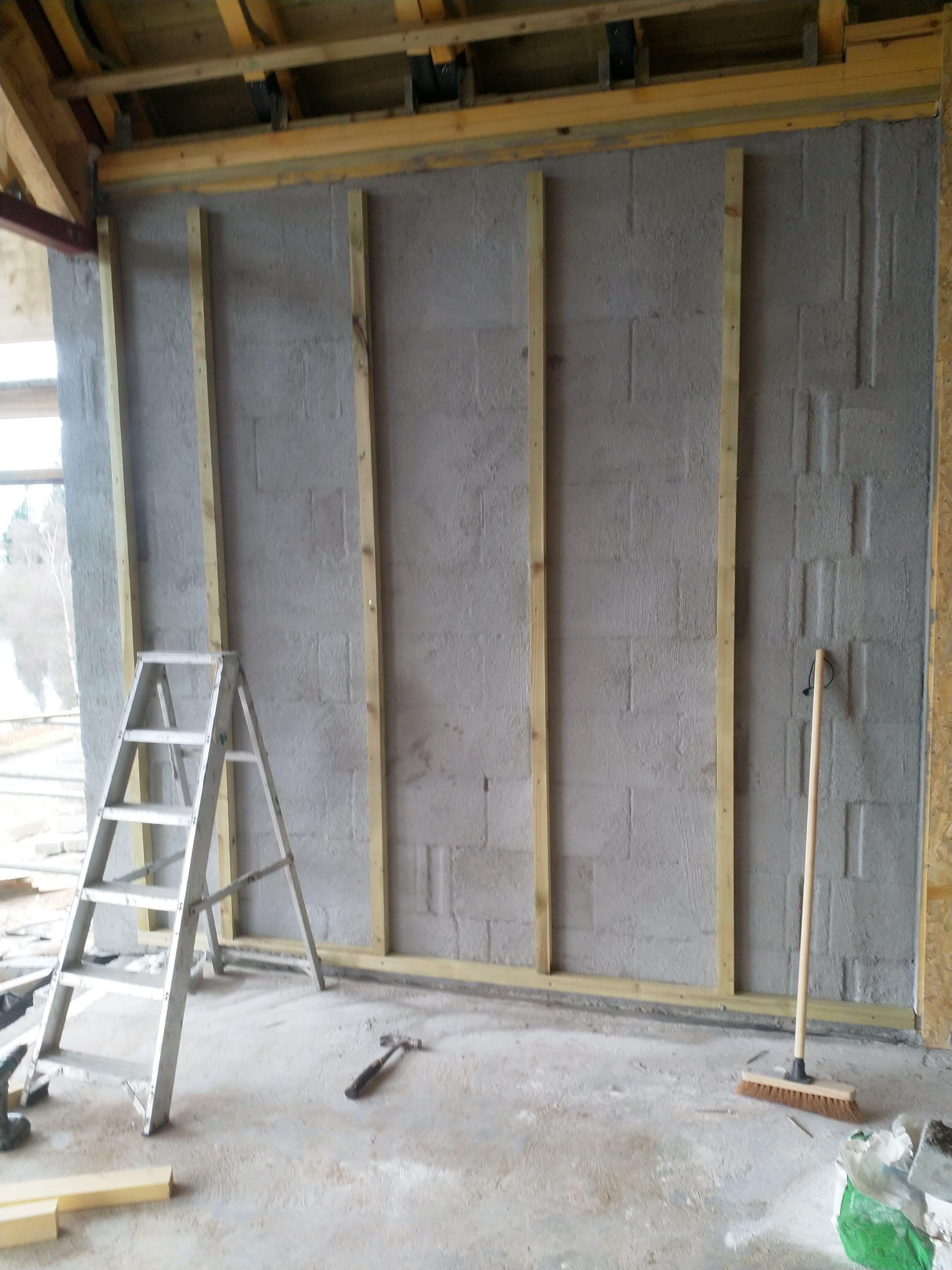

JohnMo Posted January 19, 2022 Posted January 19, 2022 Hence put it on thin to fill gaps and pin holes only. Broom in photo is the size I used for applying hithe parge coat. Mine is on Durisol blocks and you can see the blocks clearly. 2 1

Johnny Jekyll Posted February 25, 2022 Author Posted February 25, 2022 I have researched this quite a bit and finally settled on @JohnMo method. I mix approx one cement (mastercrete), three sand (building sand) and a bit of hydrated lime (hydralime), mix to a slurry / double cream thickness. I apply it by hand one block at a time with a block brush, rubbing into the surface so all holes are filled, then after 3/4 metres go back and brush the excess off with a softish brush. It's taking ages but doing a good job of it, and saving a huge amount of money compared to airtight paint / membranes etc. I'll be using the paint and tapes at junctions and windows but for the large wall sections this is going well. As they say, want a good job doing, do it yourself. Here's a photo of the mid floor area done, before fitting the wall plate for hanging the posi joists with joist hangers. 2
JohnMo Posted February 26, 2022 Posted February 26, 2022 Is that a photo after or before applying? Looks like before. I would apply it with a soft natural bristle brush, (12 to 14 inch) with the right mix there should be nothing to brush off.
