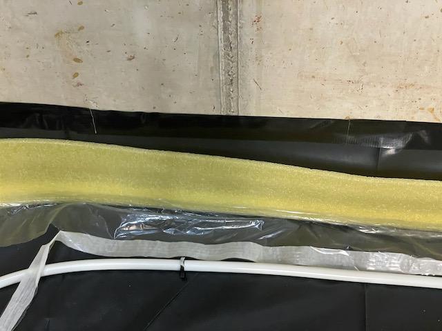

Thorfun Posted February 6, 2022 Author Posted February 6, 2022 (edited) On 17/01/2022 at 16:00, Dudda said: Ya do, that's perfect. No need for EPS or anything else. the yellow stuff I bought has a 'trim' of plastic with a sticky strip. I presume that is to go on the floor like the picture below? to stop screed getting underneath and behind the expansion strip? our screeders said to use gaffer tape for that but as this strip has the plastic built-in I presume we can just use that? or does it go at the top to stop screed splashing up and behind? what did others do with that plastic strip? edited to add: the eBay advert call it an overlap strip "25m 150mm x 8mm with self adhesive Overlap & Backing Strip" just doesn't mention where that overlap goes Edited February 6, 2022 by Thorfun
Thorfun Posted February 6, 2022 Author Posted February 6, 2022 actually, don't worry. I found a photo on the website for the company to show the plastic overlap at the bottom where I have it. https://www.uheat.co.uk/underfloor-heating-edge-perimeter-insulation-25m/ I figured it should be there but was having a special moment.

CalvinHobbes Posted October 24, 2024 Posted October 24, 2024 Any photos? We are putting down PIR on a slab next week and currently pretty clueless
Thorfun Posted October 25, 2024 Author Posted October 25, 2024 9 hours ago, CalvinHobbes said: Any photos? We are putting down PIR on a slab next week and currently pretty clueless Does this help? 1
