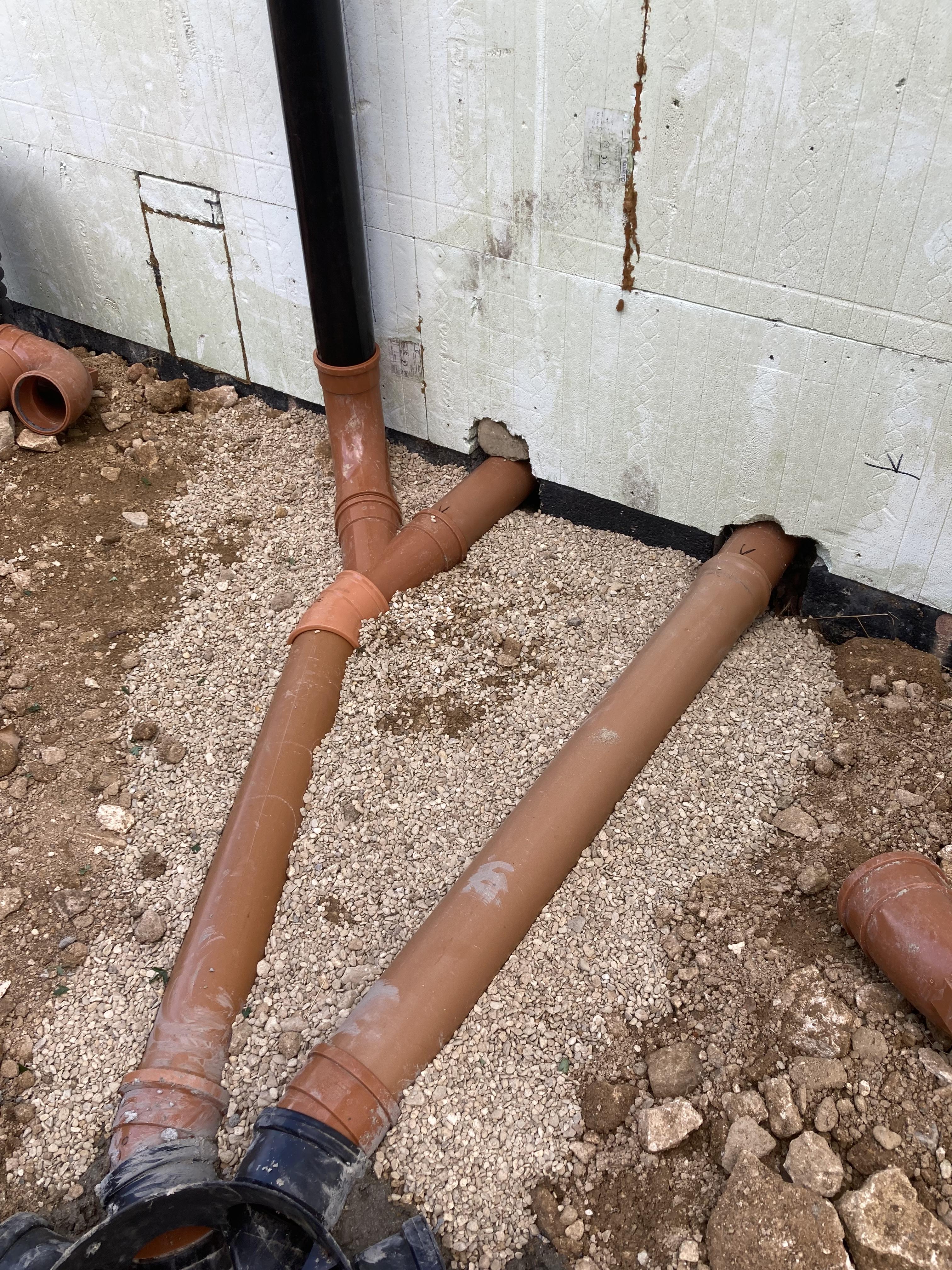

Russell griffiths Posted January 9, 2022 Posted January 9, 2022 you don’t need to run a separate pipe from the man hole, my vent pipe at the end of the run branches off from the last pipe to exit the house. it then runs up the wall of the house. it doesn’t need to go above the roof line. If you can comply with below. it does have To go higher than any opening window. it must be higher than the roof if you have roof vents that vent the loft, so your pipe doesn’t vent into the loft. 1

Bitpipe Posted January 10, 2022 Posted January 10, 2022 Our BC waived the need for an external SVP as the houses either side had them and they are to vent the sewer system and provide little benefit to the house itself. He said the requirement is really 1 in 10 properties needing one. AAVs inside the house at end of runs will provide the necessary system ventilation for flushing loos etc. Was a relief as we were this close -> <- to cutting a hole in one of the flat roofs, plumber had left his big holes aw at home that day so we had time to get a second opinion from BC.
Bramco Posted January 10, 2022 Author Posted January 10, 2022 1 hour ago, Nickfromwales said: Are you sure they said a Durgo ( aka Air Admittance Valve / AAV ) ? Nick, my mistake. There's a long email trail on this one and I remembered the mention of durgo valves but that was in connection with internal terminations. As you say, would be pointless if the termination wasn't 2 way. 37 minutes ago, Bitpipe said: He said the requirement is really 1 in 10 properties needing one. Ours isn't really close to the other properties connected to the main sewer. There's a row of semis with the sewer along the back, then it strikes diagonally across a 2 acre field with the original bungalow and our new build. The manhole we'll be connecting to is about 30m away. Not sure if all that makes any difference. 13 hours ago, Russell griffiths said: you don’t need to run a separate pipe from the man hole, my vent pipe at the end of the run branches off from the last pipe to exit the house. it then runs up the wall of the house. it doesn’t need to go above the roof line. If you can comply with below. it does have To go higher than any opening window. it must be higher than the roof if you have roof vents that vent the loft, so your pipe doesn’t vent into the loft. Russel, great idea, I'll mention this to the builders. And there won't be any roof vents as it's all vaulted ceilings and we'll easily be able to get it well away from (and above) the nearest opening window. 1

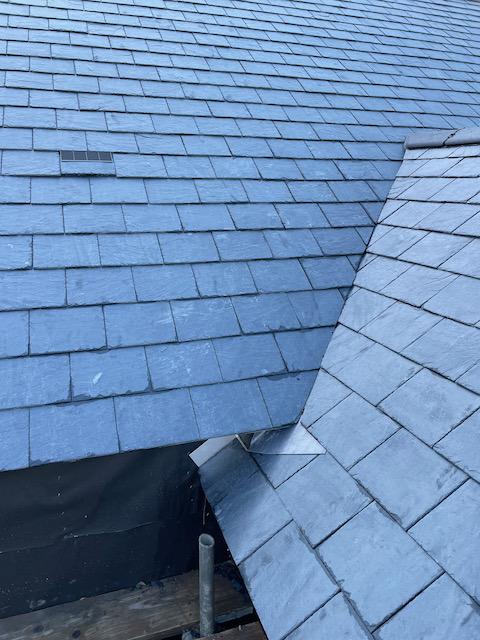

Thorfun Posted January 10, 2022 Posted January 10, 2022 I wondered about penetrations for SVP and then @Iceverge made this post and I didn't worry about it any more! fitted one of these https://www.slate.uk.com/product/nature-vent/ and it looks great and BCO was happy. 1
Bramco Posted January 10, 2022 Author Posted January 10, 2022 4 hours ago, Thorfun said: Looks great but..... Ours will be corrugated steel - think cow shed. Also, the roof build up is essentially roof felt above and airtightness membrane below filled with blown cellulose - so maybe less structurally 'firm' than yours? Simon
Thorfun Posted January 10, 2022 Posted January 10, 2022 33 minutes ago, Bramco said: Looks great but..... Ours will be corrugated steel - think cow shed. Also, the roof build up is essentially roof felt above and airtightness membrane below filled with blown cellulose - so maybe less structurally 'firm' than yours? Simon yeah, fair enough. we didn't want a pipe sticking out the top of the building and so when these slate vents were mentioned I jumped on it as you'd never really know it was there from the ground.
