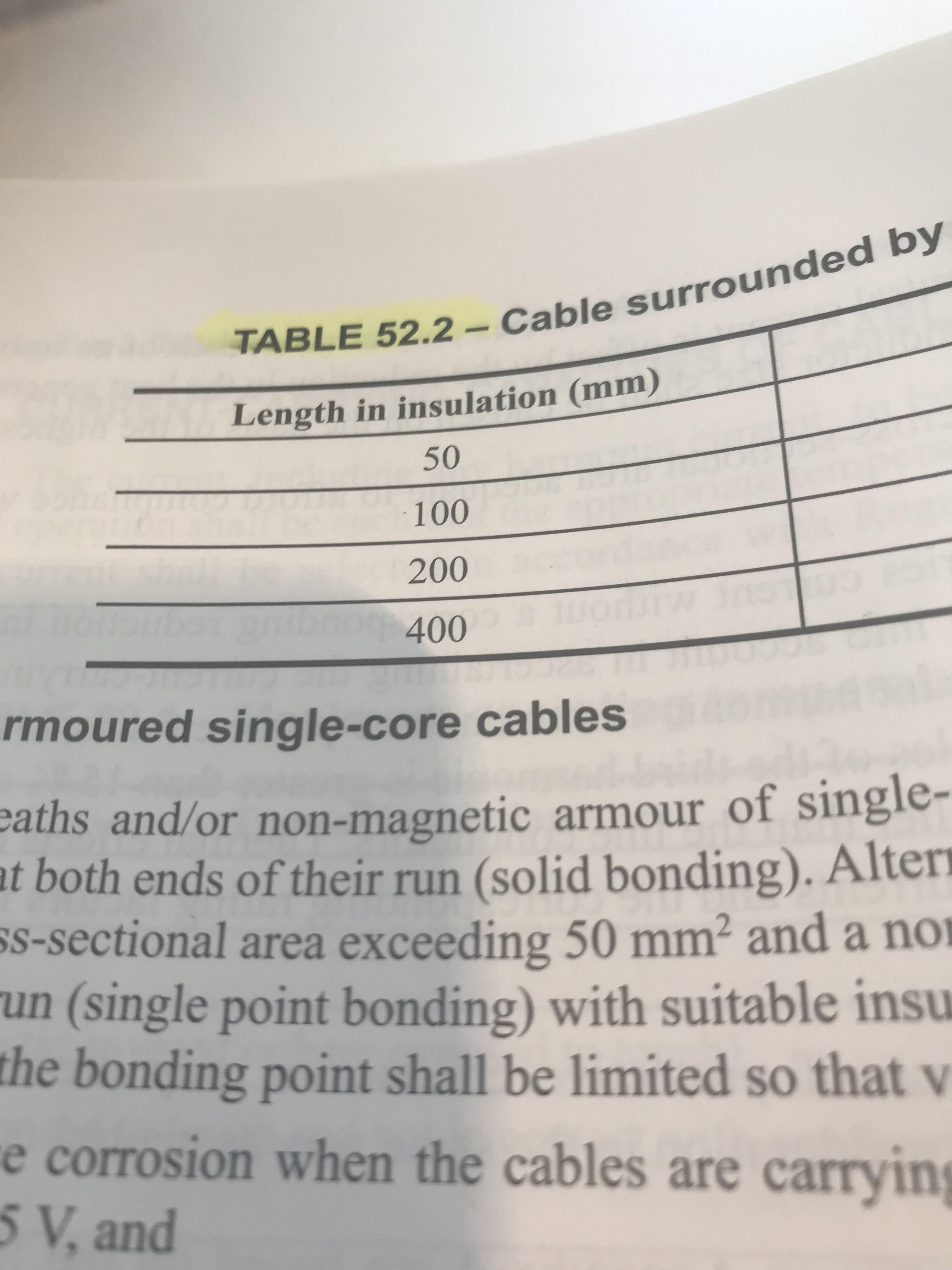

TonyT Posted January 5, 2022 Share Posted January 5, 2022 While the regs give guidance on derating cables totally surrounded by insulation for more than 50mm length in insulation. I think I wouldn’t bother worrying about it, I wouldn’t want mains cables next to data cables( wired video door bell springs to mind) but would just make sure they are sealed as per ProDave’s method. 1 Link to comment Share on other sites More sharing options...
Onoff Posted January 5, 2022 Share Posted January 5, 2022 18 minutes ago, TonyT said: While the regs give guidance on derating cables totally surrounded by insulation for more than 50mm length in insulation. I think I wouldn’t bother worrying about it, I wouldn’t want mains cables next to data cables( wired video door bell springs to mind) but would just make sure they are sealed as per ProDave’s method. Erm...500mm Link to comment Share on other sites More sharing options...
TonyT Posted January 5, 2022 Share Posted January 5, 2022 1 Link to comment Share on other sites More sharing options...
Onoff Posted January 5, 2022 Share Posted January 5, 2022 Just now, TonyT said: Fair enough & to think I have my 18th ? Why am I thinking 500mm? Link to comment Share on other sites More sharing options...
TonyT Posted January 5, 2022 Share Posted January 5, 2022 Wasn’t that if it was more than 500mm you had to half the Current carrying capacity of the cable as a general rule of thumb Link to comment Share on other sites More sharing options...
