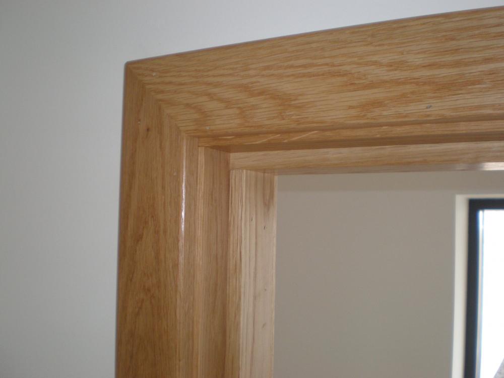

Jeremy Harris Posted April 23, 2017 Share Posted April 23, 2017 I bonded all our oak skirtings and architraves, with no screws of nails anywhere. I used mitre bond for the architrave frames, as suggested above, then bonded them all in place using the water based grip adhesive from Screwfix. Far, far better than the solvent based stuff, as it doesn't skin over and dry anywhere near as quickly. I've not had a problem with any of the 13 doors or any of the skirting - once it's bonded on it stays there. This is the grip adhesive I used: http://www.screwfix.com/p/no-nonsense-11663102-solvent-free-grab-adhesive-white-310ml-12-pack/61428 2 Link to comment Share on other sites More sharing options...

Jeremy Harris Posted April 24, 2017 Share Posted April 24, 2017 We went with oak linings, stops etc, as I thought it would look a bit odd to have an oiled oak door in a frame that was a different finish. Not cheap though, I think the linings and stops were close to the price of the doors. Link to comment Share on other sites More sharing options...

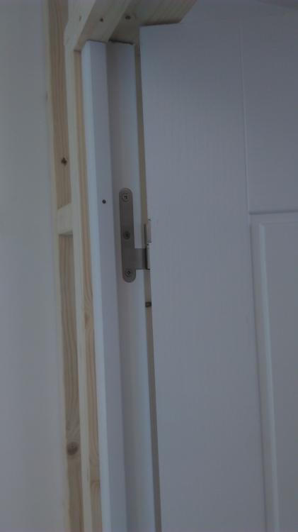

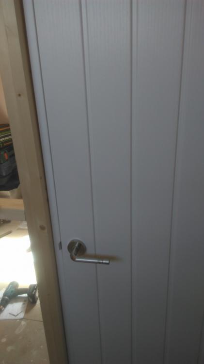

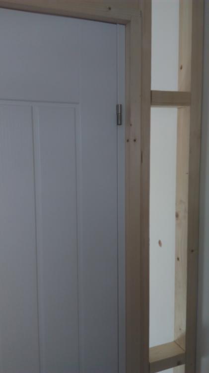

Simplysimon Posted April 25, 2017 Share Posted April 25, 2017 (edited) 11 hours ago, joe90 said: The lining and stop are one and the same thing. The lining is thicker and the rebate for the door is machined into it. 'fraid not, the lining is flat as normal, the door is hung as normal and then the stop is scribed, if necessary, to the door, especially to old doors. the stop is then dressed flush with the lining and the facings/architrave fitted as normal with a margin/list. the problem with rebated linings is that the rebate is normally the same depth as the door, this means that when hanging the door there is no clearance on the hinging side. as per below 9 hours ago, joe90 said: Yes, the lining has to match the door thickness. Personally I prefer planted on stops so I can set the stops exactly to the door after it's hung. the beauty of a full stop is that when painted there is no joint line liable to cracking to be seen when the door is closed as the facing/architrave covers it. edit - this also means you can, a mentioned previously, rebate the linings to slightly more than the thickness of the door, insert the matching door material to make the lining look to be solid in that material. Edited April 25, 2017 by Simplysimon extra info Link to comment Share on other sites More sharing options...
jamiehamy Posted April 25, 2017 Author Share Posted April 25, 2017 I'm lost - can we have some pictures please?! Link to comment Share on other sites More sharing options...
