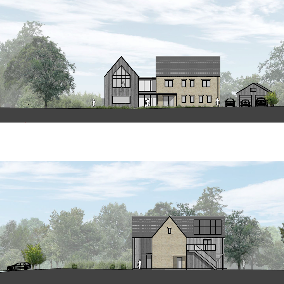

JAS-Build Posted January 4, 2022 Share Posted January 4, 2022 So after a six month wait we got a No from the Planning department on Christmas Eve. We're now hoping to get in front of the local Planning Committee. We should do it seems, because in line with the Council's Scheme of Delegation if the planning officer is at odds with any of the consultees it should, and we have both the Parish Council and our next door neighbour who have supported. The wording we have from planning department is: "The proposed replacement dwelling, by reason of its scale and mass, would harm the character and appearance of the area". We're wanting to build a 4 bed eco-house in local stone and timber to replace our tired 3 bed red brick bungalow on a 2 acre plot in our 10 acre property sited 120m from the road, and we're building 10% smaller than we could extend the bungalow to under Permitted Development. A close neighbour with a smaller plot, closer to the road replaced their old bungalow with a house 10% bigger than PD in local stone and timber and it went smoothly through Planning, so we thought it sensible to follow that precedent, and this was heavily referenced in our application. Any advice welcome. Thanks. John Link to comment Share on other sites More sharing options...

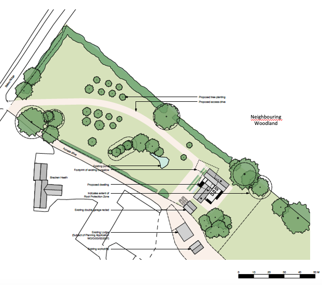

Temp Posted January 4, 2022 Share Posted January 4, 2022 5 hours ago, JAS-Build said: We're wanting to build a 4 bed eco-house in local stone and timber to replace our tired 3 bed red brick bungalow on a 2 acre plot in our 10 acre property sited 120m from the road, and we're building 10% smaller than we could extend the bungalow to under Permitted Development. A close neighbour with a smaller plot, closer to the road replaced their old bungalow with a house 10% bigger than PD in local stone and timber and it went smoothly through Planning, so we thought it sensible to follow that precedent, and this was heavily referenced in our application. Think I would reply asking him to refer it to the Planning Committee. Repeat the sentiment expressed in the above paragraph in the letter and point out that the Parish and neighbours are happy and tell him it would be your intention to appeal if the application is refused. It wouldn't be unreasonable to copy the Chair of the Planning Committee and/or your Councillor with the letter and perhaps include your best rendering to remind him of the proposal. 1 1 Link to comment Share on other sites More sharing options...

Johnnyt Posted January 4, 2022 Share Posted January 4, 2022 "The proposed replacement dwelling, by reason of its scale and mass, would harm the character and appearance of the area". Is this the only reason for refusal on the decision notice, if so it is purely subjective? Or is there anything else cited ? I asked because our initial application was refused for character and greenbelt reasons. Once we were confident on the greenbelt element for the refusal could be overcome that left us to deal with the landscape and character issue. It would appear no absolute planning policy has been breached but rather it doesn't suit the opinion of the planning officer. A superior authority, ie an inspector could come to a different opinion if well reasoned. A landscape visual impact assessment my help........it certainly did with our appeal, an expert could demonstrate in detail why it is acceptable in landscape and visual amenity terms. 2 Link to comment Share on other sites More sharing options...

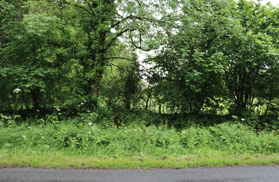

joe90 Posted January 5, 2022 Share Posted January 5, 2022 22 hours ago, Andy brown said: And ask for costs as their decision looks to be meritless on what you have shared. You can only demand costs if you can prove the planners broke the rules, not abiding by their own policies even is not enough to ask fir costs (ask me how I know). I would get someone to do a “street view”, mine was done by an architect who did a pen sketch of the outline of the house, hedges, trees and neighbours to show the actual impact. This helped a lot with the appeal. 2 Link to comment Share on other sites More sharing options...
JAS-Build Posted January 11, 2022 Author Share Posted January 11, 2022 On 05/01/2022 at 19:30, joe90 said: You can only demand costs if you can prove the planners broke the rules, not abiding by their own policies even is not enough to ask fir costs (ask me how I know). I would get someone to do a “street view”, mine was done by an architect who did a pen sketch of the outline of the house, hedges, trees and neighbours to show the actual impact. This helped a lot with the appeal. Thanks Joe90. This is the 'street view' photo submitted in the Design Statement by our architect, together with a couple of others. This, plus our proposed additional tree planting in the landscaping plan, makes the proposed house all but invisible to the public. Our nearest neighbours can see some of it side on but they're happy and sent a supporting comment during the Council's consultation period. Link to comment Share on other sites More sharing options...

epsilonGreedy Posted January 11, 2022 Share Posted January 11, 2022 (edited) On 04/01/2022 at 10:24, JAS-Build said: and we have both the Parish Council and our next door neighbour who have supported. Received wisdom on this forum is that Parish Councils have very little influence on planning decisions, the usual context of such discussions is an objection from the PC. By implication their support does not count for much. Your design is rather large, it looks over 3000 sq ft of internal floor space. When you made a comparison with your existing bungalow was that based on ground foot print or livable internal floor space? Edited January 11, 2022 by epsilonGreedy 1 Link to comment Share on other sites More sharing options...
