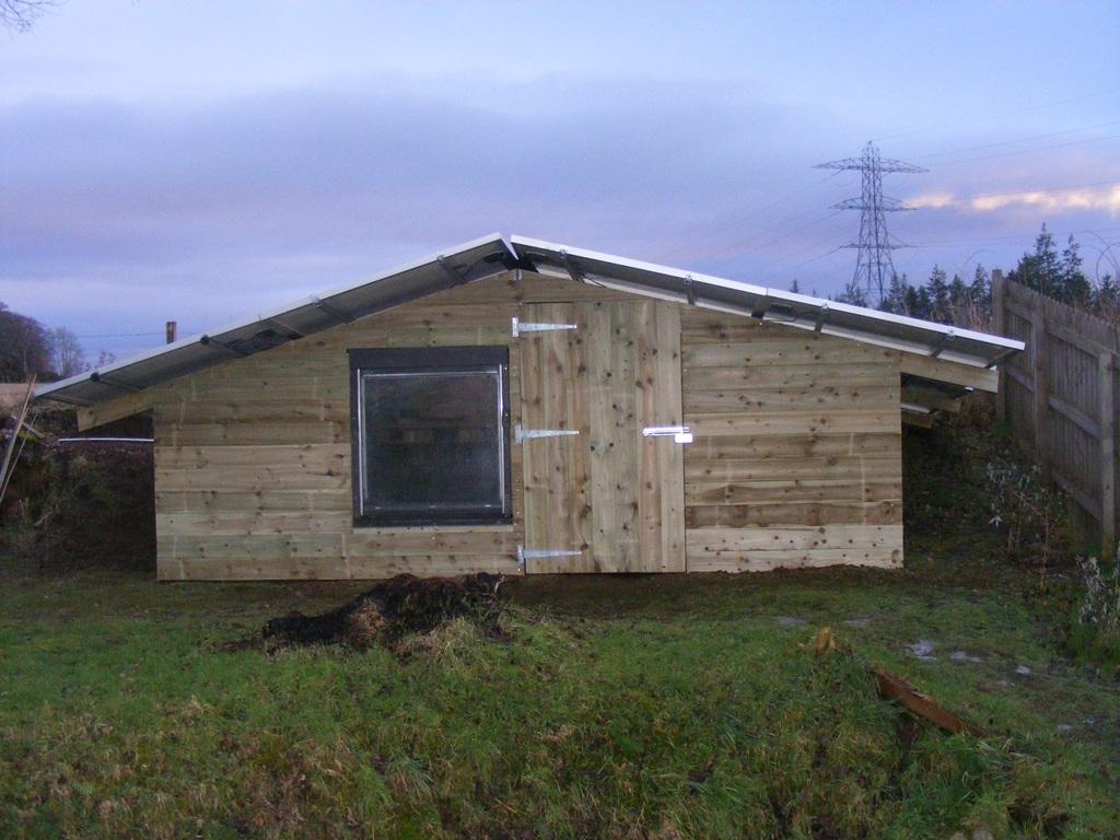

CotswoldDoItUpper Posted December 28, 2021 Author Share Posted December 28, 2021 @epsilonGreedy our heating is LPG, @SteamyTea we have 1 EV and 1 ICE, soon changing to 2 EV. @ProDave we don’t have horses…. Should we build a shelter ‘just in case’? Link to comment Share on other sites More sharing options...
ProDave Posted December 28, 2021 Share Posted December 28, 2021 Well I went for ground mount to at least get away from some of the shading by the trees. It had to be raised off the ground so see over the bank behind us. I chose an east / west split to try and get longer meaningful generation rather than peak generation (easier to self use). Then when the mounting frame was up and the panels were on, it was a no brainer to enclose the sides and make the "Swiss chalet solar shed" 1 Link to comment Share on other sites More sharing options...
Marvin Posted December 28, 2021 Share Posted December 28, 2021 (edited) https://www.planningportal.co.uk/info/200130/common_projects/51/solar_panels/3 amongst other rules for off building set-ups Only the first stand alone solar installation will be permitted development. Further installations will require planning permission. No part of the installation should be higher than four metres The installation should be at least 5m from the boundary of the property The size of the array should be no more that 9 square metres or 3m wide by 3m deep Edited December 28, 2021 by Marvin Link to comment Share on other sites More sharing options...
epsilonGreedy Posted December 28, 2021 Share Posted December 28, 2021 1 hour ago, CotswoldDoItUpper said: @epsilonGreedy our heating is LPG, Ok in that case @SteamyTearaises an interesting question. Where are these weekly 220 kWh going? One kWh = 3 to 4 EV vehicle miles. So a typical monthly mileage would account for 30% of your mains electric consumption if most charging is at home. Above that how often is the tumble drier on or is it lots of long showers heated from an electric element? How much PV do you need? I think that comes down to lifestyle, daily EV miles and can you charge up during peak day light PV hours. As others have said you will experience a deficit in winter and will struggle to consume PV in the summer from a large array. Link to comment Share on other sites More sharing options...
SteamyTea Posted December 28, 2021 Share Posted December 28, 2021 (edited) 2 hours ago, CotswoldDoItUpper said: we don’t have horses…. Should we build a shelter ‘just in case Yes, and design it to make full use of the PV modules on the roof. Could make something really quite good and useful, and a place to put lots of batteries/heat store in to soak up some excess generation. May even be able to 'split' a system so some is totally off grid, therefore keeping within the 16A per phase generation limit. On my weekly trips up country, I stop for a coffee in the Cotswolds. Edited December 28, 2021 by SteamyTea Link to comment Share on other sites More sharing options...
