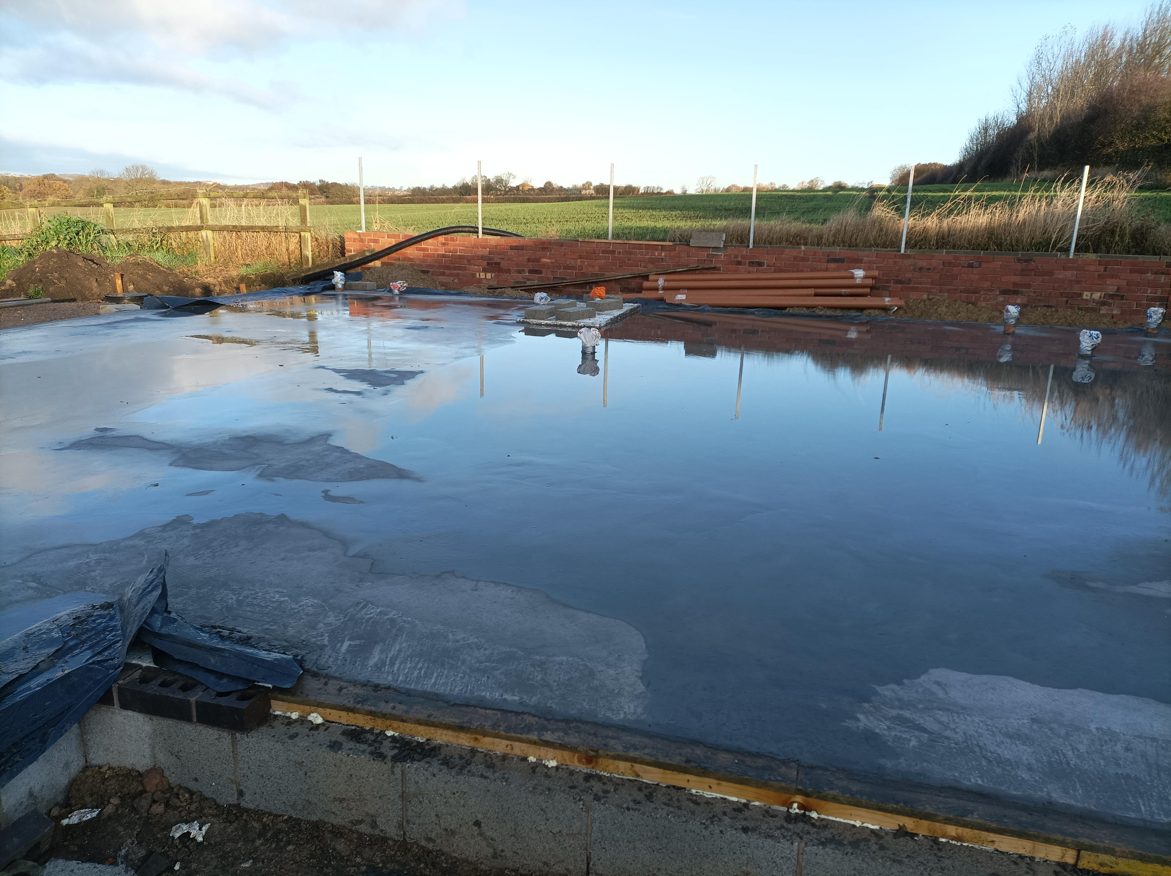

gravelrash Posted November 26, 2021 Posted November 26, 2021 Just had concrete finished floor slab laid yesterday which was power floated...How flat and level is flat and level? rained this morning before I had a look and there is a lot of ponding and high spots.
Moonshine Posted November 26, 2021 Posted November 26, 2021 looks good to me, you are probably only looking at +_mm
markc Posted November 26, 2021 Posted November 26, 2021 Water will look like puddles on the flattest of surfaces. This looks pretty good. Unless there is a deep bit in the larger area then I would be very happy with this

Mr Punter Posted November 26, 2021 Posted November 26, 2021 Yet another inner city infill! Get a 5p piece and lay it flat in the centre of the puddle. If it is not submerged you know it is less than +-2mm.

Gus Potter Posted November 26, 2021 Posted November 26, 2021 How deep are the puddles & how much higher are the high spots compared with the water surface. For all. If you can when your SE is designing any concrete slab or an IFC basement ask them to indicate on the drawings the level and flatness tolerances of say the hard core under the slab relative to a datum. Next maximum and minimum slab thickness relative to the datum. This is important as it can impact on what is going above.. say maximum and minimum thickness of wall plate bedding, slab performance and so on. Some times your Architect will also specify a flatness and level for a slab based on the floor finish requirements. It's good practice to do this. There is a difference between slab level and slab flatness. For example take a rectangular slab. One long end could be sitting 15mm above the other. The slab is sloping from one end to the other. It could be perfectly flat in between but if say it had depressions or high spots in it pretty quickly you can see that if you add the figures together then you invite problems with the super structure and flor finishes. It takes a bit of work to get your head around how you spec these things. A lot of SEs will use the BRE TR34 guide which relates to industrial floor design but it's easy to adapt for the self build market. On the other it is important not to go over the score and try and get things any flatter than the need to be.. you will just waste money. 1
gravelrash Posted November 27, 2021 Author Posted November 27, 2021 SE and architect never specified tolerance, the concrete guys had a datum to work to and guy floating the finish asked what floor finish I was having which I told him to just cover me for every type and get it as flat and level as possible. A rough check seems to be that the level falls about 8mm across 14.6m of floor with the puddled areas less than 2mm low and one spot has a slight ridge of 3/4mm and about 1m long...but I think this would be under a kitchen cupboard later.

Mr Punter Posted November 27, 2021 Posted November 27, 2021 What you have there is well within tolerances. If you laid some Astroturf you could use it as a bowling green. I assume the puddles were not deep enough to cover a 5p piece?
saveasteading Posted November 27, 2021 Posted November 27, 2021 I think that will be fine. An inspiring boss once dealt with this by chucking a pound coin into the puddle, and asking the client if he was now ok with it. He later explained that the water was deeper than the coin but that this always works up to 3mm, which is the tolerance. Remember that the slab will be a bit high and a bit low variously so this can exaggerate the effect. You will not notice this in real life and does not need an overscreed, If you ever see a leak in the fanciest of retail sheds, you will see just the same. The official test is a 3m long straight-edge (or an unusually straight piece of wood). Lay it anywhere and look for a 3mm or more gap. I suspect you will not have that. The water is good for your concrete anyway.
