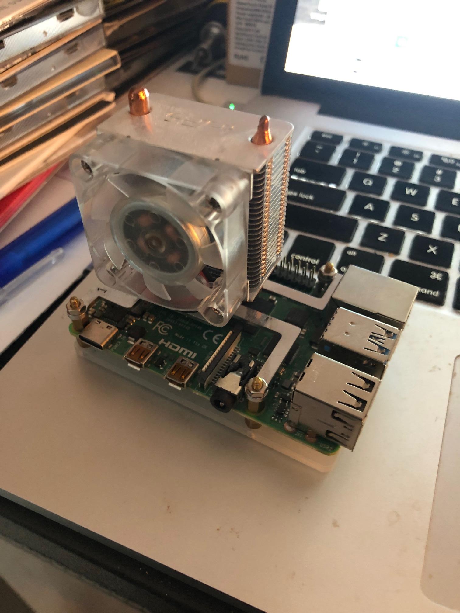

Pocster Posted December 10, 2021 Author Share Posted December 10, 2021 Right enough fecking about! Back to good old raspberry pi 3 or 4 (so a nice unique MAC ) ; dig out some amp hat's. Purchase a few poe hats. This should solve it all. Have quite a few zero's ( and amp hat's ) available if anyone is now interested??? Forgot I had this fan to overclock the bad boy! Link to comment Share on other sites More sharing options...
