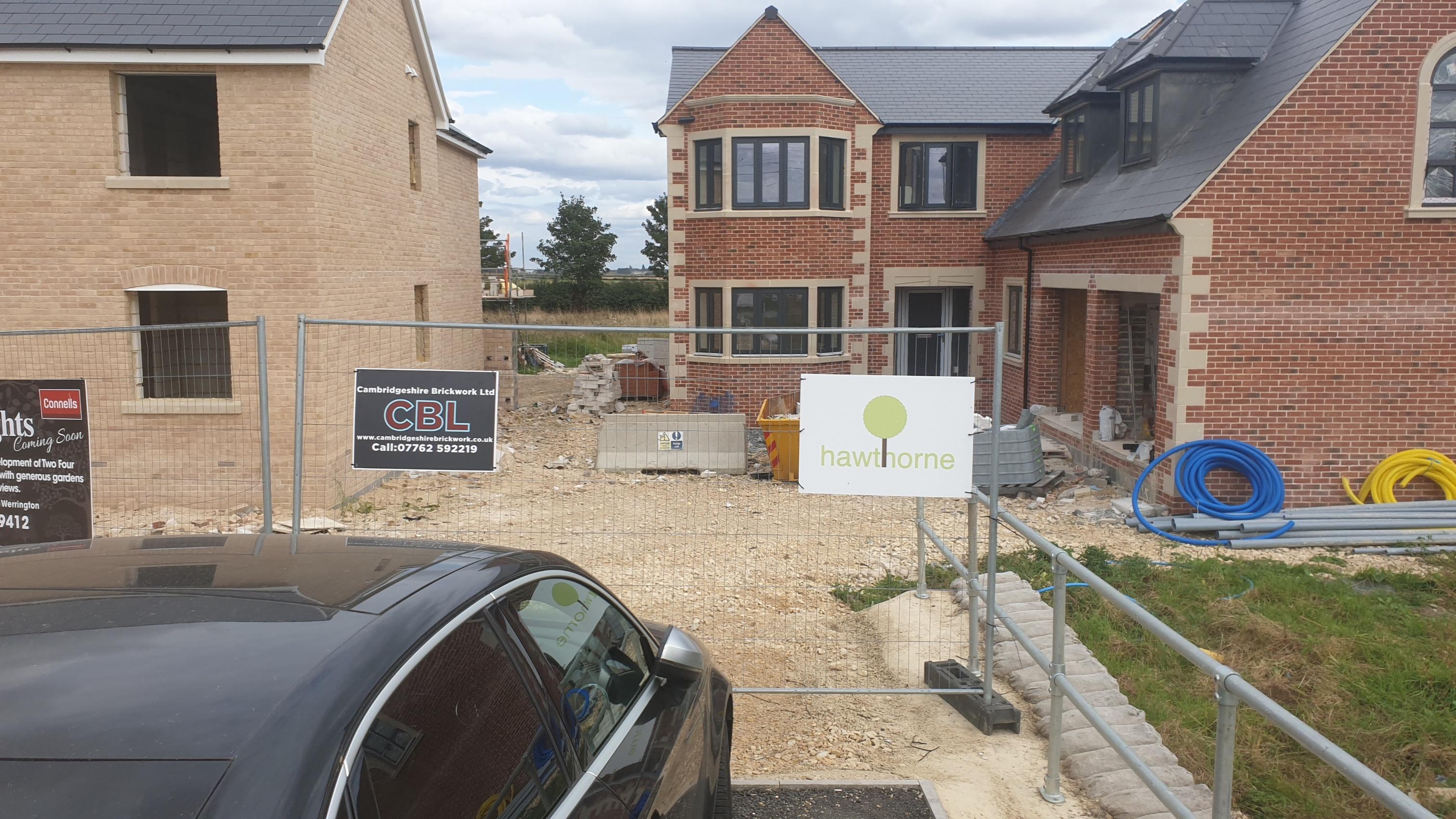

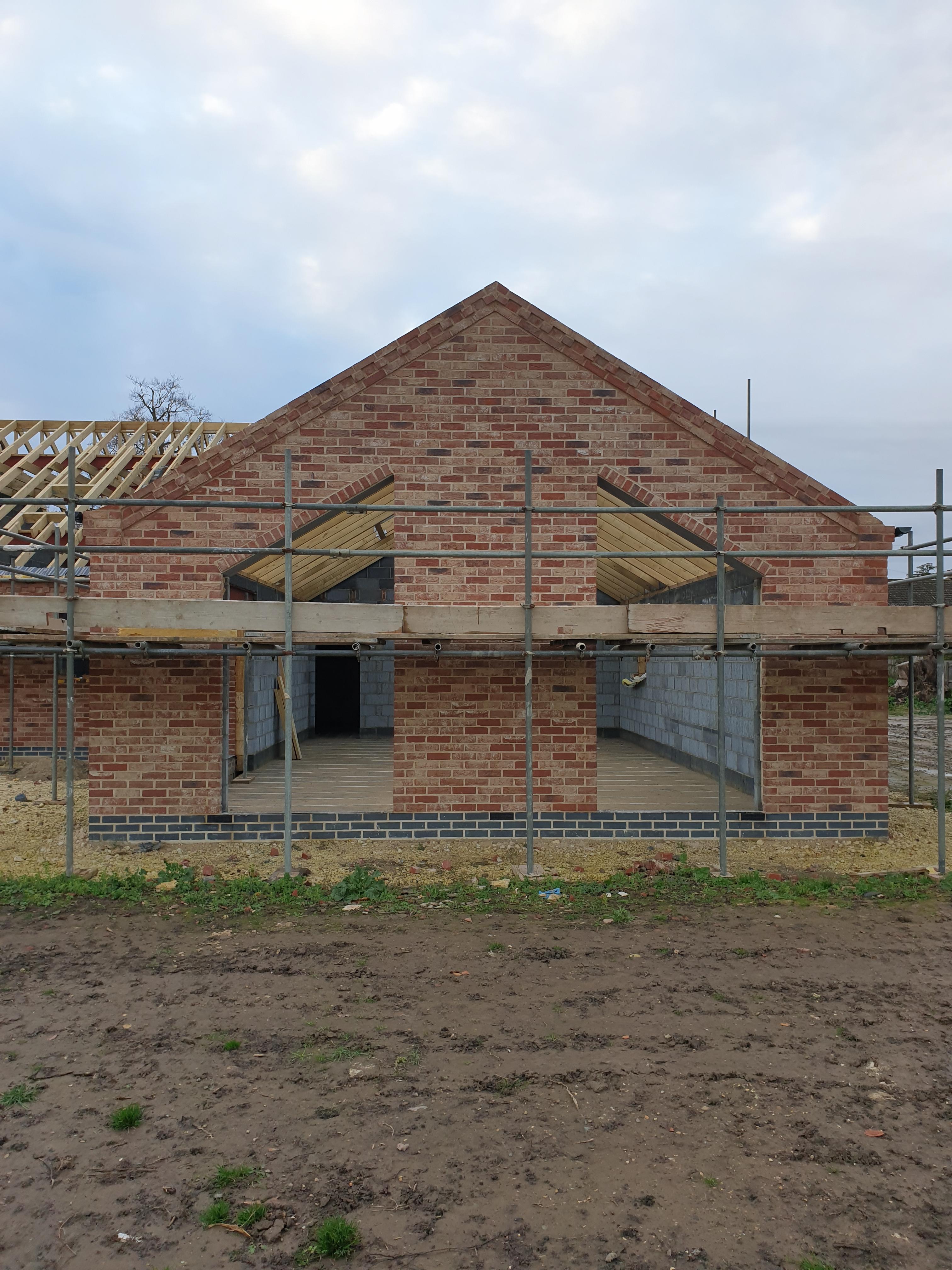

Faz Posted November 14, 2021 Share Posted November 14, 2021 Used it on my 3 - looks great with the red bricks (and the buff tbh). Only negative experience is that it is a bit more prone to salting - especially if laying across the winter. Got salt lines where the rain splashed up from the lifts. Link to comment Share on other sites More sharing options...

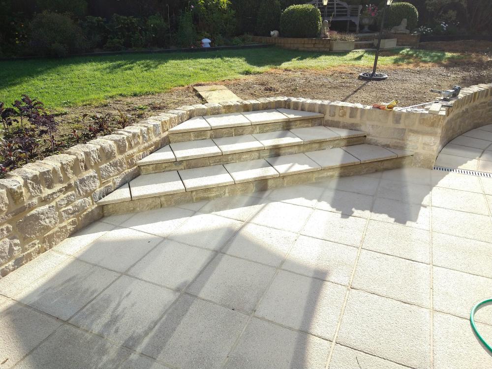

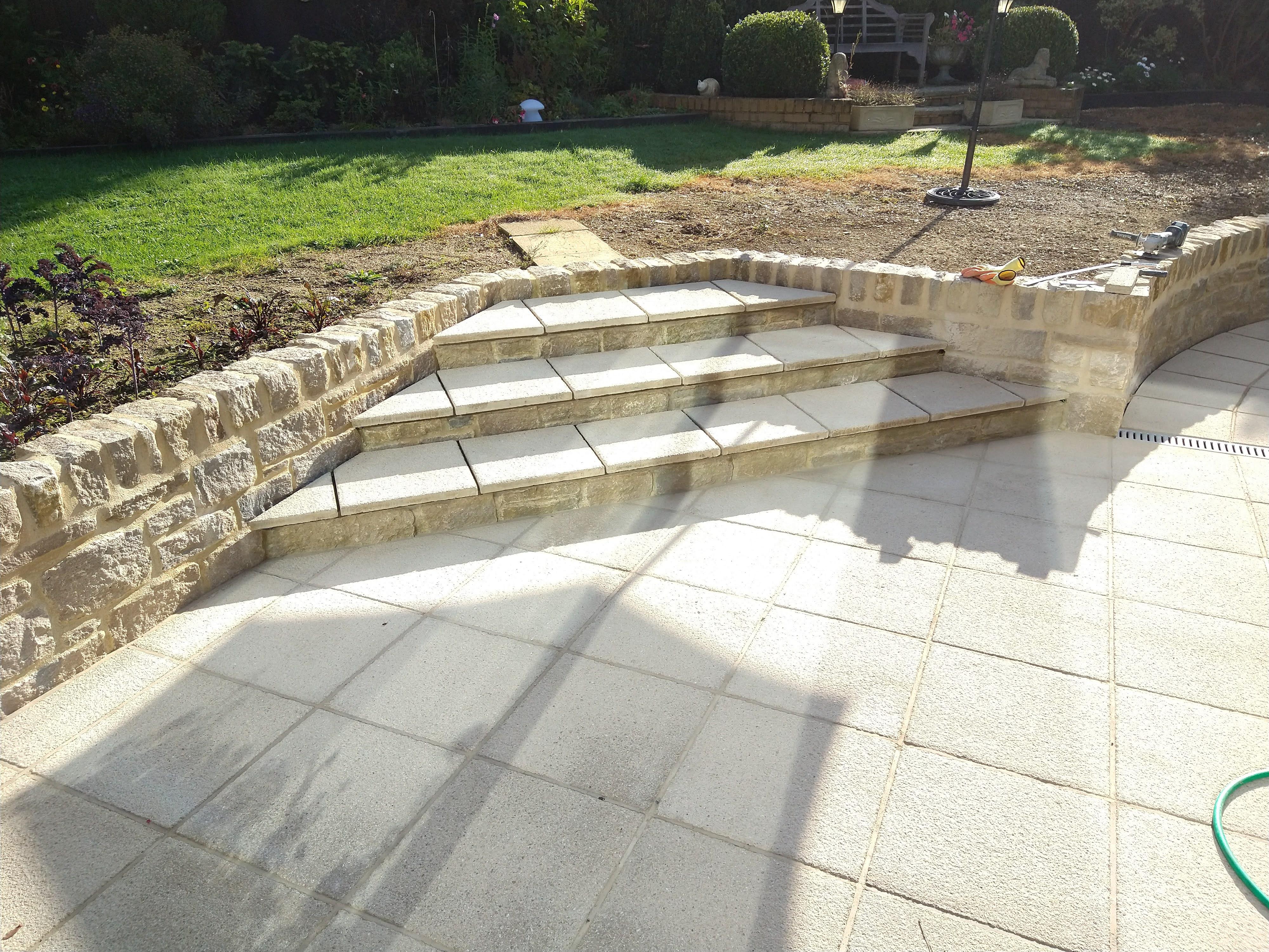

Radian Posted December 8, 2021 Share Posted December 8, 2021 52 minutes ago, Tony K said: Well, having just done a trial sample I'm not blown away from the Snowcrete white cement, at least not in a 1:4 mix with yellow building sand. I found the mortar made with Snowcrete to be incredibly sensitive to the colour of the sand. Our house was built with purbeck sandstone set in a mortar composed of one part both white cement and lime with six parts of what was referred to as 'ginger' sand by the planners (to match local buildings) and when I built some recent additions I had a hard time matching it. I ended up with three different sand supplies and had to mix them carefully to get a decent match. What did suprise (and please) me was when it came to pointing the patios I wanted a slightly different look and mixed up some grey OPC with the 'gingerest' of the three (because I still had a ton of that left over). The mortar came out quite a light buff which blended nicely with the slabs. 1 Link to comment Share on other sites More sharing options...

Radian Posted December 8, 2021 Share Posted December 8, 2021 I hope the colour of the mortar shows up in my photo (BTW the steps wern't pointed at that time). I was quite surprised at how there was no hint of greyness to it - I think the strength of the ginger somehow cancelled it out, but yes, I was most relieved not to have to pay out for the expensive cement again! Link to comment Share on other sites More sharing options...

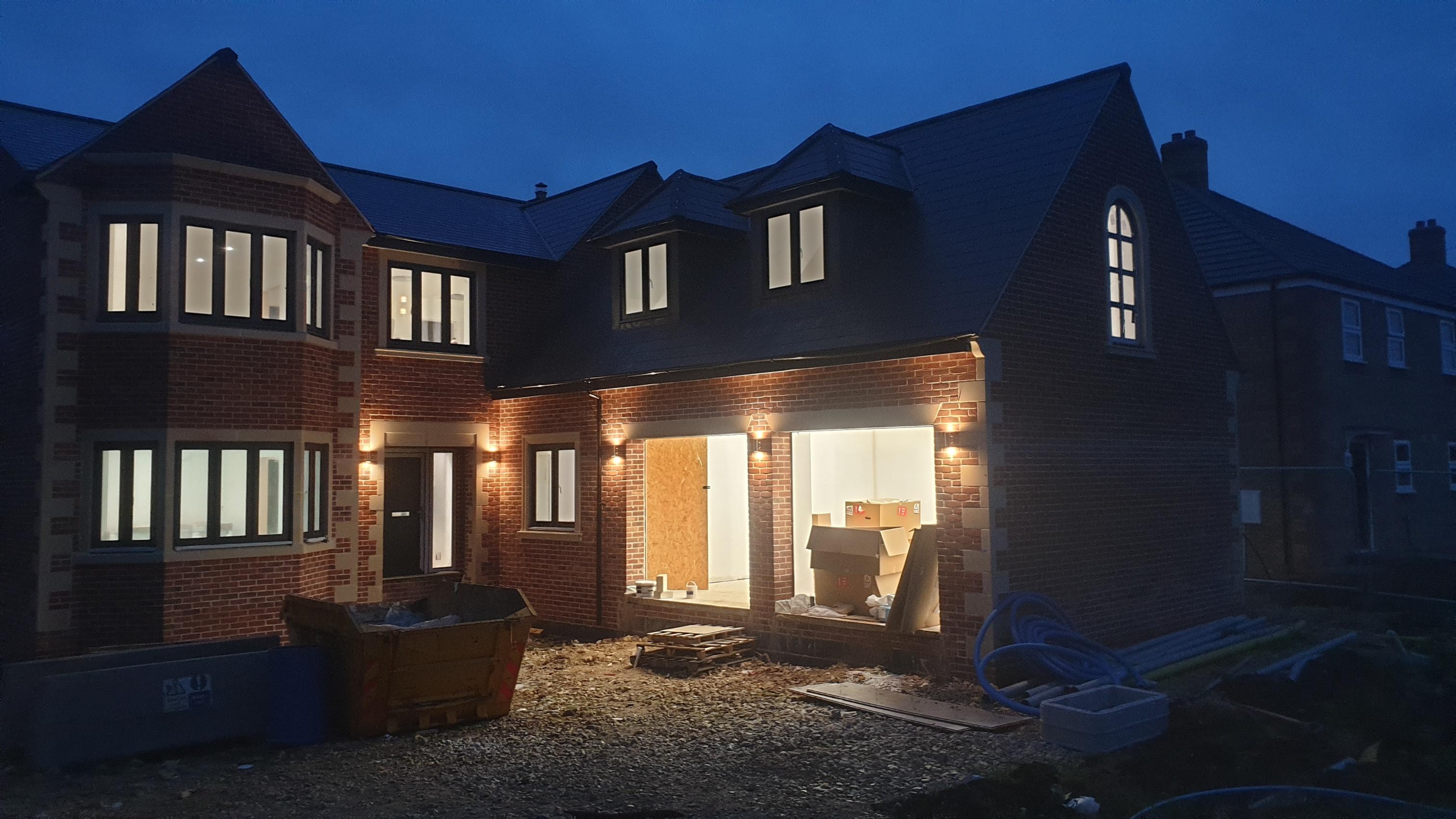

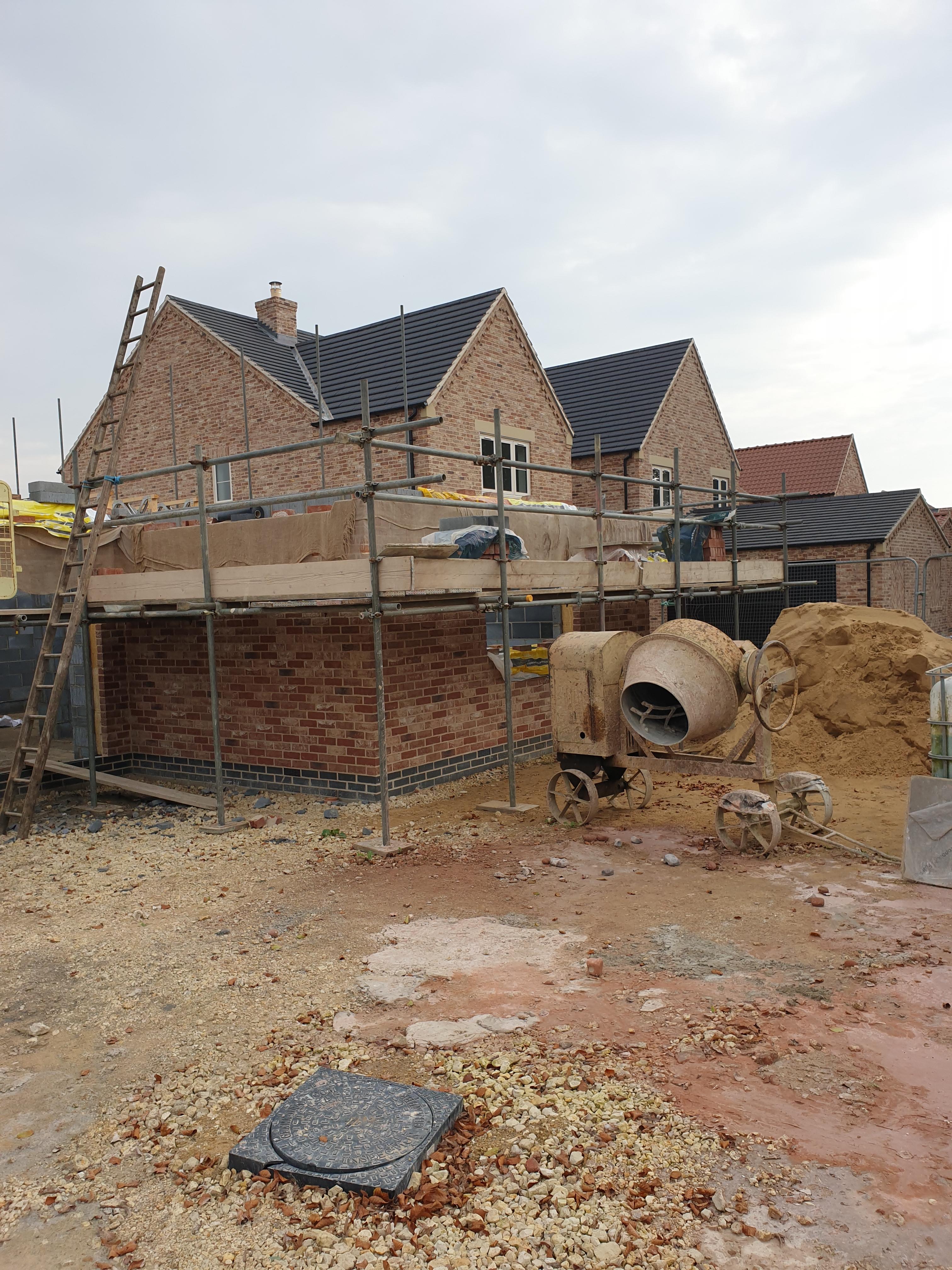

Buzz Posted December 9, 2021 Share Posted December 9, 2021 1 hour ago, Tony K said: Here it is. 4 building sand to one snowcrete. Not very reminiscent of snow. As mentioned above, give it time and see what colour it it goes to , I was a little disappointed with ours when I first saw them being laid but after a few weeks the whiteness started to come through and is just right IMHO for the bricks. Link to comment Share on other sites More sharing options...

Buzz Posted December 9, 2021 Share Posted December 9, 2021 40 minutes ago, Tony K said: Did you use snowcrete and building sand at 1:4 to get the result in your photo @Buzz? Not sure about the ratio as that was the builders call but I know it was Hanson white cement with a bit of lime , this is the only pic I have of the sand make of it what you will . Link to comment Share on other sites More sharing options...
