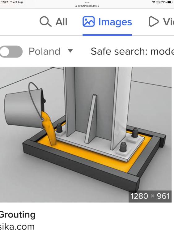

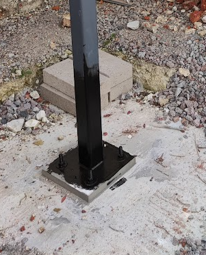

eandg Posted August 9, 2022 Share Posted August 9, 2022 This is a job I'm going to need to grapple with shortly. If in doubt, get the brickie out to do it? For a baseplate that's 240x240 what dimensions should the grout be? Thanks. Link to comment Share on other sites More sharing options...

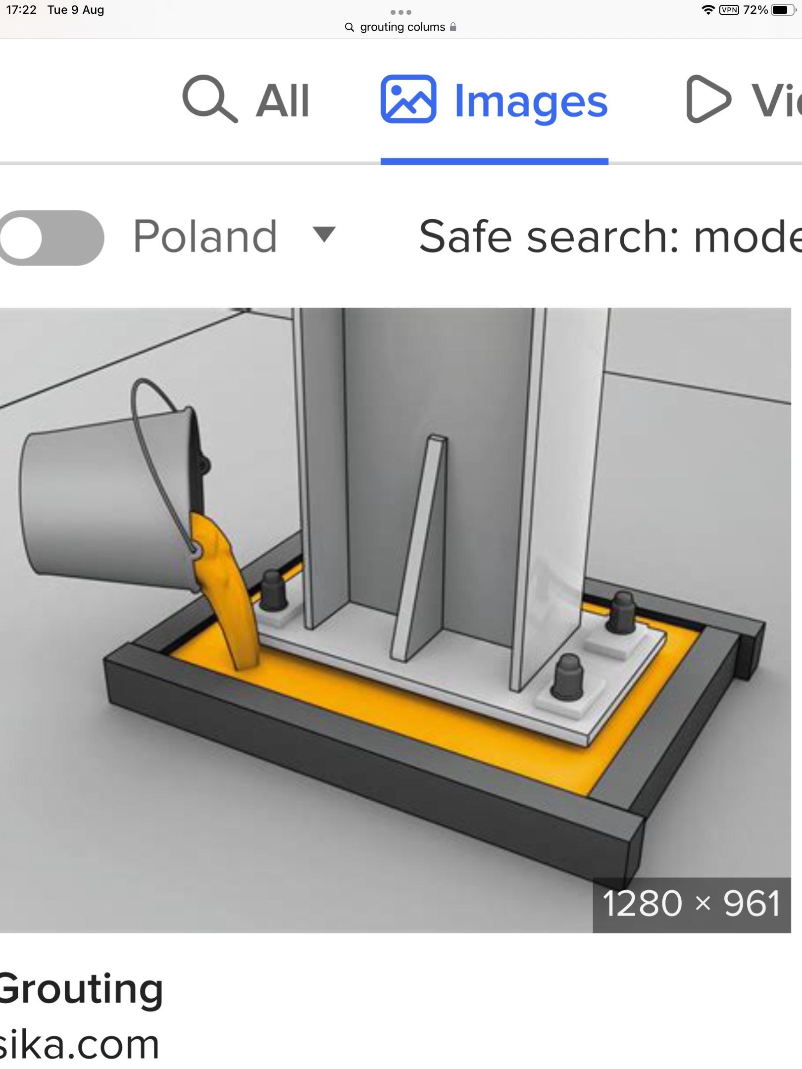

markc Posted August 9, 2022 Share Posted August 9, 2022 8 minutes ago, eandg said: This is a job I'm going to need to grapple with shortly. If in doubt, get the brickie out to do it? For a baseplate that's 240x240 what dimensions should the grout be? Thanks. Grout just has to fill the void under the plate. Use sand or mud to build a dam around the plate with an inch or so extra then when you pour the grout it can fully fill the void without trapping air , fill up to top of plate and the extra reservoir will account for any settling. Link to comment Share on other sites More sharing options...
eandg Posted August 9, 2022 Share Posted August 9, 2022 6 minutes ago, markc said: Grout just has to fill the void under the plate. Use sand or mud to build a dam around the plate with an inch or so extra then when you pour the grout it can fully fill the void without trapping air , fill up to top of plate and the extra reservoir will account for any settling. Thanks - so dimensions/positions need to be bang on? Link to comment Share on other sites More sharing options...
markc Posted August 9, 2022 Share Posted August 9, 2022 2 minutes ago, eandg said: Thanks - so dimensions/positions need to be bang on? No, unless it’s going to be on show then you batter the edges etc to make it neat Link to comment Share on other sites More sharing options...
markc Posted August 9, 2022 Share Posted August 9, 2022 Link to comment Share on other sites More sharing options...
markc Posted August 9, 2022 Share Posted August 9, 2022 If not seen then size and shape of the dam/shutter can be anything Link to comment Share on other sites More sharing options...
eandg Posted August 9, 2022 Share Posted August 9, 2022 4 minutes ago, markc said: If not seen then size and shape of the dam/shutter can be anything Won't be seen as screeding over the top. Only issue would be potential impact on the sole plate around it if it's oversized? Will need to speak with kit company to see if that causes a problem. Link to comment Share on other sites More sharing options...
Mr Punter Posted August 9, 2022 Share Posted August 9, 2022 38 minutes ago, eandg said: For a baseplate that's 240x240 what dimensions should the grout be? Thanks. Make a frame using 2"x2". Cut 2 lengths at 290mm and 2 at 360mm. Fix the longer pieces to the ends of the shorter ones with 80mm screws. Offset the frame with a couple of blocks and pour the grout slowly into the offset bit until you can see it coming out all round. Take the frame off the next day. Should look like this: 1 Link to comment Share on other sites More sharing options...
