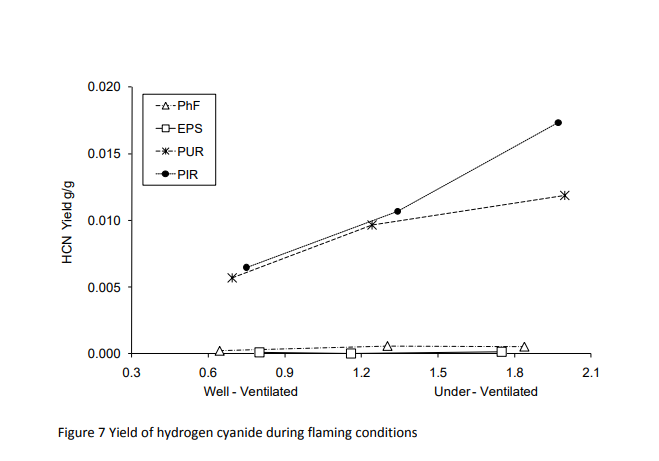

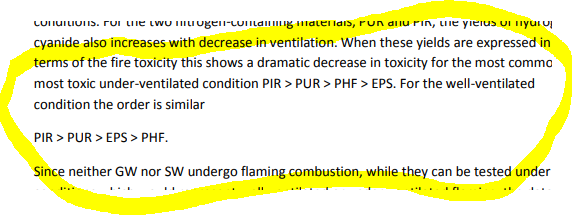

Gordo Posted October 31, 2021 Share Posted October 31, 2021 (edited) Yeah not a fan of PUR insulation. Toxic chemical soup that I understand of gasses of concern to hyper allergenic people (sick building syndrome) and definitely shrinks over time, performance drips over time. In a fire it gives of very toxic smoke. Anyone in authority talks about it gets bought off or sued. Glenfell tells you all you need to know about how much you can rely on their declarations. Edited October 31, 2021 by Gordo Link to comment Share on other sites More sharing options...
Marvin Posted October 31, 2021 Share Posted October 31, 2021 22 minutes ago, Iceverge said: While you're at it can you offer a robust way of keeping rodents out of the PIR also if you have a free cavity? All fine and well in a new blockhouse with no gaps in the mortar. No so for old stone walls. The only way I know to stop rodents entering a building is to have it completely covered in something that they cannot chew through and keep holes no bigger than about 10mm. A lot of pipes through walls are not properly sealed around. Link to comment Share on other sites More sharing options...
Marvin Posted October 31, 2021 Share Posted October 31, 2021 22 minutes ago, Gordo said: Yeah not a fan of PUR insulation. Toxic chemical soup that I understand of gasses of concern to hyper allergenic people (sick building syndrome) and definitely shrinks over time, performance drips over time. In a fire it gives of very toxic smoke. Anyone in authority talks about it gets bought off or sued. Glenfell tells you all you need to know about how much you can rely on their declarations. I understood that most people who die in fires die from smoke inhalation- thank goodness. Link to comment Share on other sites More sharing options...
Gordo Posted October 31, 2021 Share Posted October 31, 2021 1 minute ago, Marvin said: I understood that most people who die in fires die from smoke inhalation- thank goodness. That is a undisputed fact. Link to comment Share on other sites More sharing options...

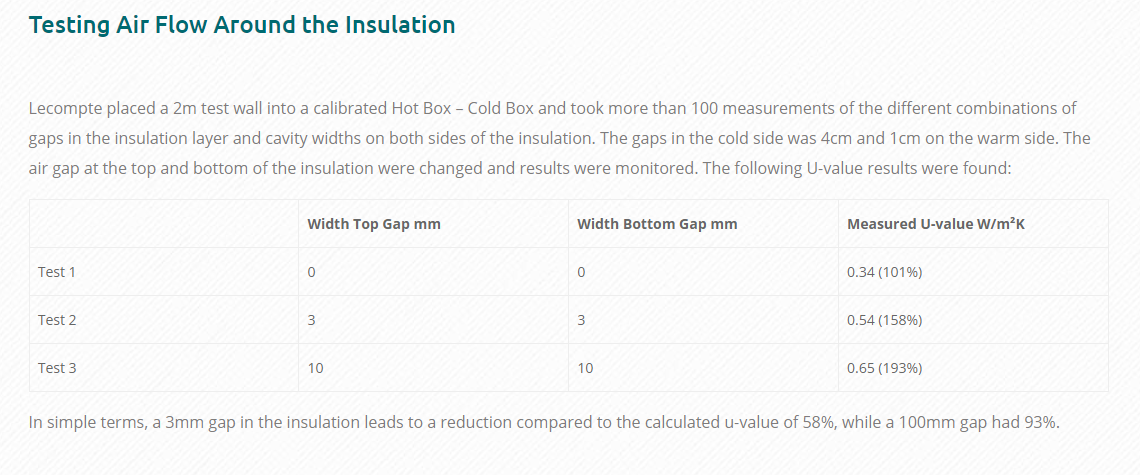

saveasteading Posted November 1, 2021 Author Share Posted November 1, 2021 4 hours ago, Iceverge said: 3mm gap reduced U value from 0.34 to 0.54. ouch. can we even fit it without 1mm gaps? Link to comment Share on other sites More sharing options...
Gordo Posted November 1, 2021 Share Posted November 1, 2021 9 hours ago, saveasteading said: ouch. can we even fit it without 1mm gaps? Gaps and thermal loops are a huge concern that few give adequate consideration to. Sealed gaps are your U value friend. Link to comment Share on other sites More sharing options...

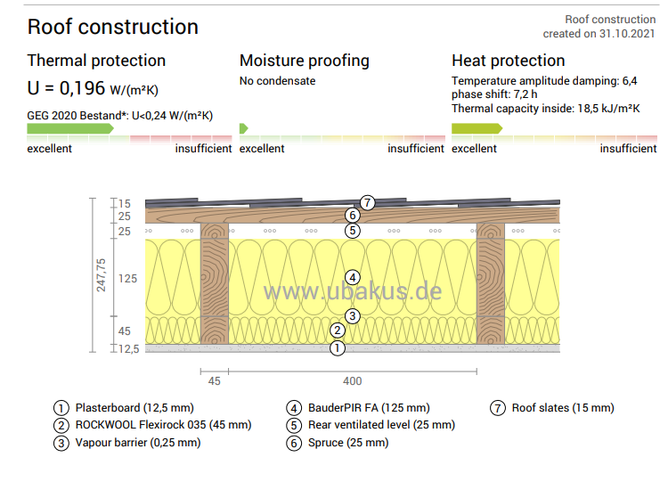

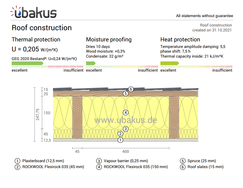

saveasteading Posted November 1, 2021 Author Share Posted November 1, 2021 Ok, so it didn't take much persuasion to get me to reconsider mineral wool instead of PIR. My original plan was to use cavity wall batts, especially as they are waterproof, would completely fill the gaps between rafters and would be easy to cut and fit. Against it? not such a good U value, although it doesn't shrink. wastage will be bad with cutting to fit 390-410mm gaps. Also a lot of batts have developed form dense to rather loose, and almost like loft insulation, and I somewhat doubt the performance. (No names but I have found that the cheapest fibreglass needs a lot of puffing to get to theoretical thickness, and just doesn't look 'right'. Considering filling between rafters in the existing roof, with sarking boards 200 wide and penny gaps, slates above but no vapour barrier.........does this really need an air gap? My logic is that any drips getting in the gap will as easily evaporate again, whether running down a 25mm space or sitting on the tightly placed surface. Link to comment Share on other sites More sharing options...
ProDave Posted November 1, 2021 Share Posted November 1, 2021 37 minutes ago, saveasteading said: Against it? not such a good U value, although it doesn't shrink. wastage will be bad with cutting to fit 390-410mm gaps. Consider what I used, Frametherm 35 on a 1200mm roll, should do your cuts with little waste. Stiff enough to remain in place without slumping, I had one test piece left there for 6 months before getting covered and it did not budge. Mineral wool has the advantage of longer decrement delay, which basically means it takes longer for the building to warm up or cool down in response to a temperature change. Link to comment Share on other sites More sharing options...
saveasteading Posted November 1, 2021 Author Share Posted November 1, 2021 9 minutes ago, ProDave said: longer decrement delay Which I do appreciate will be good in the traditional hot week in August, especially where we plan to have metal cladding instead of slates. If I was to mention decrement do you think the BCO will understand? We have bought samples of PIR and Knauf batt and tried them for practicality. both ok, and will maybe get a bit of Frametherm to try too. I'm a bit confused as I think I have seen some of your photos showing PIR. What is the construction here? frametherm tight up to osb? You will have a VB above the osb, which we won't., as the rafters, sarking and slates are already there. Link to comment Share on other sites More sharing options...
ProDave Posted November 1, 2021 Share Posted November 1, 2021 8 minutes ago, saveasteading said: I'm a bit confused as I think I have seen some of your photos showing PIR. What is the construction here? frametherm tight up to osb? You will have a VB above the osb, which we won't., as the rafters, sarking and slates are already there. Very little PIR in this build, the only place is under the bathroom UFH. Roof, from outside to in, tiles battens counter battens breathable membrane 100mm wood fibre board 195mm thick rafters full filled with Frametherm 35 13mm OSB Air tight membrane taped 25mm battened service void Plasterboard. 1 Link to comment Share on other sites More sharing options...
ADLIan Posted November 1, 2021 Share Posted November 1, 2021 3 hours ago, saveasteading said: Ok, so it didn't take much persuasion to get me to reconsider mineral wool instead of PIR. My original plan was to use cavity wall batts, especially as they are waterproof, would completely fill the gaps between rafters and would be easy to cut and fit. Against it? not such a good U value, although it doesn't shrink. wastage will be bad with cutting to fit 390-410mm gaps. Also a lot of batts have developed form dense to rather loose, and almost like loft insulation, and I somewhat doubt the performance. (No names but I have found that the cheapest fibreglass needs a lot of puffing to get to theoretical thickness, and just doesn't look 'right'. Considering filling between rafters in the existing roof, with sarking boards 200 wide and penny gaps, slates above but no vapour barrier.........does this really need an air gap? My logic is that any drips getting in the gap will as easily evaporate again, whether running down a 25mm space or sitting on the tightly placed surface. Mineral wool roll or batts with a conductivity o 0.035 W/mK or better are normally rigid enough to be self supporting as ProDave says (to do with density). I think we all know of the fibreglass you refer to - probably made not a millions miles from you!! Link to comment Share on other sites More sharing options...
