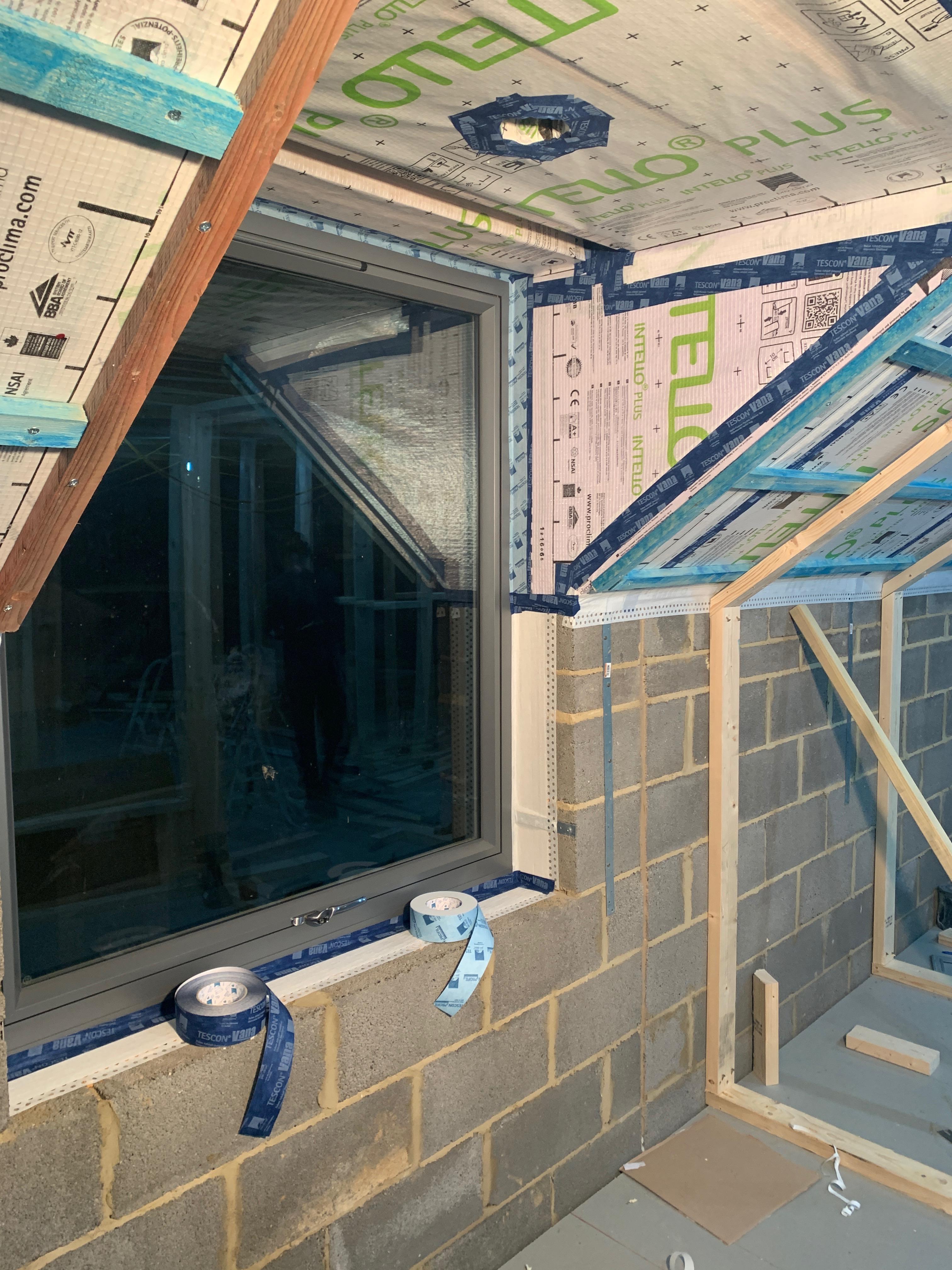

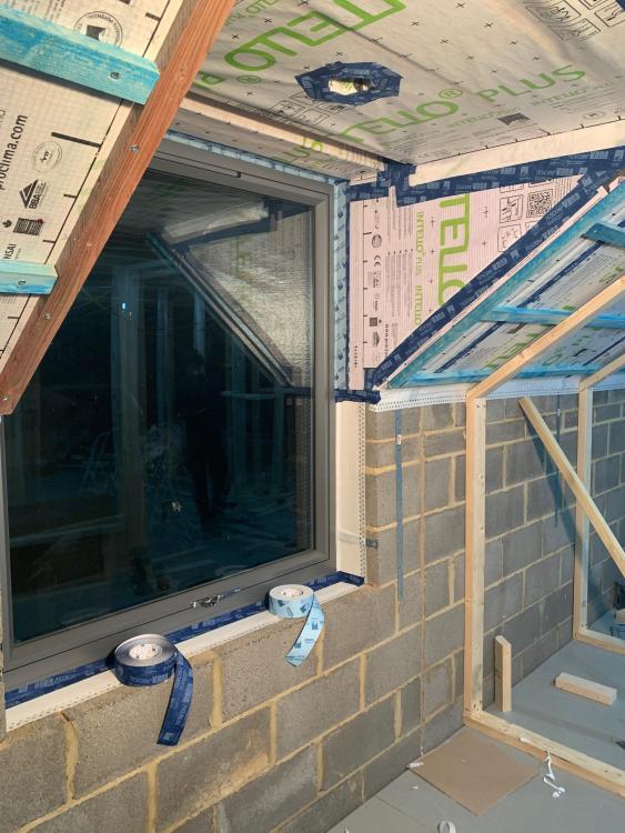

So this is the tape I'm looking at, in the 60mm width. @IcevergeI am sticking either to concrete reveals that were cast three months ago, or in most cases to timber frames. The company selling the tape is hitting me with "You may also need this primer" (https://www.ecologicalbuildingsystems.com/product/tescon-sprimer). Do i, or is this just upselling?
A primer is the correct choice.
Tapes need a dry and very importantly dust free surface to stick to. Masonry is rarely this without a primer.
Yeh, always on concrete or any similar substrates, I would apply that primer too.
So primer on the concrete, but not on the aluminium window frame, correct?
 What about on plywood?
The concrete will obviously be dusty and porous, so the adhesion levels will not be as great as say on your aluminium.  I just solvent washed/cleaned before application of this tape and its sticks very well. I did though, after taping up all of my windows, apply a liquid air tightness paint product to ensure it was properly sealed.  Belt and braces.
