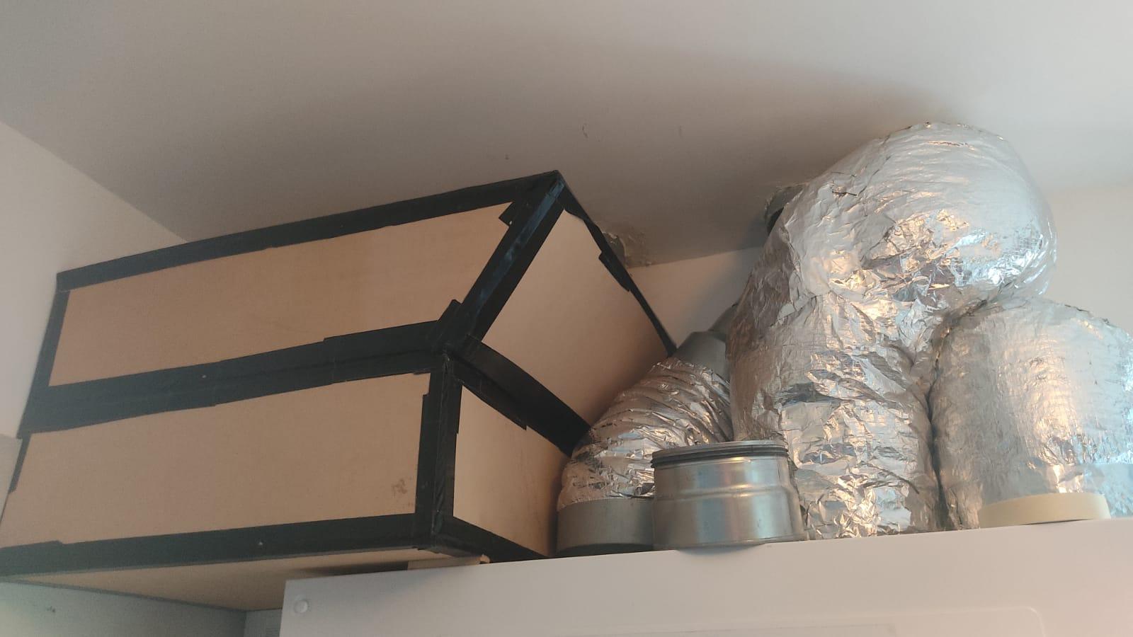

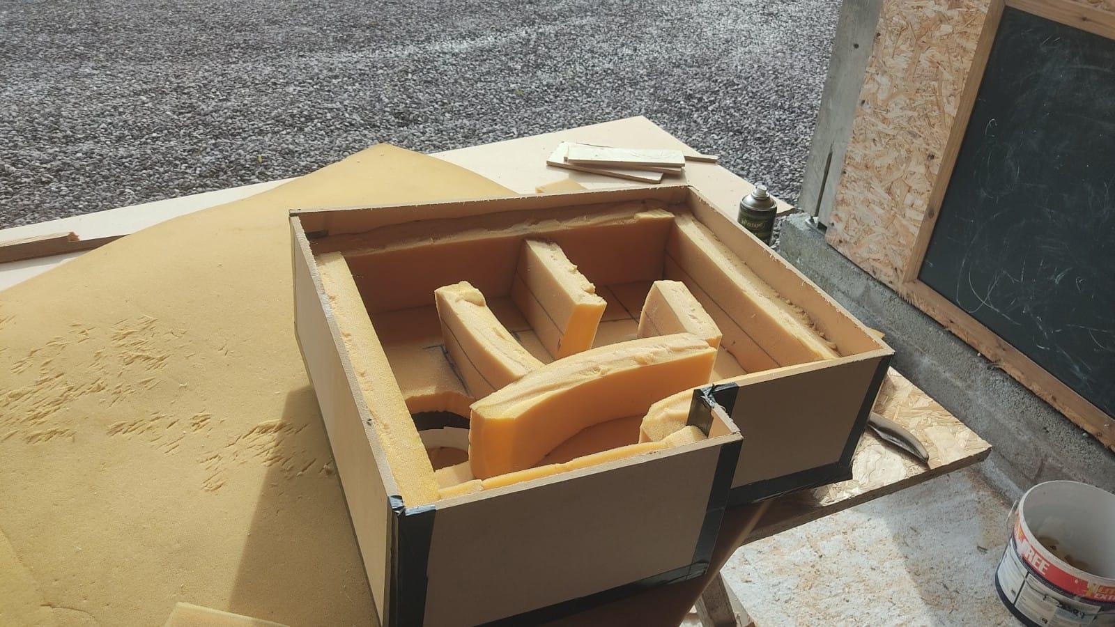

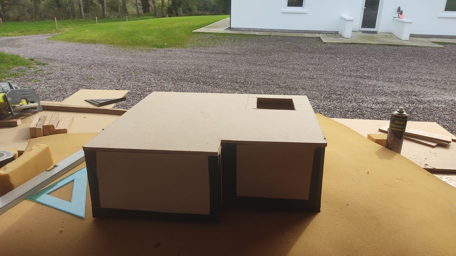

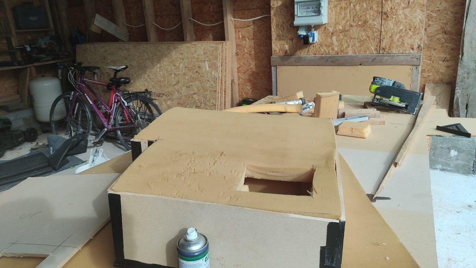

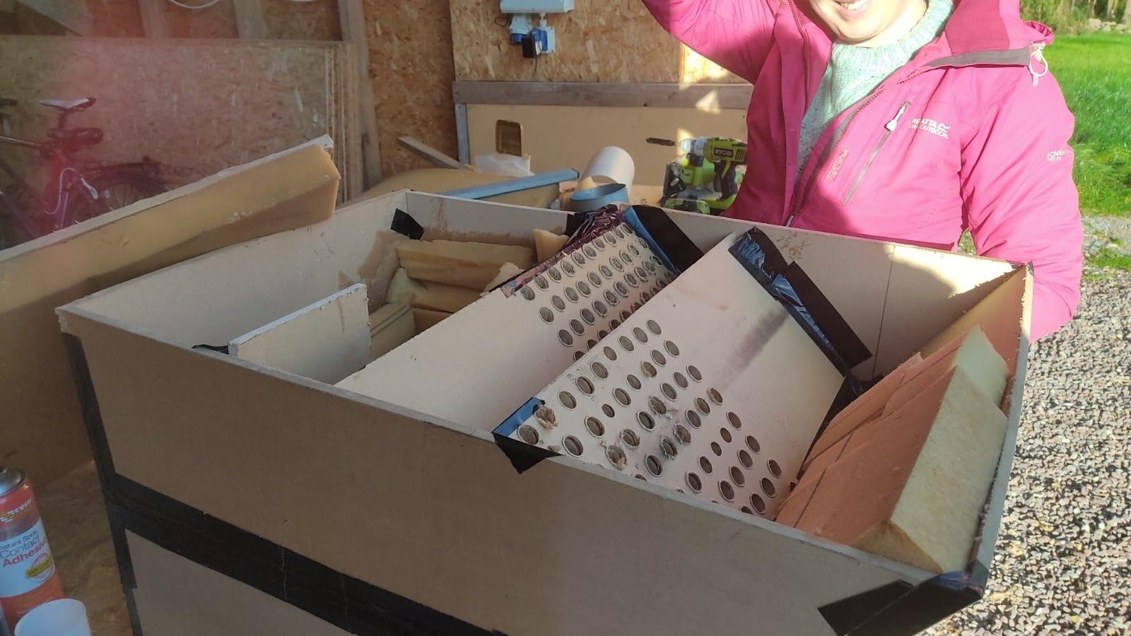

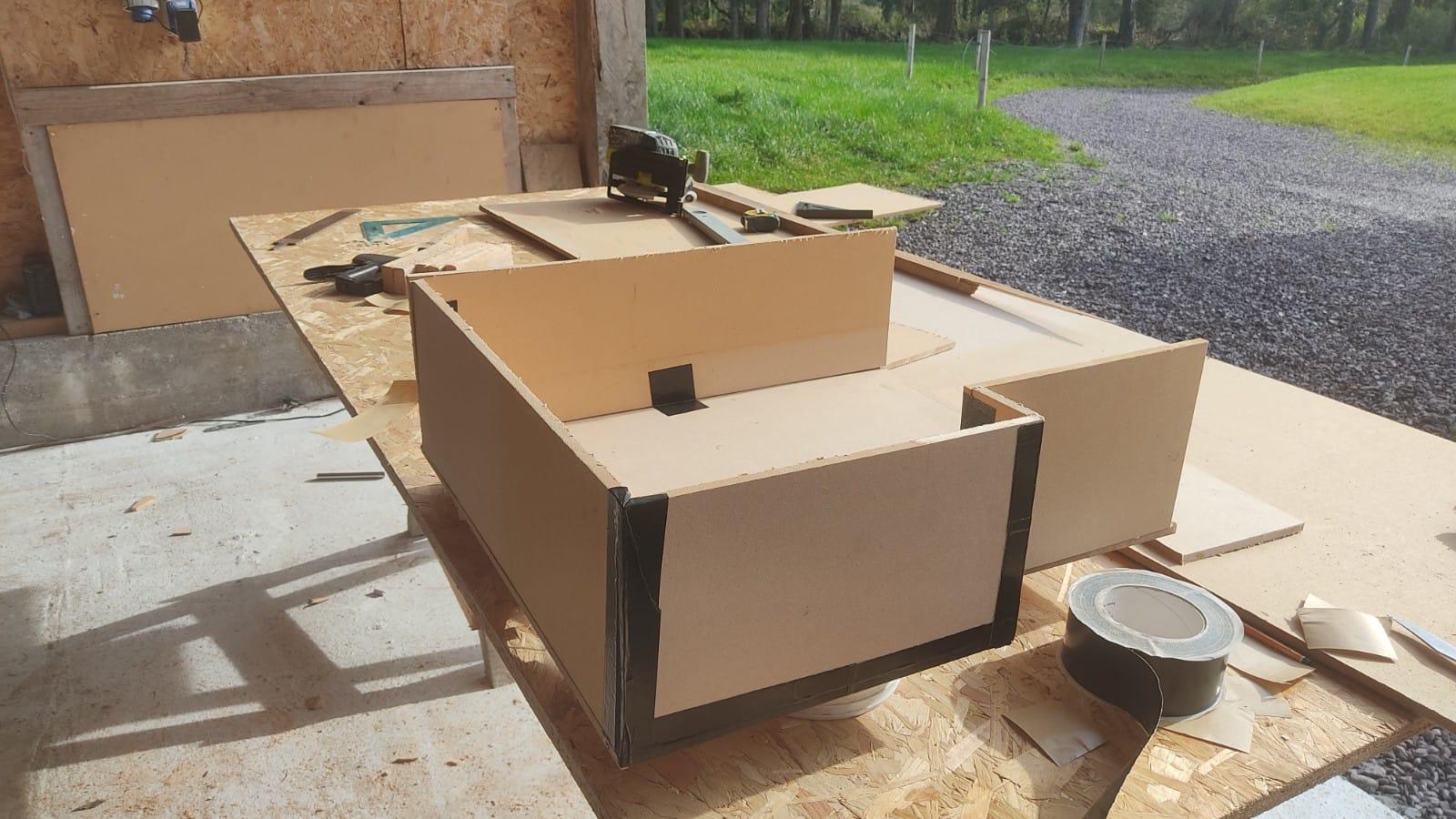

Iceverge Posted October 21, 2021 Share Posted October 21, 2021 We're in now with 7 months. I've never been chuffed at the noise of the MVHR at night in the bedrooms. We had a flexible acoustic silencer from BPC but it's been of limited value so I decided to rig my own scrappy attempt. Firstly it's in an awkward corner so I had to go for an irregular shape. MDF and airtight tape was the order of the day. Some discarded foam formed the maze for the air to transit through the first level. All held in place with spray adhesive. You can see the entry hole at the left of the box. Capped with another layer of foam. And a sheet of MDF all taped up shortly afterwards. A hole for the air to enter the second layer. The second story was a little different. I drilled 160 18mm holes (yawn, boring!) and offset them to try and diffuse the noise a little. The first layer seemed good at getting rid of the 375Hz and 7500Hz noises that my phone recorded but not the 53Hz, after some googling of car exhausts the many small holes method seemed like a good idea. Mostly fingers crossed and little science involved. I shoved it into the corner and connected the ducts up. (Supply enters straight from the top of the MVHR unit and exit is above it in the roof. I might enclose it at some stage if I can be bothered. And hey presto. I took the opportunity to use my iPad to do a sound level recording before and after with the unit on boost. Pretty pleased with that. All we have to do now is enjoy the sweet smell of glue as we drift off into silent slumber tonight. 2 2 Link to comment Share on other sites More sharing options...

Iceverge Posted October 21, 2021 Author Share Posted October 21, 2021 1 hour ago, Stones said: Well done! I made my own silencer for the same reasons as you, and it has proved very effective. Didn't think of the multi holed baffles. Has it reduced air flow at all? I haven't checked. I was careful all along to make sure the sums of the openings added up to equal or greater the 160mm duct area out of the MVHR unit. In any case I doubt it. Flow is only really severely throttled at the terminals. Link to comment Share on other sites More sharing options...

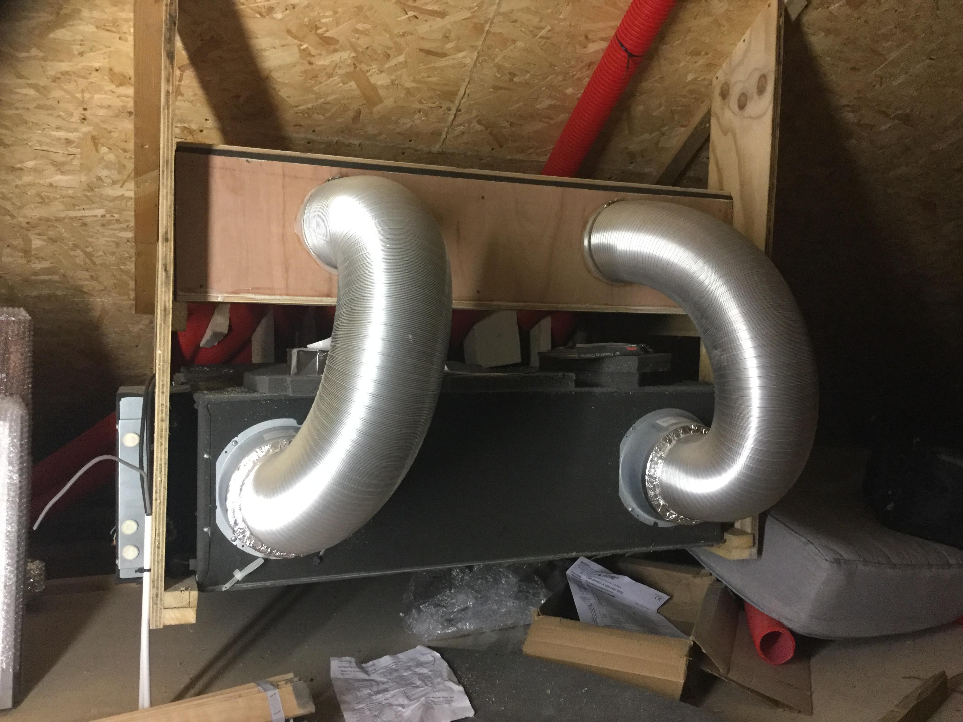

joe90 Posted October 22, 2021 Share Posted October 22, 2021 I too made my own silencer and combined it with the manifold, ply box lined with accoustic foam. 1 Link to comment Share on other sites More sharing options...

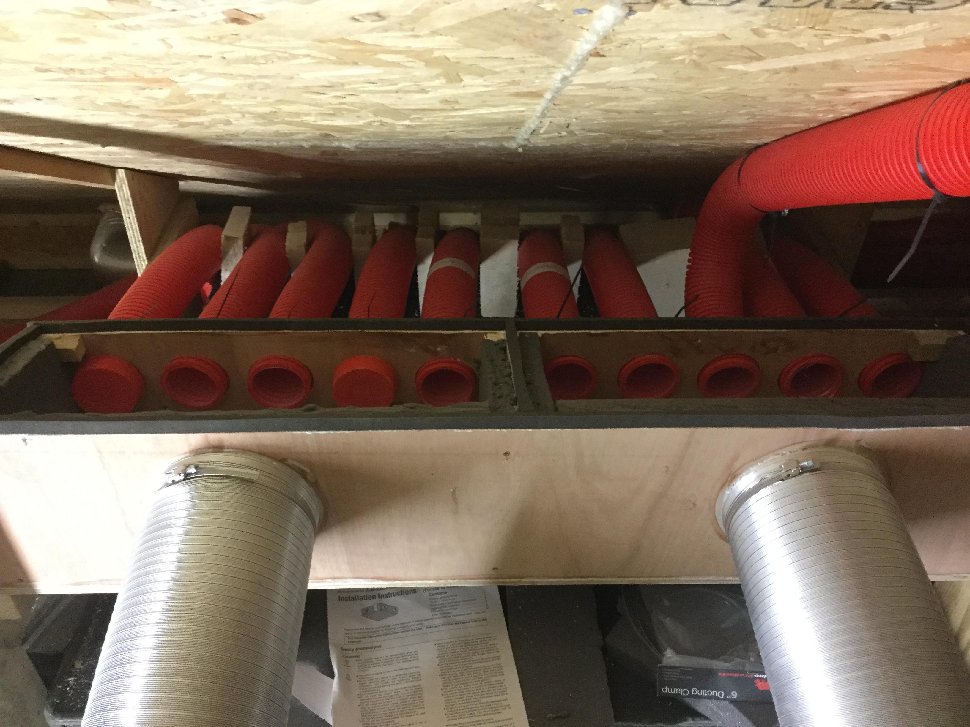

MikeSharp01 Posted July 31, 2022 Share Posted July 31, 2022 On 22/10/2021 at 08:54, joe90 said: I too made my own silencer and combined it with the manifold, ply box lined with accoustic foam. I am just working up the design for my distribution and silencing system - do you have any more details of yours you can share - I think there was a post on e-build about it but that is long gone now. Link to comment Share on other sites More sharing options...
MikeSharp01 Posted July 31, 2022 Share Posted July 31, 2022 I found a pic of @joe90's system here: Link to comment Share on other sites More sharing options...
PeterW Posted July 31, 2022 Share Posted July 31, 2022 On 22/10/2021 at 09:16, Marvin said: so I'm think more on the lines of baffles at the ceiling terminals. Yes built cones of acoustic foam into the ceiling plenums with varied results Link to comment Share on other sites More sharing options...

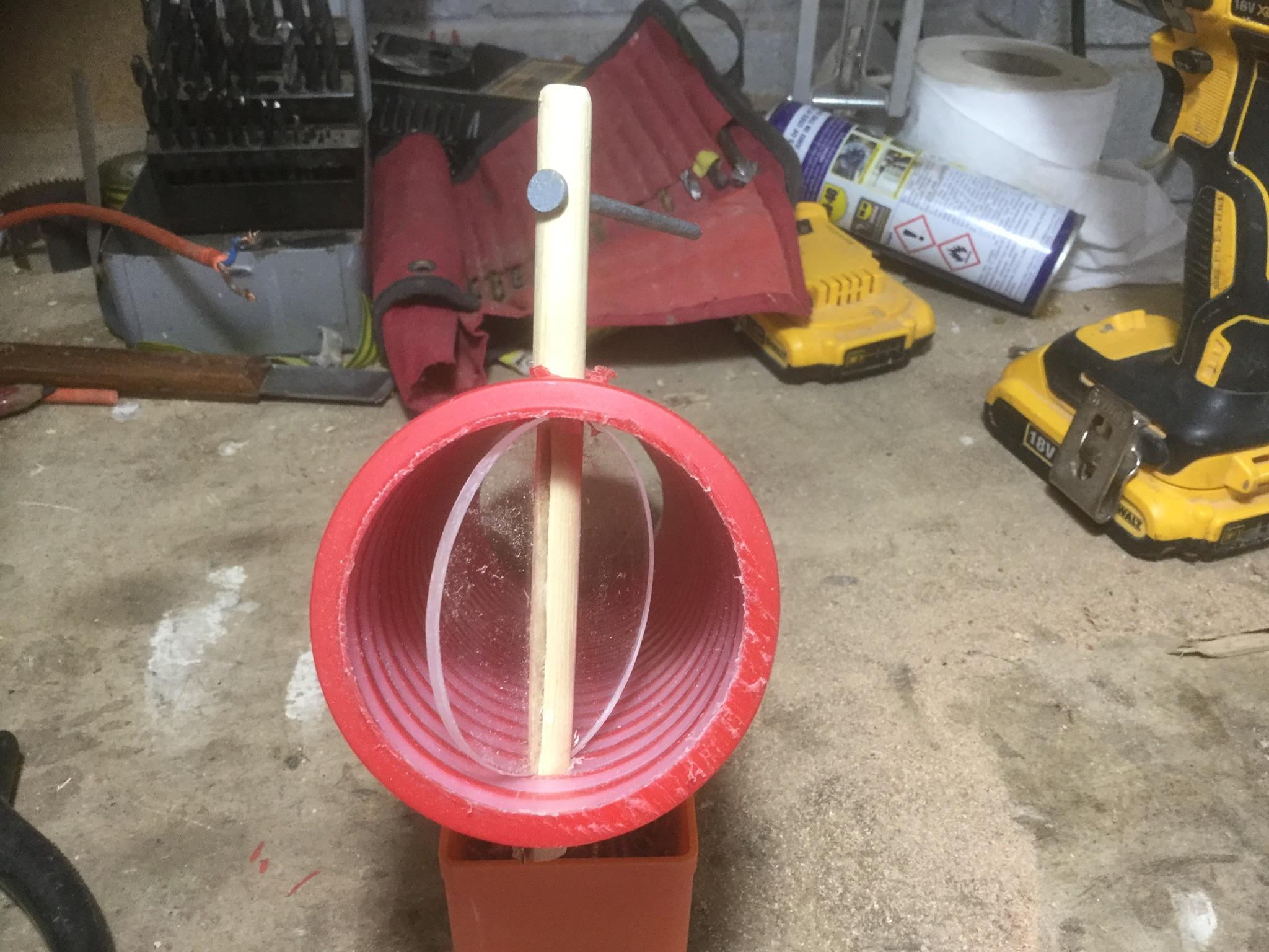

joe90 Posted July 31, 2022 Share Posted July 31, 2022 3 hours ago, MikeSharp01 said: I am just working up the design for my distribution and silencing system - do you have any more details of yours you can share - I think there was a post on e-build about it but that is long gone now. Just a ply box split in half, one side “input” the other “exhaust “. All flexi pipes siliconed into the box, the dampers are really “Heath Robinson “ Perspex discs mounted on dowels and a nail to turn and indicate position. Large pipes into MVHR as the pic. Box lined with sound absorbing foam with baffle to make the air go around the silencer before exiting, foam strip to seal lid when screwed on. Link to comment Share on other sites More sharing options...
MikeSharp01 Posted July 31, 2022 Share Posted July 31, 2022 1 minute ago, joe90 said: Just a ply box split in half, one side “input” the other “exhaust “. All flexi pipes siliconed into the box, the dampers are really “Heath Robinson “ Perspex discs mounted on dowels and a nail to turn and indicate position. Large pipes into MVHR as the pic. Box lined with sound absorbing foam with baffle to make the air go around the silencer before exiting, foam strip to seal lid when screwed on. Thanks Joe, that's very helpful, I was wondering how I was gong to make the dampers work for each of the outlets (inlets depending). 1 Link to comment Share on other sites More sharing options...

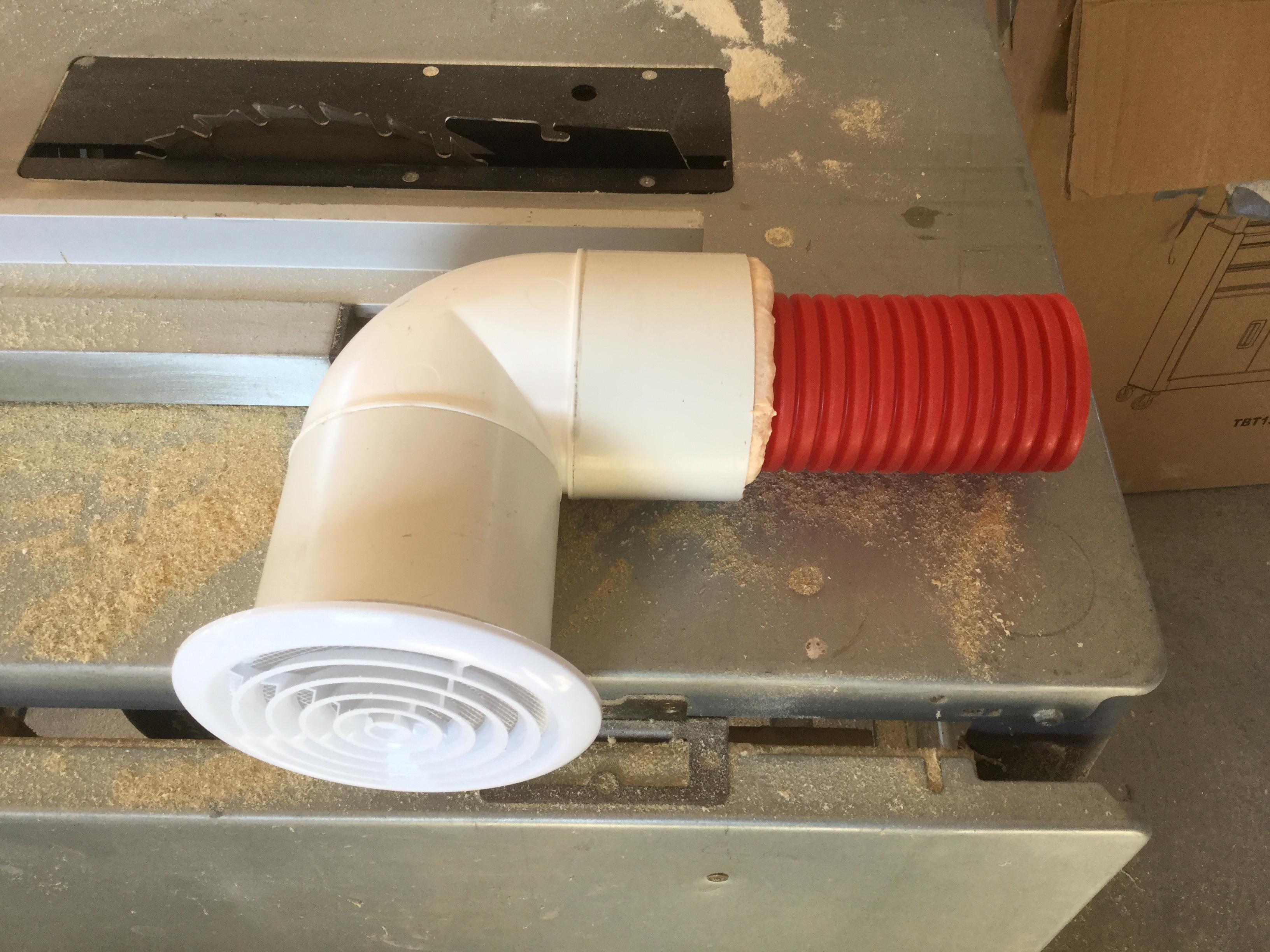

joe90 Posted July 31, 2022 Share Posted July 31, 2022 2 minutes ago, MikeSharp01 said: that's very helpful, I also made my own terminals (cheap skate) but did the throttling at the manifold as some have said the terminals with throttles can make noise in the room, our Jeremy did the same thing 👍 Link to comment Share on other sites More sharing options...
