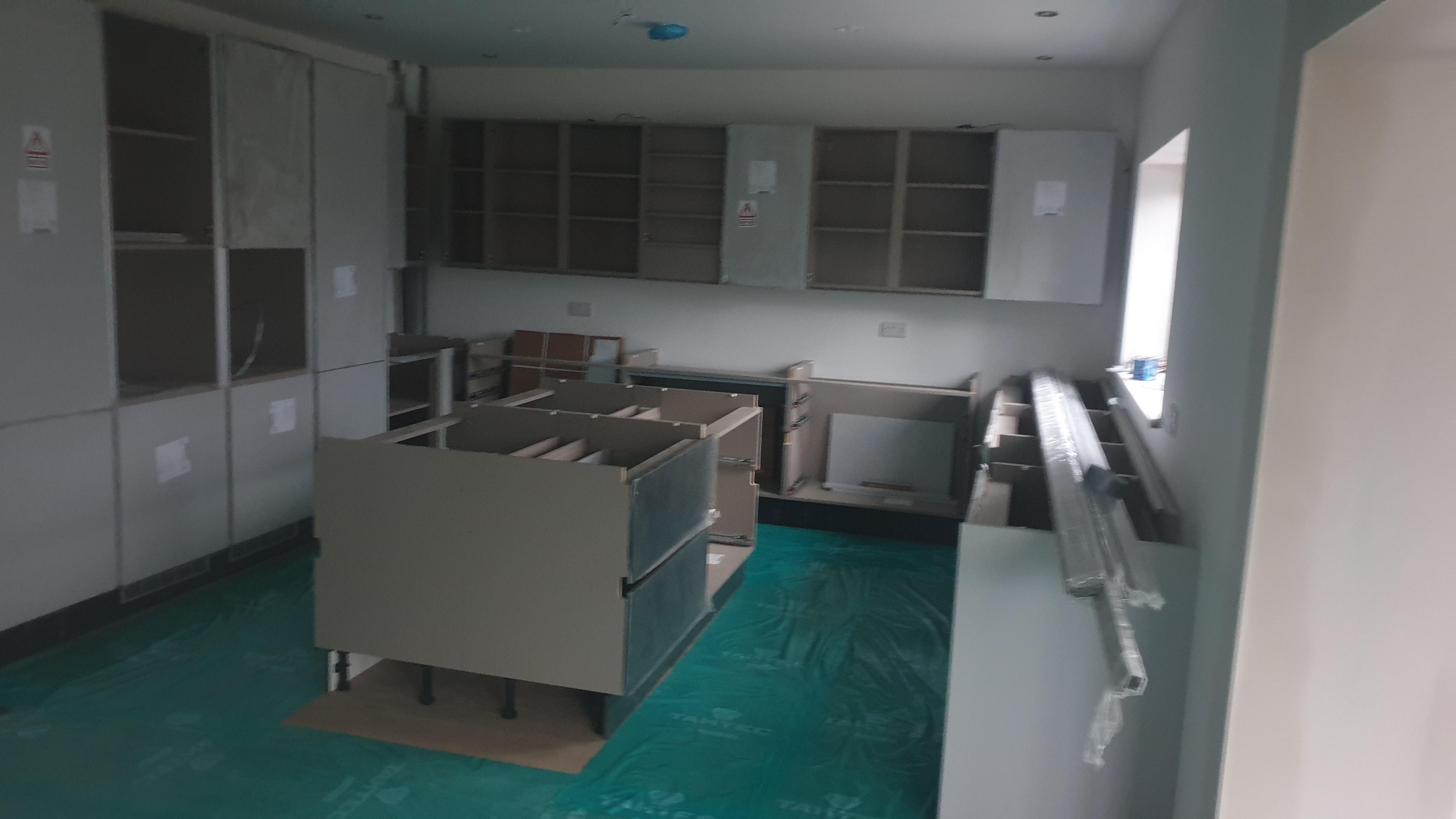

Adsibob Posted October 7, 2021 Posted October 7, 2021 Struggling to find a frost free integrated undercounter freezer. Aside from the supply issues, in that we can probably live without one until Brexit/Covid/Petrol is sorted, the options appear to be: Liebherr IGN1064 - pricy and not a great deal of storage capacity, but nice and quiet at 37dB Liebherr SUIGN1554 - appears to be similar to the above although rated at 35dB John Lewis JLBIUCFZ03 - cheaper and slightly more storage but 43dB and one review on the JL website described it as very noisy AEG ABE682F1NF - slightly cheaper than the John Lewis one and also 43dB They layout of our kitchen means we'll be sitting about 2m from the freezer and 1m from the fridge. I've been careful to find a quiet fridge rated at 37dB but that will be a pointless investment if I will hear the freezer. But maybe 2m is enough of a distance that I won't notice a 43dB freezer anymore than a 35dB or 37dB one?

markc Posted October 8, 2021 Posted October 8, 2021 Built-in fridges/freezers and pretty much any appliance is all about the install when it comes to noise. Recently installed a neff unit and it was really noisy, loosened a couple of the screws that were making the side panel act like a drum and then made even quieter with a block of timber stuck behind the kick board to stop that resonating … after that couldn’t hear it at all. 2

Adsibob Posted October 21, 2021 Author Posted October 21, 2021 Hmmm, I’m starting to question my decision to order the AEG instead of the more expensive Liebherr. In end, I got offered a pet good deal on an ex-demo Liebherr (that apparently hasn’t been demo’ed - not sure how that works) which meant it was only £220 more than the AEG, but SWMBO pointed out that the Liebherr has a tiny amount of storage compared to the AEG. The AEG I bought was advertised as 41db, though I see the same model being advertised as 43dB elsewhere. Ultimately it will be going under 30mm of Caesarstone and tucked snug between a pull out unit on its right and a full height integrated (much quieter) larder fridge on its left, so I hope it won’t be audible from the breakfast bar island some 1.5m to 2m away (depending where on the island we are sitting). i also understand that the noise that these machines make is not constant. They are most noticeable after they are opened and closed and need to lower temp. Any thoughts? Should I cancel the order, go for the Liebherr and fight it out with SWMBO?
markc Posted October 21, 2021 Posted October 21, 2021 Buy or hire a sound meter and go around your house and garden etc. You will be astonished what readings you get. we make regular sound level checks on machines we sell and the results are often baffling. before overthinking and over scrutinising manufacturer figures, get a feel for sound pressure levels
SimonD Posted October 21, 2021 Posted October 21, 2021 It's incredibly difficult to use the appliance ratings to determine exactly how noisy an appliance is going to be when installed in your house because it depends on a number of things. First is that the frequency of the sound makes a big difference to both perception and distance of travel of the sound - e.g. low frequencies travel further than high frequencies. Second is the shape, size and general design of the room together with other background noise. There's also the actual space within which the appliance is installed which can either amplify or attenuate certain problematic frequencies. I spent a few years designing exhaust systems and silencers for motorbikes and in this area it's a bit different because you've got large pressure pulses of hot gas to deal with, but generally it's more important understand the frequency of the sound rather than just the spl as different frequencies will be perceived differently between individuals. As the only way you'll really know is when you've got it installed in a functioning kitchen and house, I'd go for the one that's most practical for your needs and then if the noise is a problem, you can deal with it through some simple acoustic measures. 1 1
