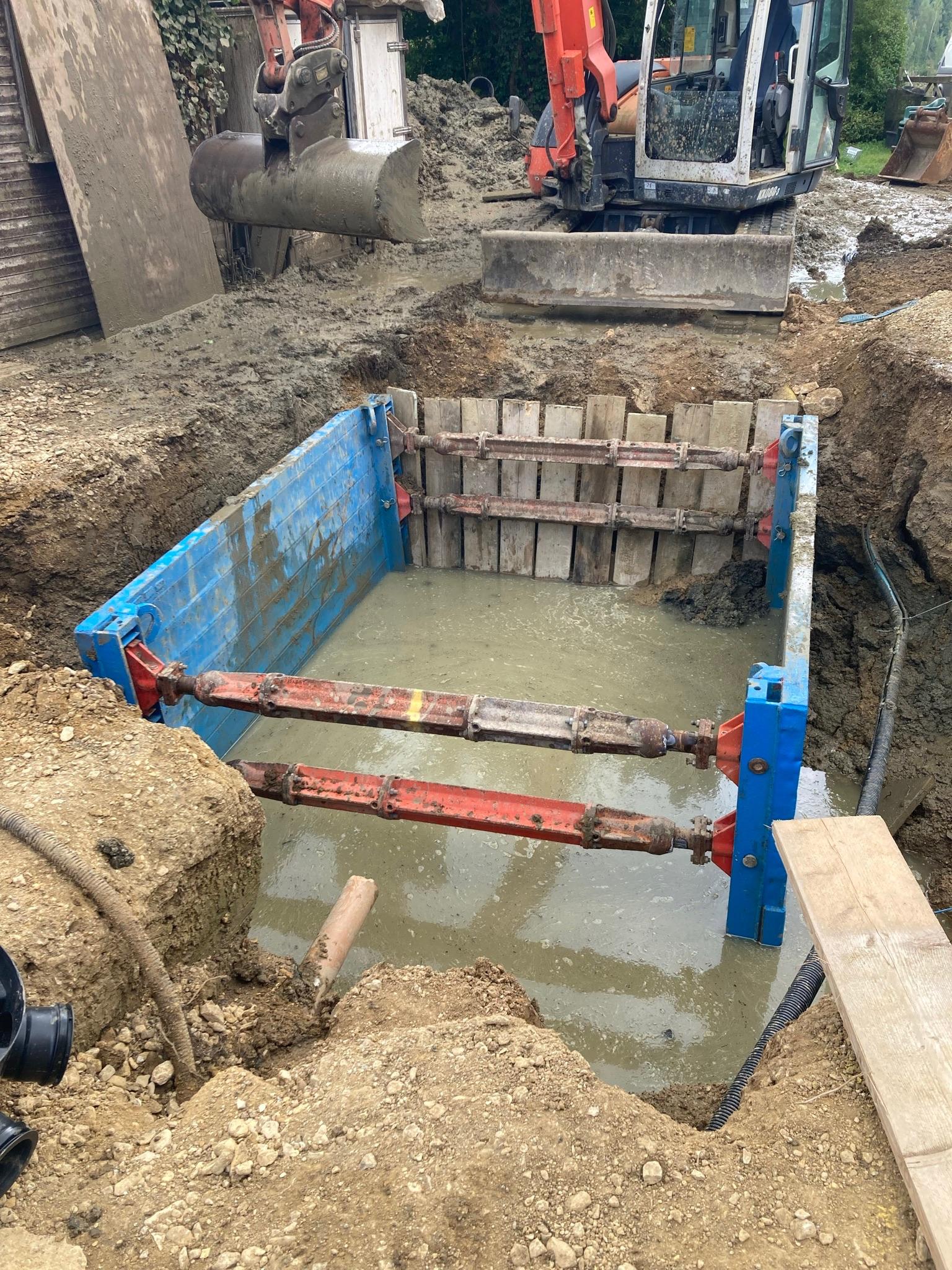

Russell griffiths Posted September 29, 2021 Posted September 29, 2021 Morning I’ve just finished fitting my treatment plant, which turned out to be a major engineering project, the first attempt was abandoned due to high water table and we had to look for some advice and hire in some more kit, it all went according to plan the second time although it was a fight every second of the job, if anybody is dealing with bad ground or high water then shout out I think I’m probably fairly clued up now on a good process. 2 1
ProDave Posted September 29, 2021 Posted September 29, 2021 Oh more photo's and narative please. I assume it was a case of pump the water out, then get the plant and concrete in quick?

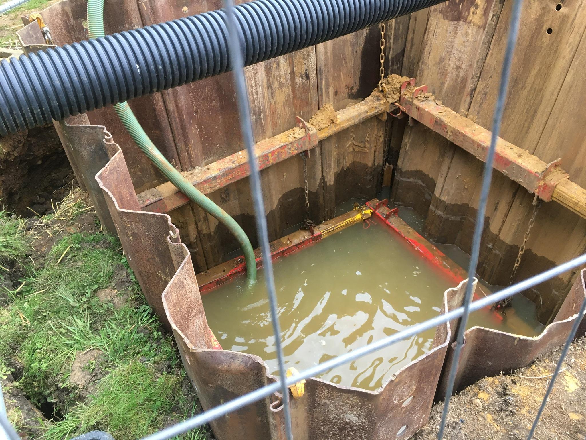

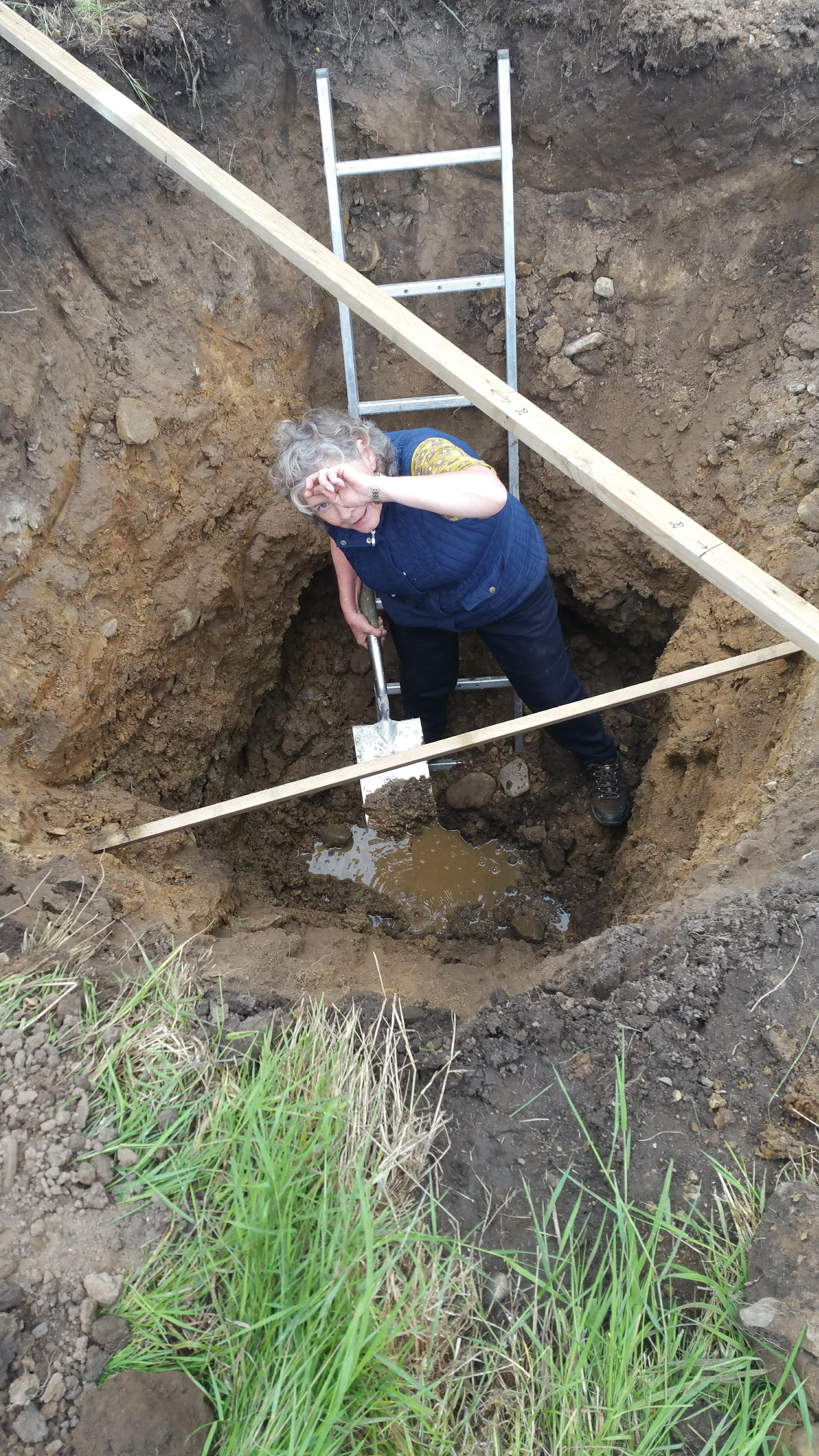

ToughButterCup Posted September 29, 2021 Posted September 29, 2021 Love ya digga man .... I think our water table is similar to yours, but your ground looks problematic. We used wooden shuttering for a while, but I gave up on that: unwise, but we were lucky. Being the courageous man I am, sent SWMBO down the 'ole to see how deep it was ? As you can see, the shuttering was a little on the light side. And I did bring her a cup of tea while she was down there. It was the one job with a digger that truly scared me. Had I used your shuttering system, it would have been so much easier. I chained concrete fence posts to the edge of the tank (to act as ground anchors) , lowered the assembly in, and then concreted the lot in. Years later my shoulders still ache from that job. (Couldn't get a mixer lorry anywhere near it) 1
Russell griffiths Posted September 29, 2021 Author Posted September 29, 2021 1 hour ago, ProDave said: Oh more photo's and narative please. I assume it was a case of pump the water out, then get the plant and concrete in quick? Sort of but not quite. Pumping the water out just caused it to fill back up, 2inch petrol and a 3inch diesel pump flat out kept it out, but if one turned off for a minute it rose a foot in the time it took to fill the tank back up. In the end we pumped it to 150mm deep and installed 2 electric pumps in the bottom. Now the funny bit, I left the electric pumps running as I tipped in the concrete and they where still running when I finished, I then turned them off and cut the power cables, so they are still in the hole at the bottom. ?♂️?♂️ Oh well they where only £75 each so small cost in the grand scheme of things. 1
ProDave Posted September 29, 2021 Posted September 29, 2021 So I take it the shuttering is also now encased in concrete and is another "consumable"?
Conor Posted September 29, 2021 Posted September 29, 2021 Hope you've done your flotation calculations ?
Russell griffiths Posted September 29, 2021 Author Posted September 29, 2021 1 hour ago, ProDave said: So I take it the shuttering is also now encased in concrete and is another "consumable"? No bloody way, that stuff was eye wateringly expensive to buy. All pulled out cleaned and returned to hire depot.

Russell griffiths Posted September 29, 2021 Author Posted September 29, 2021 1 hour ago, Conor said: Hope you've done your flotation calculations ? Fag packet calculations 4500 kg of water in tank 6000kg of concrete. If it floats I eat one of my smelly socks that was in my wellies all week.

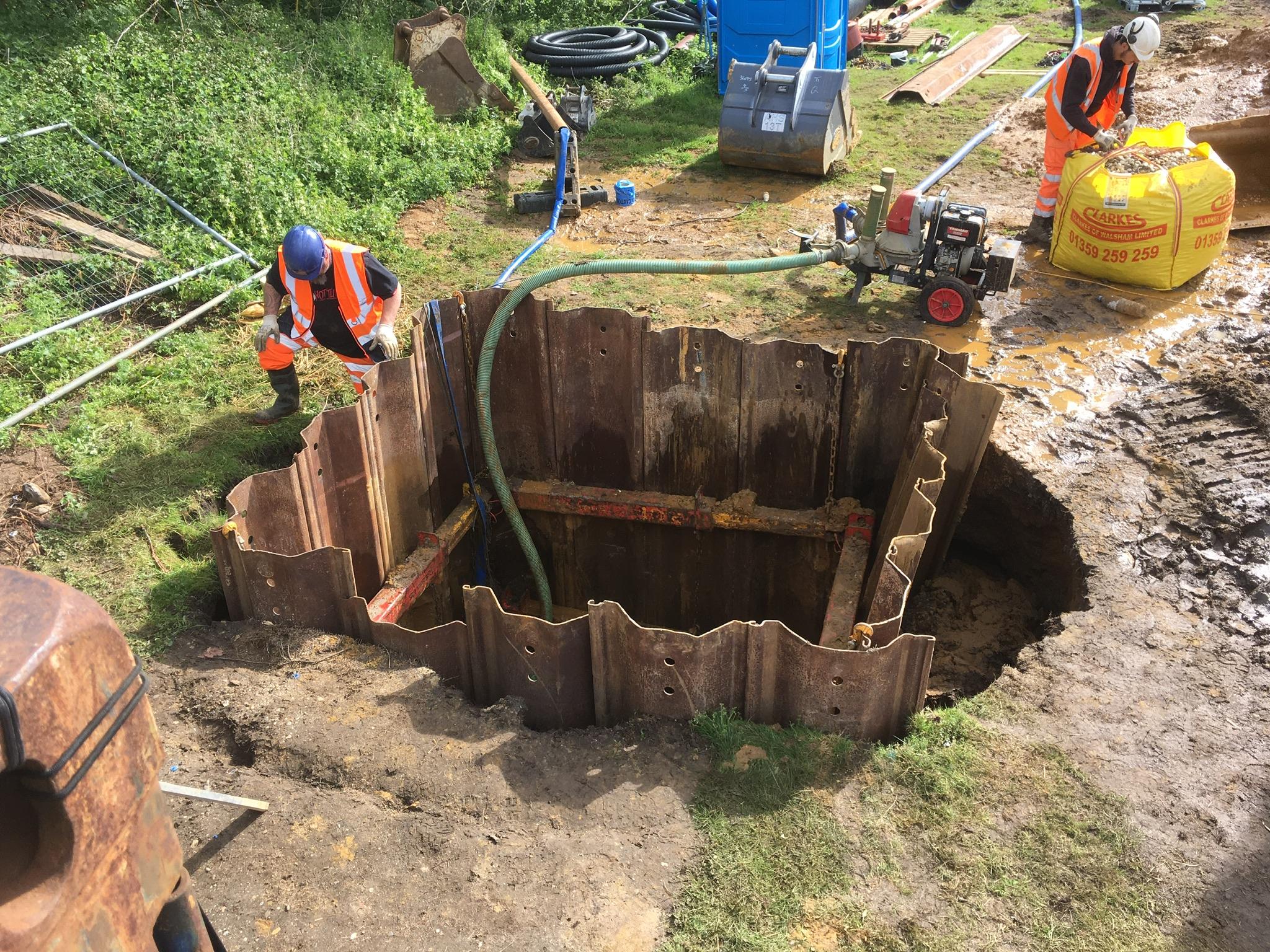

Nick Laslett Posted September 29, 2021 Posted September 29, 2021 These pictures look all to familiar! My ground workers had two attempts at the STP install. High water table and running sand were the problems. First digger didn’t have enough grunt to get the shuttering all the way in. First hole was completely abandoned and a second attempt in a different location with a much larger digger was successful. The first day of the second attempt the digger hydraulics failed! 1
Russell griffiths Posted September 29, 2021 Author Posted September 29, 2021 @Nick Laslett I took my advice from a lad that works in running sand, he gave me the pointers about the trench box, I did consider sheet piles but they would have needed a bigger excavator, like you found out. @Mr Punter water in my hole was lake level, the only good bit is that the water would not normally be there unless you dig a hole, the ground actually drains really well to the lakes, so as soon as you fill the hole in the water finds another way out and the ground firms up very quickly.
DragsterDriver Posted September 29, 2021 Posted September 29, 2021 Ffs did This at the weekend. A Graf sewage plant- ignore the instructions it CAN be wet installed in concrete. I had an absolute fail with sheet piles and a 5 ton digger.
