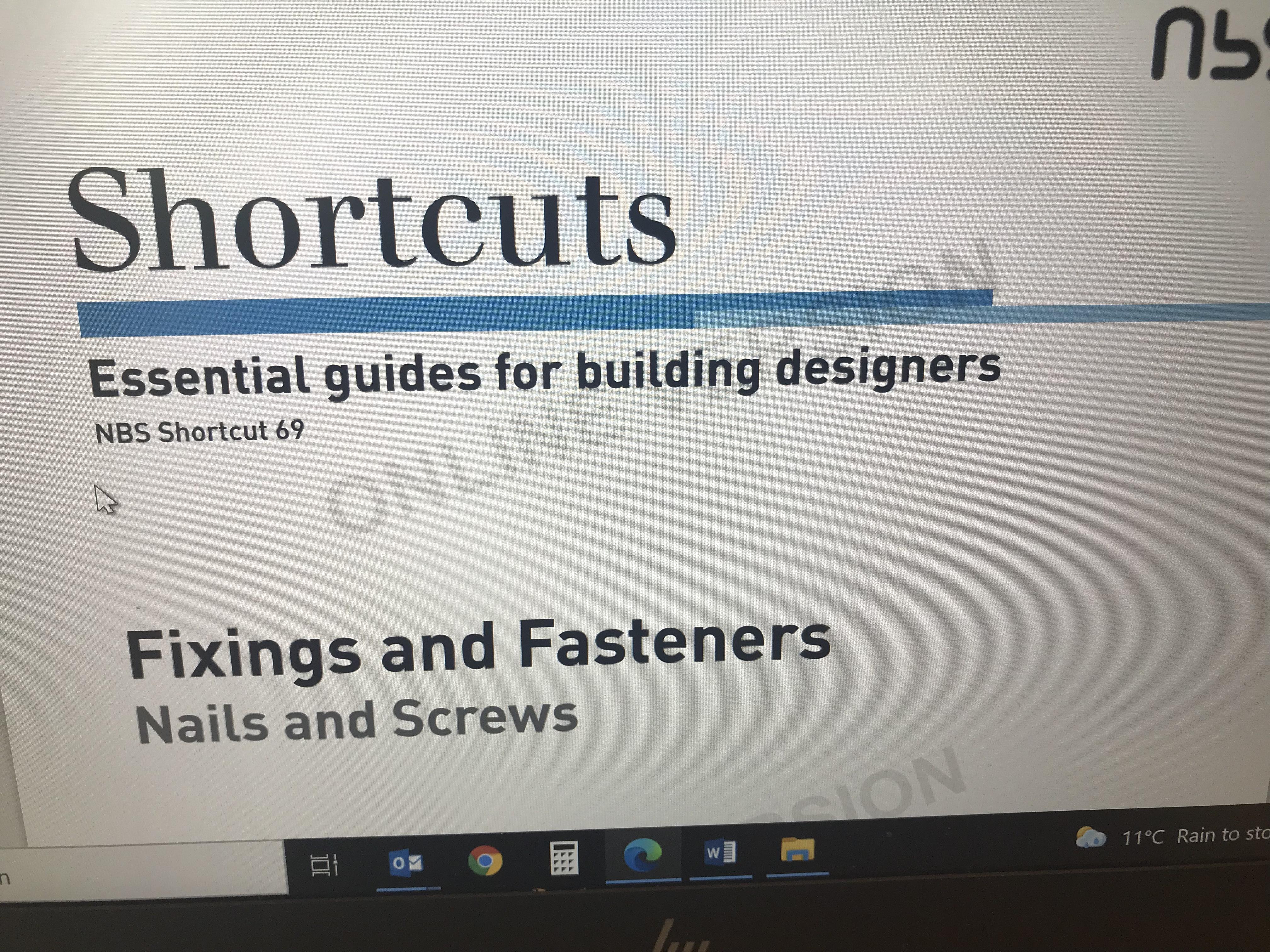

TonyT Posted September 27, 2021 Share Posted September 27, 2021 I’m sure there is a British standard for fixings, pretty sure i remember downloading it before I left the free access to all the standards with my last mob Link to comment Share on other sites More sharing options...

TonyT Posted September 28, 2021 Share Posted September 28, 2021 Link to comment Share on other sites More sharing options...
TonyT Posted September 28, 2021 Share Posted September 28, 2021 This has some info, not sure if its online, taken 5 minutes to uploads the screenshot , not in a good signal area today Link to comment Share on other sites More sharing options...
