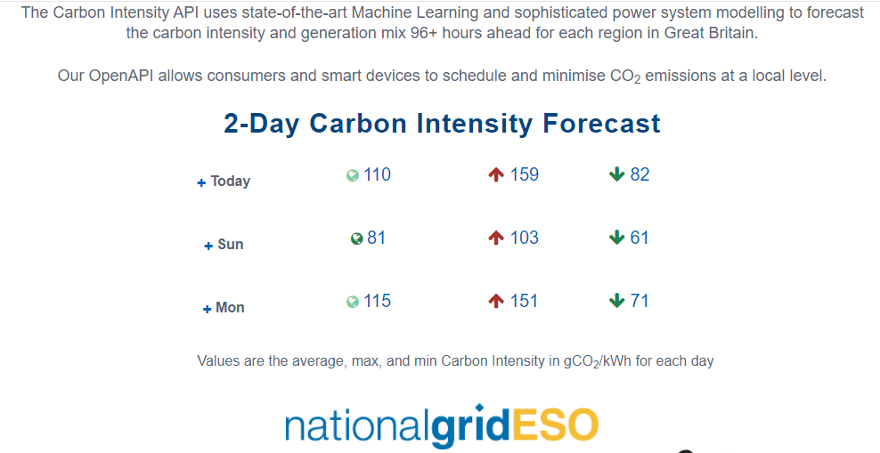

1 hour ago, billt said:
Well, if the grid was supplied by zero carbon energy you might have a point, but as most of it comes from pollution emitting sources, that's not a good argument.
Except the grid is getting cleaner all the time.
Often below 100g/kWh these days. The last year we have full numbers for is 2019 and overall carbon dioxide emissions were 210g/kWh.
Gas boilers are around 200g/kWh.
Gas boilers are not going to get any more efficient, and most don't get close to the laboratory maximum.
So I shall stand by my statement that electricity is the way forward and will be a major contributor to reducing emissions.
We are not electrifying for no scientific reasons at all.
For the past year the grid has been roughly 23% renewable and 17% nuclear, 42% fossil fuels. It is also 7% biomass, but I would argue against its credentials as being low carbon.
The other 10ish percent comes from interconnections which are mainly low carbon from French nuclear, with Norwegian hydro being added.
The renewable percentage will continue to increase and I would expect it to be around 50% in 7 or 8 years, by which point we will be at around 70-80% zero carbon.
