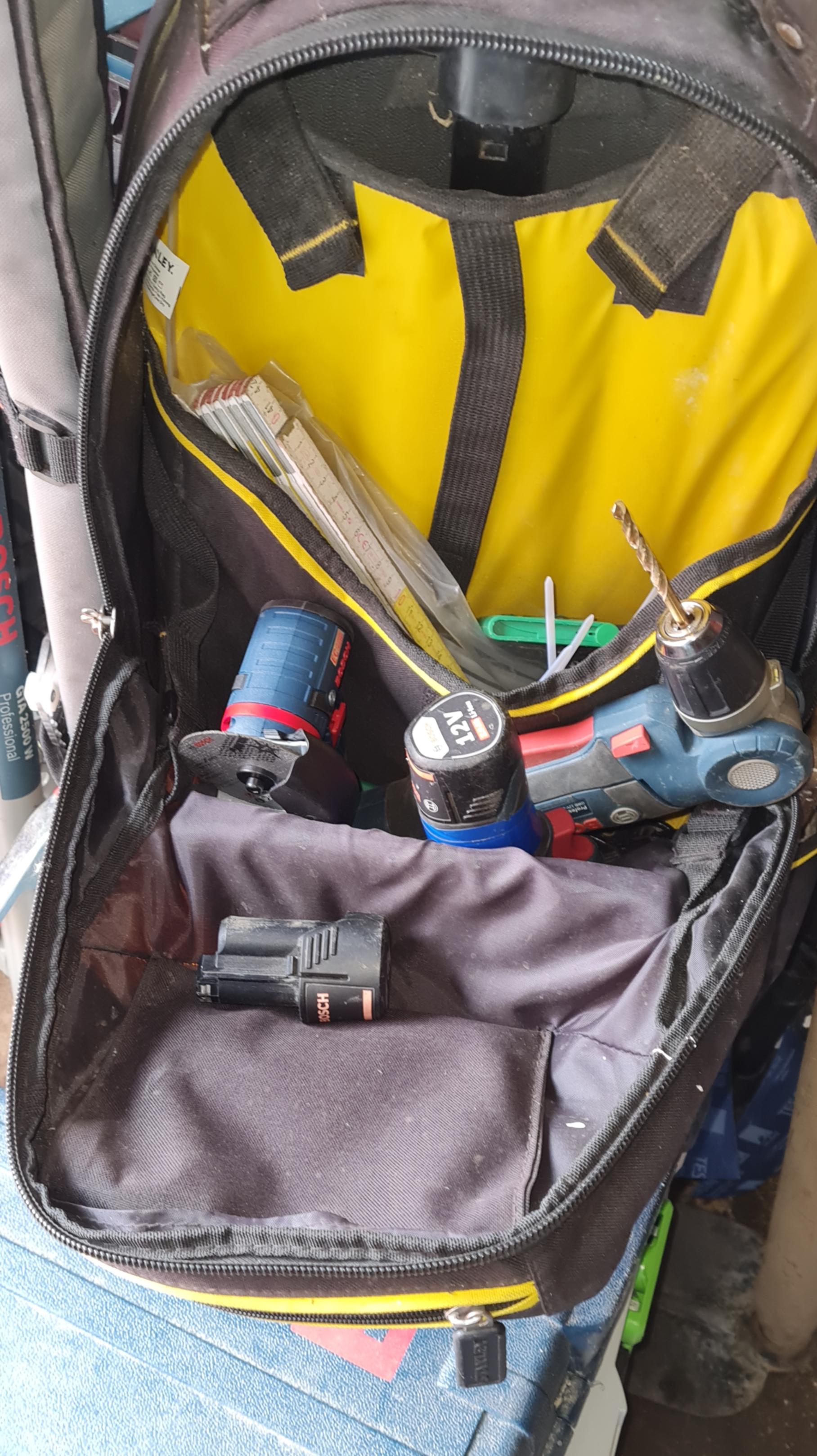

ToughButterCup Posted September 14, 2021 Share Posted September 14, 2021 (edited) To most of you, losing a finger would be a bit of a pain, but if, like me, you've already lost two, then an additional lost digit might be seen as careless. Losing one finger almost always (according to my surgeon) means losing more than one tenth of your grip. That means I've already lost more than a fifth of my grip. An additional loss of an eighth of what's left would be really bad news. Angle grinders should be renamed finger removers . Its the variety in the way they remove fingers that gets me. Look at this. Exhibit1: Innocent little tool bag that I sling on my shoulder every morning as I whistle my way to work. Carole King helps.. '... You got to get up every morning with a smile on your face and show the world (except for plumbers) all the love in your heart then people gonna treat you better, you're gonna find - yes you will - that you're beautiful as you feel ...' Spot the little FingerMincer? Yes, its the mini angle grinder tucked into the corner of the tool bag. Bastard little thing. Reaching absent-mindedly in the bag for a WhatChaMaCall it, I nudge summat (no idea what) and that movement switches the grinder ON. I could not have removed my hand from the tool bag faster from a raging fire. So fast in fact that my arm hits the scaffolding and I now have a bruise that could have been inflicted by an angry Mike Tyson. Wanna a photo? Naaah, too much ugly detail Now the drill is: job done, battery out, pop the grinder in the bag. Brilliant grinder. Just the right size for someone with only four digits on each hand. Vorsprung Durch Fingerentfernung. (finger amputation) Edited September 14, 2021 by ToughButterCup 1 Link to comment Share on other sites More sharing options...

SteamyTea Posted September 15, 2021 Share Posted September 15, 2021 What sort of disc or cutting wheel was on this low powered angle grinder, and was the guard fitted, and to what proportion of the disc was fully exposed to finger inadvertantly touching it, @ToughButterCup has a statistically lower risk advantage here with 2 fingers missing. or just take the (expletive deleted)ing batteries out and put them in a charger. Link to comment Share on other sites More sharing options...
Carrerahill Posted September 15, 2021 Share Posted September 15, 2021 (edited) On 14/09/2021 at 09:56, ToughButterCup said: Now the drill is: job done, battery out, pop the grinder in the bag. Great strategy, but 1 more care point, the battery shorting on something and causing a fire. There are numerous reports of batteries in boxes and bags catching fire when shorting on things like a collection of screwdrivers or steelwool in the case of one plumber who nearly lost his van. I've seen a 2 foot piece of wire in flames in as little as 1-2 seconds after the two ends became lodged in terminals of a 12V battery after being thrown in a toolbox. The house stank for days too. Made me a real advocate of LSF cable too! Edited September 15, 2021 by Carrerahill Link to comment Share on other sites More sharing options...

ToughButterCup Posted September 15, 2021 Author Share Posted September 15, 2021 4 hours ago, Carrerahill said: Great strategy, but 1 more care point, the battery shorting on something and causing a fire. ... The battery type used by 12v Bosch kit has two very thin connection sockets. Lucky that innit... Because you make an excellent point. It was pointed out earlier (last year ?), but your reminder is timely. Link to comment Share on other sites More sharing options...
markocosic Posted September 19, 2021 Share Posted September 19, 2021 A cordless drill with bit and battery fitted taking a detour through your spine would also be unfortunate. Batteries out and rattling around bag for transport on site. Fire is slow. Batteries out of bag when it's in a vehicle! Link to comment Share on other sites More sharing options...
scottishjohn Posted September 21, 2021 Share Posted September 21, 2021 sounds like the grinder does not have enough safety features on the trigger if you can just touch trigger and it fires up no way i could do that with my milwaukee one but yes batteries out when not in use solves it 1 Link to comment Share on other sites More sharing options...
