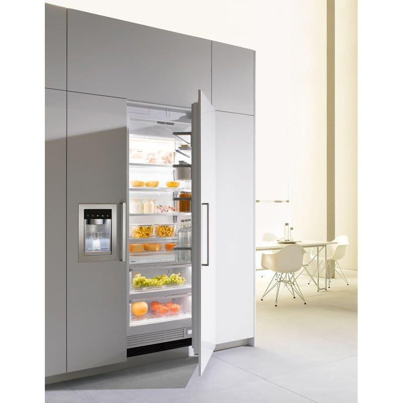

puntloos Posted September 13, 2021 Posted September 13, 2021 (edited) So we really love our american fridge-freezer with an ice and chilled water dispenser.. But we also love built-in things for that smooth look. Anyone aware of a built-in freezer with external ice maker? Miele *used to* make a freezer (and you could match a fridge, as shown below) - the Mastercool F1472vi FWIW, an internal icemaker where you'd have to open the freezer, probably open some drawer is nowhere near as good a solution, but perhaps a stand-alone icemaker could work, but feels somewhat redundant since it'd effectively be a tiny secondary freezer? Or? Edited September 13, 2021 by puntloos

Dan F Posted September 13, 2021 Posted September 13, 2021 17 hours ago, puntloos said: Anyone aware of a built-in freezer with external ice maker? Miele *used to* make a freezer (and you could match a fridge, as shown below) - the Mastercool F1472vi Gaggenau do one: https://www.gaggenau.com/gb/products-list/refrigeration/vario-400-series/freezer/RF463304 AFAIK the Miele, Gaggenau, Liebherr are all the same base product. (all made by Liebherr I think?) I can see the external acess being very practical, expecially if it also crushes ice and provides water, it does impact the amount of space left in the freezer though. 1

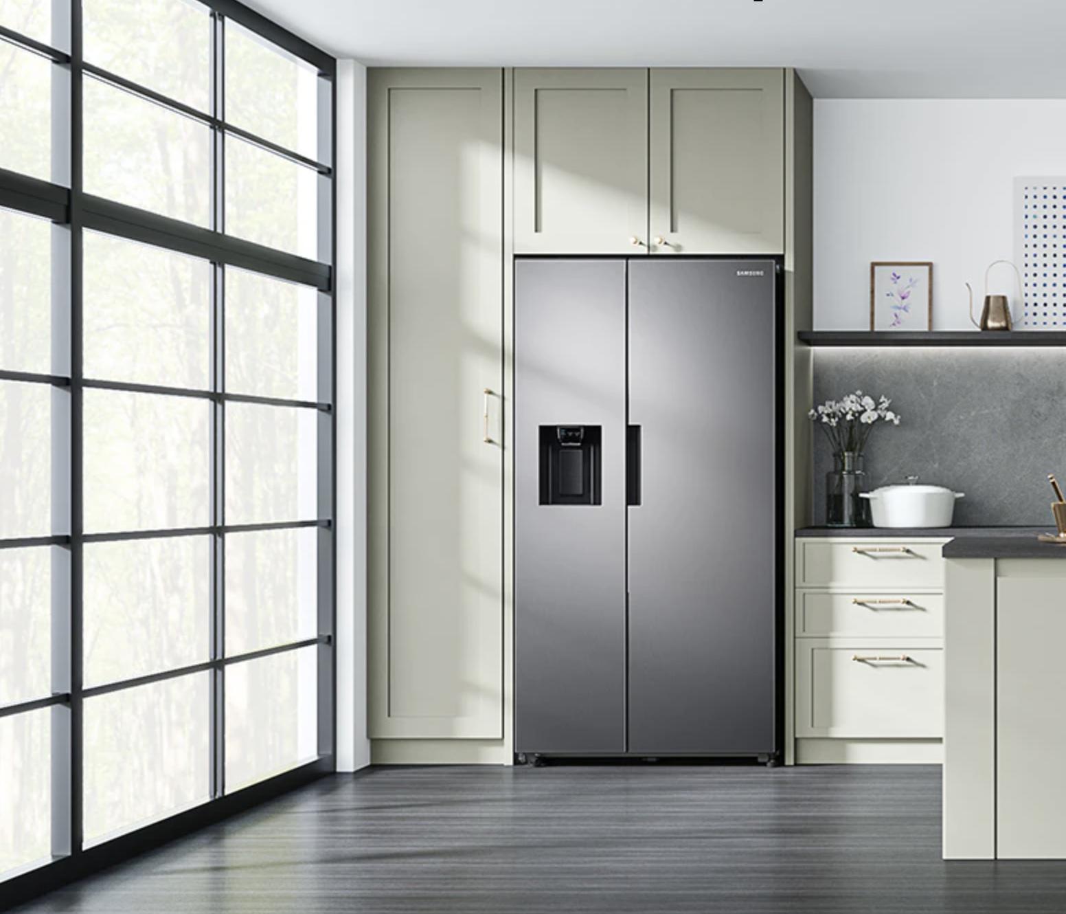

puntloos Posted March 4, 2022 Author Posted March 4, 2022 Revisiting this topic - instead of having a proper built-in fridge with icemaker - which seems to be unattainable - is there some elegant way one can get a standard freestanding american style fridge and 'convert' it into a built-in? Do built-in systems exists where you attach standard cabinet doors in front of it somehow? Or is that a lost cause? As anyone can see looks a lot better than
markc Posted March 4, 2022 Posted March 4, 2022 A built-in appliance is pretty much a free standing without the casing, however fridges and freezers need to loose heat so built ins tend to have larger evaporators because there is less air flow around them. if you ensure the free movement of air then no reason why you can’t build in with a bit of thought and ingenuity to attach door panels etc.
PeterW Posted March 4, 2022 Posted March 4, 2022 5 hours ago, puntloos said: instead of having a proper built-in fridge with icemaker - which seems to be unattainable Miele make one. Or do you want the dispenser out of the front ..? They are available but start at about £5k from what I can see and they are custom doors etc. https://www.miele.co.uk/e/built-in-freezer-fns-37492-ie-10845360-p
puntloos Posted March 4, 2022 Author Posted March 4, 2022 5 hours ago, PeterW said: Miele make one. Or do you want the dispenser out of the front ..? They are available but start at about £5k from what I can see and they are custom doors etc. https://www.miele.co.uk/e/built-in-freezer-fns-37492-ie-10845360-p Well, perhaps I'm micro-optimizing but indeed the dispenser in front is important. My current fridge indeed allows a very quick walk-up, and walk away with chilled or chilled+cubes water in under 5 seconds. Opening the fridge door and trying to get an ice scoop etc is .. less elegant Miele did have this one: https://vietnam.miele-importer.com/en/refrigeration-and-wine-conditioning-units-2497.htm?mat=09059290&name=F_1472_Vi (yes.. vietnam.. ha.. hard to find)
