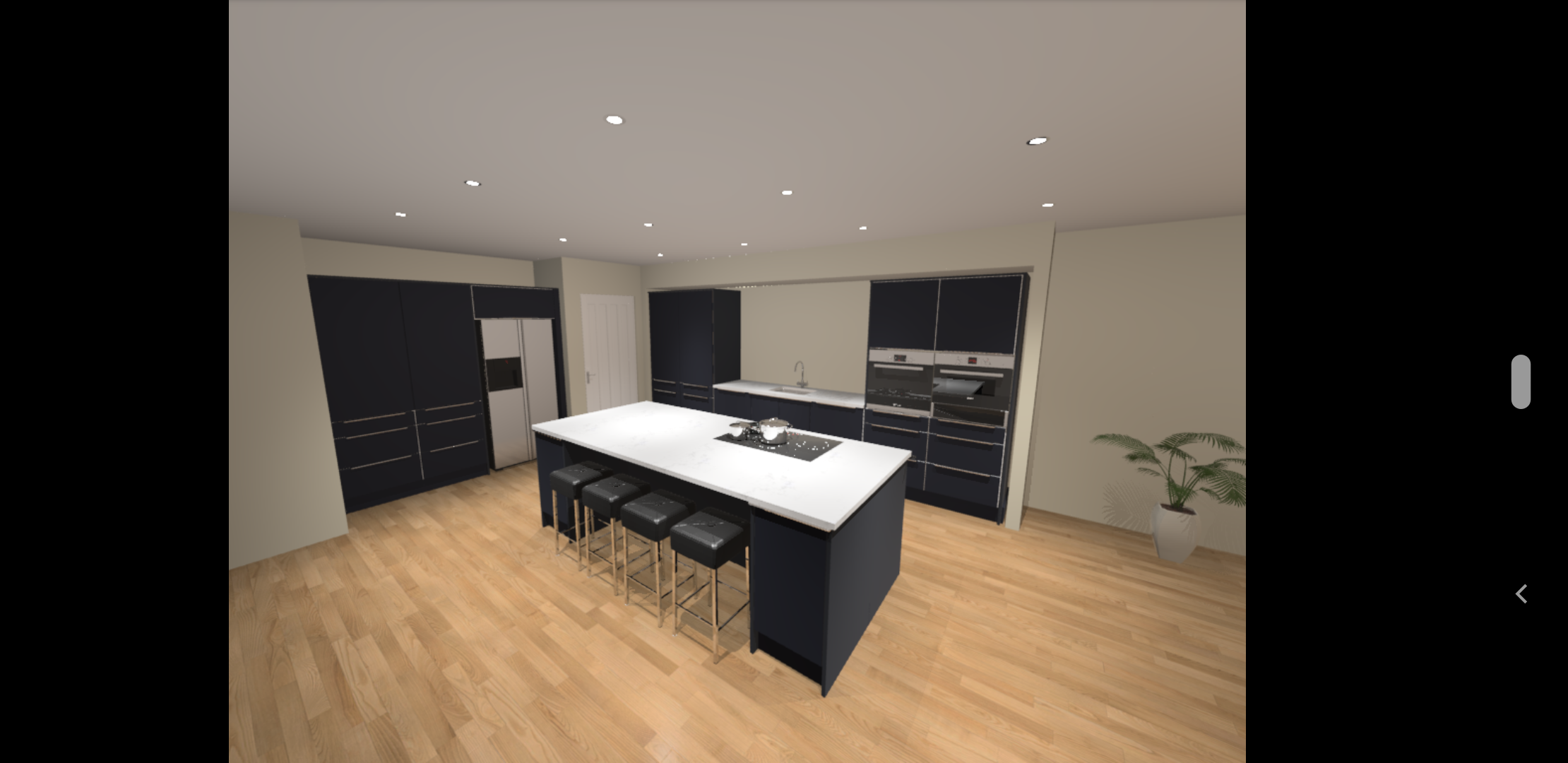

puntloos Posted September 13, 2021 Author Share Posted September 13, 2021 2 hours ago, ProDave said: That would FAIL building regs in Scotland, not enough "circulation space" Do the English regs not have a similar requirement? Far from it, over here the kitchen place we went to yesterday advised 900-1000 'to meet wheelchair reqs'. Maybe the scottish are provisioning 1400 to meet 'be able to turn around while carrying bagpipes' regs? 2 hours ago, ProDave said: We have a 1400 gap from main units to Island (to meet the circulation space requirement) and might reduce it to 1200 later on, but I would not want less than 1200. Well, since we were there in that kitchen shop they had both 900, 1000 and 1100 gaps .. 1000 felt fine, 1100 perhaps even slightly inefficient. 2 hours ago, ProDave said: I will stick my neck on the block and say this kitchen is not big enough for an island. A quick render - note that the dimensions are somewhat hard to fathom, since the ceiling height is 2m70 (window ends at 1500, top of the 'backsplash style cupboards is 2300) and the worktop heights are 1000 Link to comment Share on other sites More sharing options...

ProDave Posted September 13, 2021 Share Posted September 13, 2021 1 hour ago, puntloos said: Far from it, over here the kitchen place we went to yesterday advised 900-1000 'to meet wheelchair reqs'. Maybe the scottish are provisioning 1400 to meet 'be able to turn around while carrying bagpipes' regs? Well, since we were there in that kitchen shop they had both 900, 1000 and 1100 gaps .. 1000 felt fine, 1100 perhaps even slightly inefficient. A quick render - note that the dimensions are somewhat hard to fathom, since the ceiling height is 2m70 (window ends at 1500, top of the 'backsplash style cupboards is 2300) and the worktop heights are 1000 Very different in that view to what I had imagined. On the layout drawing I took the right hand light blue run of units to be a solid wall of units. Now I see tthat (left wall in this render) is actually open and what i saw on the plan is a row of units above the doorway. Link to comment Share on other sites More sharing options...

Dudda Posted September 17, 2021 Share Posted September 17, 2021 On 13/09/2021 at 11:01, puntloos said: the worktop heights are 1000 Is the 1000 high worktops in the render only or is that what you are proposing? It's higher than the usual 900 which is fine if you are slightly taller. I'm 6'2' so would be fine with 1000mm high although I find 900 ok too but the 5'4' other half would struggle with the extra height. Link to comment Share on other sites More sharing options...
puntloos Posted September 17, 2021 Author Share Posted September 17, 2021 2 hours ago, Dudda said: Is the 1000 high worktops in the render only or is that what you are proposing? It's higher than the usual 900 which is fine if you are slightly taller. I'm 6'2' so would be fine with 1000mm high although I find 900 ok too but the 5'4' other half would struggle with the extra height. Yes, I'm 6'4 - wife is tall too (but not Dutch tall ) 4 hours ago, joth said: Small thought: we have 900mm deep island split into 600 deep drawers and a 300 cupboard on the back, but the kitchen manufacturer needed a void between the cupboards and took that from the depth of the rear cupboards making them just too shallow for many things we wanted to put there (bread maker, food processor etc). We'd have added a bit more overall depth if we'd realized, or had slightly less depth on the drawers instead (would have complicated the Bora install bit would have been worth it) So you'd indeed go for a 1000-deep island.. interesting. Possibly worth doing. Link to comment Share on other sites More sharing options...
