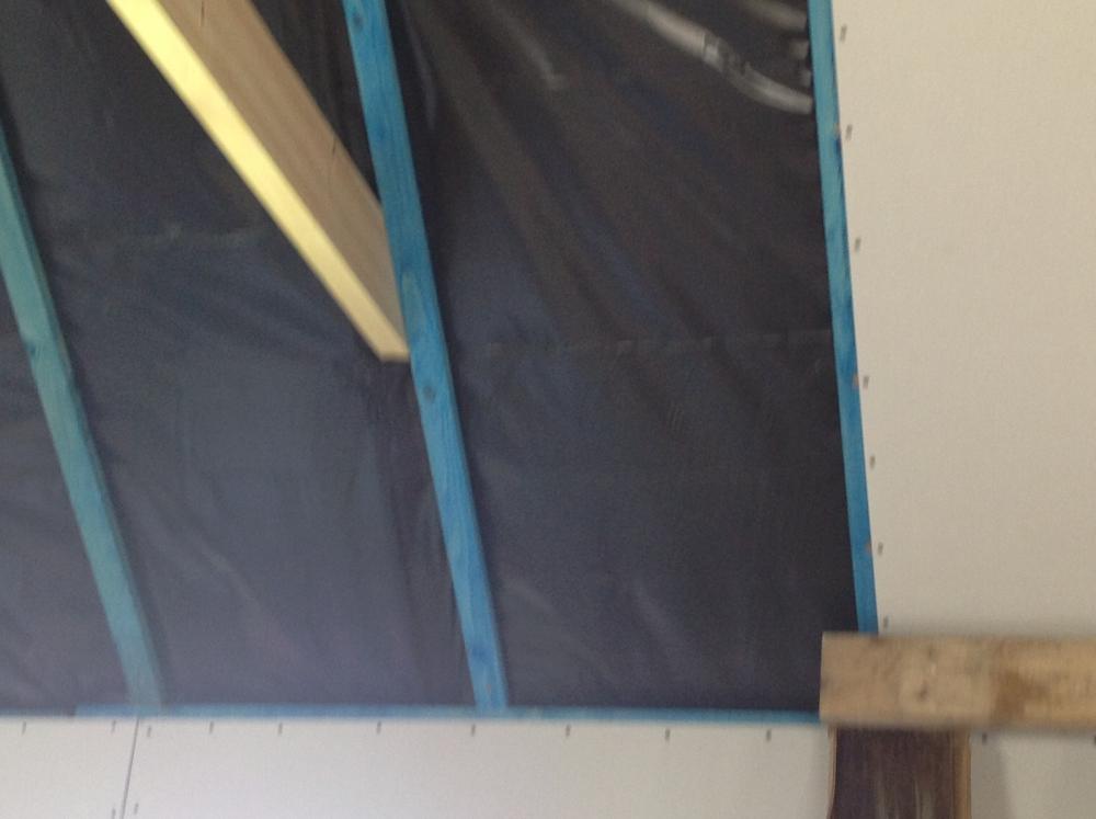

Crofter Posted April 27, 2017 Author Posted April 27, 2017 Just a wee tip in case it helps anyone else- whilst I was looking around for something to use as support on board joints that didn't have a batten under them, I came across what seems an ideal material: offcuts of 22mm chipboard flooring. My cavity is 25mm so it's a snug but easy fit, the chipboard is pretty stiff, and I had a pile of offcuts that were going to end up in a skip otherwise. 2
