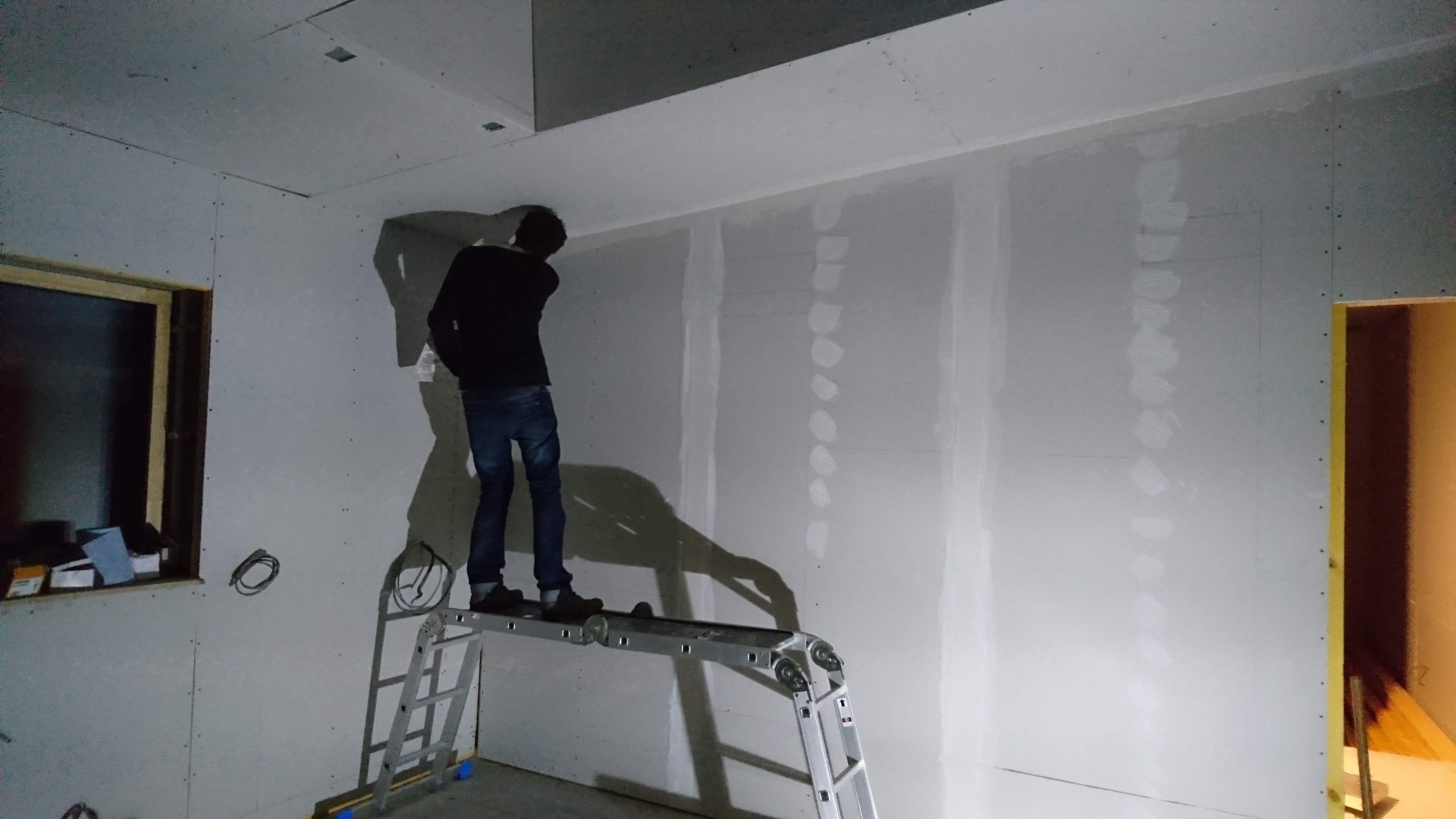

Nickfromwales Posted April 4, 2017 Share Posted April 4, 2017 Split the board lengthways, measuring to the top side of the cross member. Cut the horns out and offer the board up from underneath. Cut the bridge sections and fit them to the first PB accordingly, then offer the top piece in so it rests on top of the first, and job done. Bridge with 12mm ply or osb. 4x1 is too short imo as you should be able to get two rows of PB screws in the upper and lower halves to be 100% sure of no cracks. Eg ply strips 300mm wide so 2x150 wings for fixing, and two rows of PB screws lengthways per side per join ( so 4 rows of screws per finished join. Link to comment Share on other sites More sharing options...
Crofter Posted April 4, 2017 Author Share Posted April 4, 2017 14 minutes ago, Nickfromwales said: Split the board lengthways, measuring to the top side of the cross member. Cut the horns out and offer the board up from underneath. Cut the bridge sections and fit them to the first PB accordingly, then offer the top piece in so it rests on top of the first, and job done. Bridge with 12mm ply or osb. 4x1 is too short imo as you should be able to get two rows of PB screws in the upper and lower halves to be 100% sure of no cracks. Eg ply strips 300mm wide so 2x150 wings for fixing, and two rows of PB screws lengthways per side per join ( so 4 rows of screws per finished join. Erm, not sure I'm following you on this one. How many bits am I cutting the board in to?? If I cut lengthways, then there is no 'top' and 'bottom' bit, just a left and right. Link to comment Share on other sites More sharing options...
Nickfromwales Posted April 4, 2017 Share Posted April 4, 2017 Ok, just squinted at the pic and your boarding vertically ( portrait ) so turn my last comment through 90 degrees and we're back in the zone With vaulted stuff I always board landscape so my brain was stuck in that mode ?? Change "lengthways" to "sideways" and see if that makes better sense 1 Link to comment Share on other sites More sharing options...
Crofter Posted April 4, 2017 Author Share Posted April 4, 2017 Thanks Nick, makes perfect sense now. So a shorter joint with some added support, rather than a long joint that lines us with the battens. It will be easier to handle two square bits as well, rather than two long skinny ones. (Confession time- I already broke one board yesterday when I thought I could balance it on my head and carry it up a stepladder. Note to self, no you cannot). 2 Link to comment Share on other sites More sharing options...
Nickfromwales Posted April 4, 2017 Share Posted April 4, 2017 Landscape is a lot easier. But where's the fun in that Link to comment Share on other sites More sharing options...
Crofter Posted April 4, 2017 Author Share Posted April 4, 2017 44 minutes ago, Nickfromwales said: Landscape is a lot easier. But where's the fun in that It never really occured to me to do it landscape. Don't you end up needing a lot more supports on the board joins? Link to comment Share on other sites More sharing options...
Nickfromwales Posted April 4, 2017 Share Posted April 4, 2017 Yes, but I'm often working alone so most of my thoughts are engineered towards that ( so should appeal to you ). Link to comment Share on other sites More sharing options...
jamiehamy Posted April 4, 2017 Share Posted April 4, 2017 Pity your further on - we'll have a plasterboard hoist going soon, bloody brilliant piece of kit! Can put full boards up with one person. 1 Link to comment Share on other sites More sharing options...
Nickfromwales Posted April 5, 2017 Share Posted April 5, 2017 Bloody hell....the plasterers are going to love you. What's the ceiling height?!? Or is that guy actually 8 years old? 1 Link to comment Share on other sites More sharing options...
Nickfromwales Posted April 5, 2017 Share Posted April 5, 2017 Oh, and plus one on the PB lifter. Mine is very popular with my mates and gets me lots of favours. . Link to comment Share on other sites More sharing options...
PeterW Posted April 5, 2017 Share Posted April 5, 2017 PB Lifters aren't expensive and they are fantastic - I did a fermacell ceiling single handed with one and it saved my life..! Link to comment Share on other sites More sharing options...

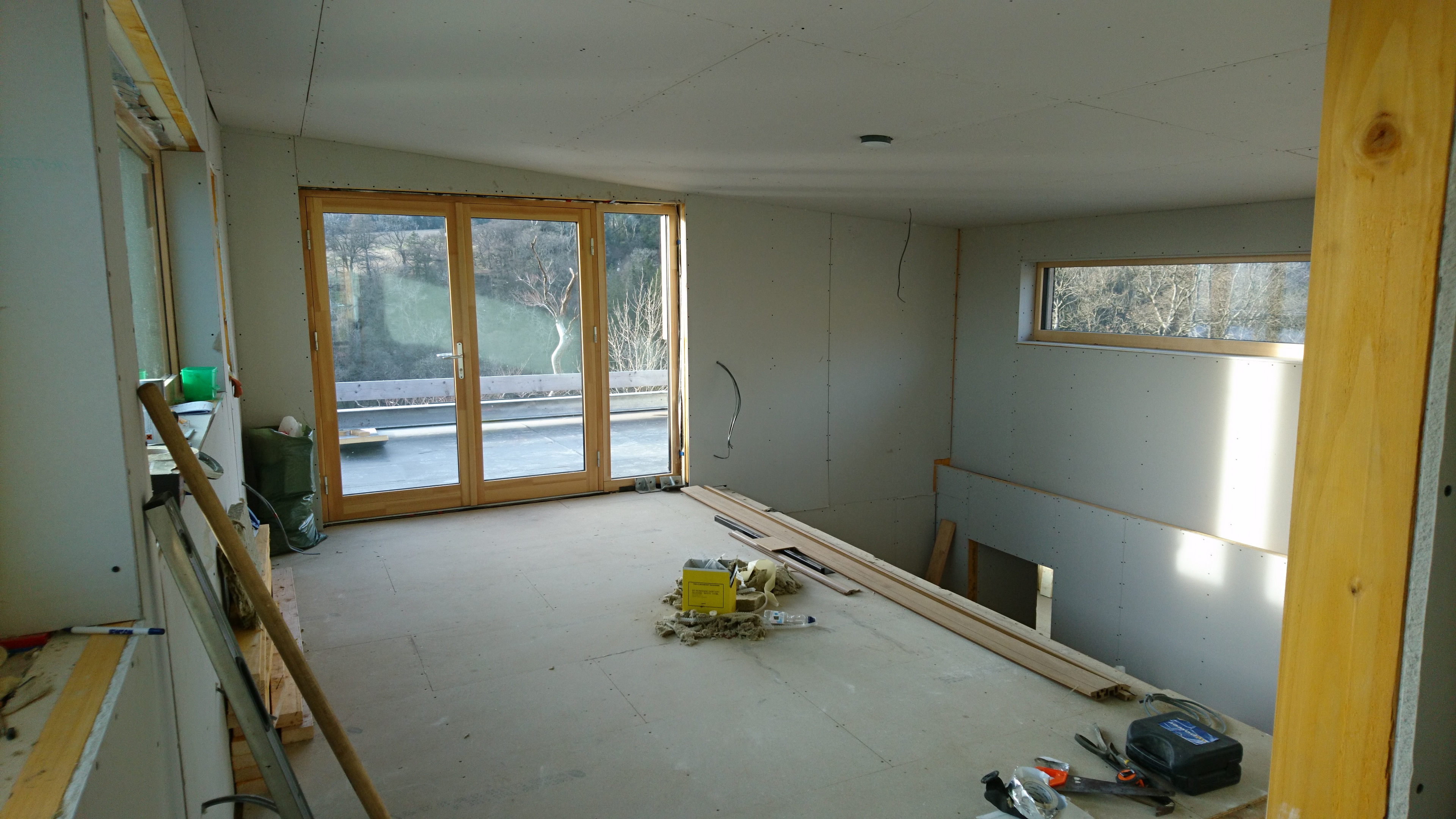

jamiehamy Posted April 5, 2017 Share Posted April 5, 2017 I think it's 3.5m. We did thid one by making a temp platform across with 4x2 and osb but that won't be possible once the balustrade goes on - it's about 4.8m from floor to ceiling. Hmm.. Link to comment Share on other sites More sharing options...
Jeremy Harris Posted April 5, 2017 Share Posted April 5, 2017 The top of our hall ceiling is around 6m above the floor and the plasterers did a good job of boarding and skimming that OK. I bought a scaffold tower for that job and a few others, and sold it to the plasterers a few weeks later. It was a lot cheaper to buy a tower and sell it for half price a few months later than it was to hire one for the time needed. 2 Link to comment Share on other sites More sharing options...
Crofter Posted April 5, 2017 Author Share Posted April 5, 2017 I'm going to look into the cost of getting a skim coat done, although I might be urinating contrary to the air movement on that one- I don't think it's common practise up here. Just so I can budget for it, it wouod be interesting to hear what people have paid for this- PM if you prefer. Is a m2 price the standard,p? I'd imagine smaller rooms and vaulted ceilings (both of which I have!) would bump the cost up. If it turns out not to be too expensive, that probably means I can get slightly sloppier with my plasterboarding Link to comment Share on other sites More sharing options...
Jeremy Harris Posted April 5, 2017 Share Posted April 5, 2017 I don't have the labour broken out separately for skimming our place, but I know that the two guys took two 2 weeks (10 working days) to do the whole job, boarding and skimming. Our job was a bit awkward, because of the need to work up on the platform in the hall and the whole first floor ceiling (the ceilings up there are around 3.7m high). Labour was £3200 for the whole job, and skimming took around 5 days (10 man-days). Filling and sanding joints would have probably taken around a day, so it's reasonable to guess that skimming added around 8 man-days of labour to the whole job. IIRC, the total internal wall and ceiling area was around 480m2, which makes the labour cost for skimming around £2.70/m2. I can't remember the cost of the plaster, but it wasn't massive. Our skim is around 3mm thick. 1 Link to comment Share on other sites More sharing options...

Crofter Posted April 5, 2017 Author Share Posted April 5, 2017 I'll have to spend a bit longer doing a more accurate calculation, but I reckon I've only got about 125m2 to do. This is assuming no skim required on thr bathroom walls or inside the cupboard. It really is quite a small house So if I can get a similar rate to Jeremy, the right side of £500. Probably worth it, but not in the budget. Will check behind the sofa. Link to comment Share on other sites More sharing options...
Jeremy Harris Posted April 5, 2017 Share Posted April 5, 2017 I'm not sure how labour rates compare, as generally rates here tend to be a bit on the high side, but we paid the guys the equivalent of about £160 a day each, plus a day of labourer's time shifting boards into each room. A fair bit of time is spent mixing batches of plaster, which is something a reasonably competent labourer should be able to do, although it needs to be done with care; our guys were very fussy about the way the plaster was mixed, and did it themselves. Link to comment Share on other sites More sharing options...
