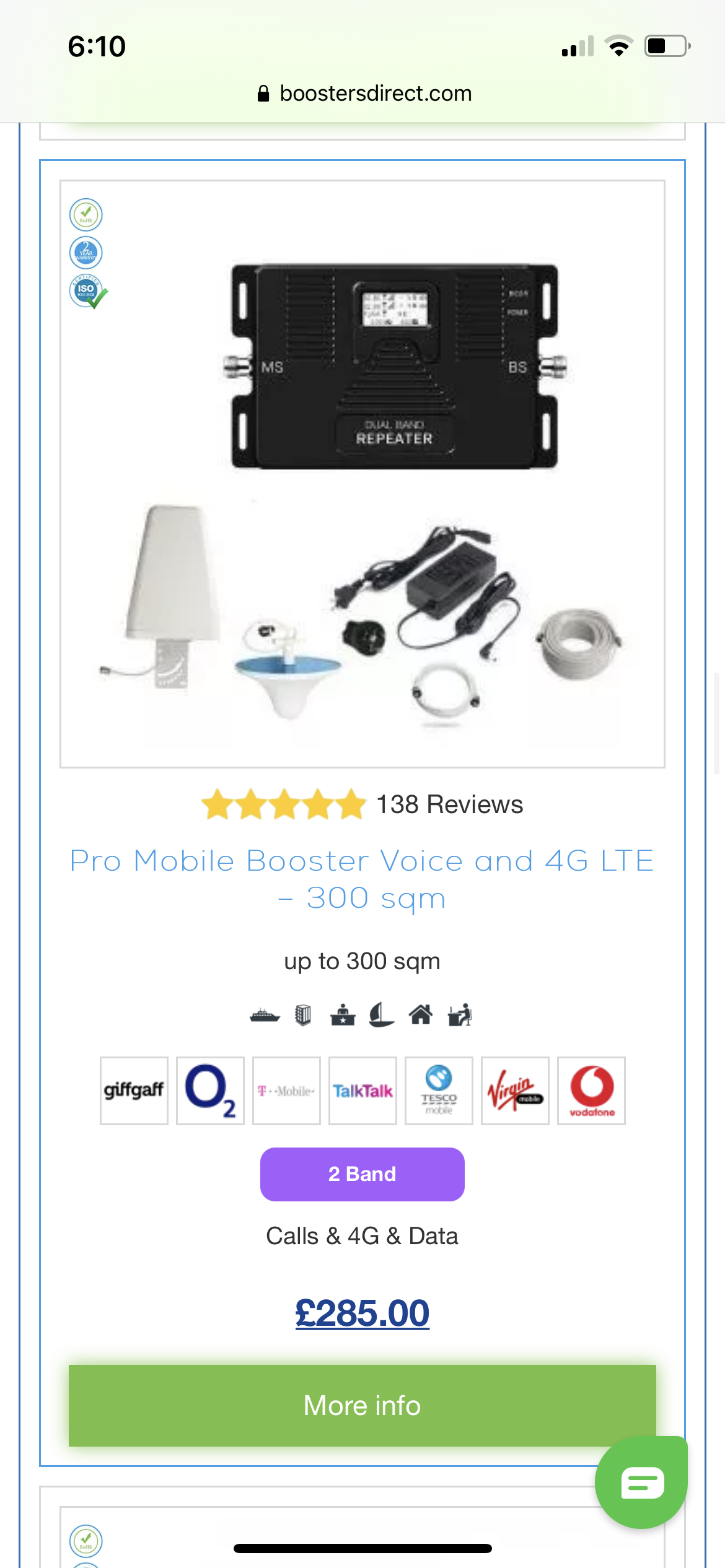

ashthekid Posted September 10, 2021 Share Posted September 10, 2021 I’ve noticed within my conversion project after installing a lot of PIR foil backed insulation that my mobile reception dramatically drops upon entering the property now from a good 4G signal to a mediocre 3G. Is there anything, whilst I still have the chance, I can install to make the reception good again? It’s pretty annoying that something so simple could affect the signal so much. I imagine it’s just going to get worse once it’s plasterboard and doors hung. Any tips? I’ve heard about plug-in boosters using your Wi-fi network but I’ve tried that at my parent’s property and it hasn’t made any difference whatsoever. Link to comment Share on other sites More sharing options...

Temp Posted September 10, 2021 Share Posted September 10, 2021 1 hour ago, ashthekid said: I’ve heard about plug-in boosters using your Wi-fi network but I’ve tried that at my parent’s property and it hasn’t made any difference whatsoever. WiFi and 4/3g are totally different. Boosting WiFi has no effect on 4g. Some phone companies used to offer mini 3/4g base stations that provided a phone signal indoors and used your broadband connection but I suspect they have all stopped offering those now. There are some (illegal) mobile phone signal boosters that have an aerial outdoors, an amplifier and another aerial indoors. I half remember that another forum member has used one but perhaps I'm wrong. It's not me! Different phone companies use different masts. At my house the EE signal is stronger than Vodaphone for example so ask your friends around and compare network and signal strength. Changing network might improve things. Link to comment Share on other sites More sharing options...

ashthekid Posted September 10, 2021 Author Share Posted September 10, 2021 Sadly I live in quite a small village which is kind of in the middle of nowhere. Currently only Vodafone works. I used to be on EE when I first moved here but had zero signal(which was quite nice for a while). I’ve used the Vodafone signal booster that plugs into a standard electrical socket and then uses your existing Wi-fi to boost your signal but it’s awful and didn’t make a single difference, if anything it made it worse. I've seen this online too: Link to comment Share on other sites More sharing options...
