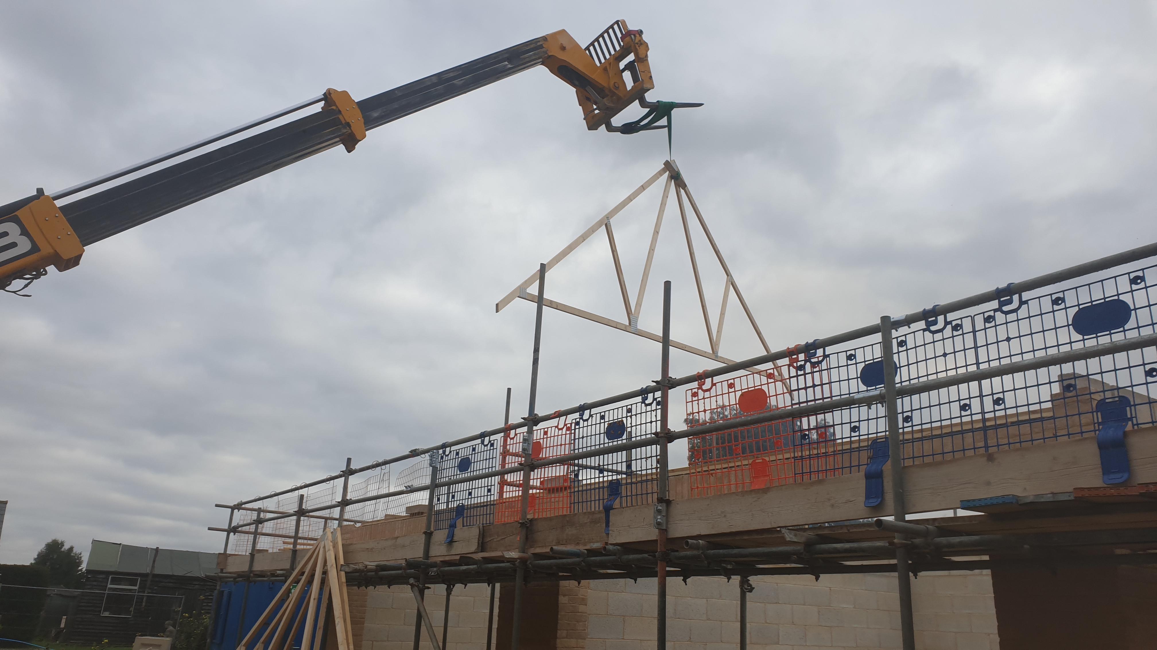

epsilonGreedy Posted August 21, 2021 Share Posted August 21, 2021 46 minutes ago, Mickyl said: Yes. That would be the plan. The roofers are saying they cant do the job otherwise. Have a look at the photos in my previous thread on this subject, in page 2 I uploaded some photos of a smaller (green) telehandler lifting trusses up about 6m. My roofer (come general builder, come cattle herdsman, come suckling pig producer, come shepherd, come property developer, come reclamation yard entrepreneur) erected the trusses to the vertical after they had been lifted to wallplate height in a horizontal orientation as seen in the photos. My main trusses were attic trusses so fairly heavy at about 75kg each, the pitch is 30 degrees and the clear span 5.6m. As a 3 man team we pivoted the trusses up to the vertical. On a larger house next door with a 40 degree pitch a 4 man team lifted larger but lighter fink trusses from ground level using just muscle power. Link to comment Share on other sites More sharing options...
Faz Posted August 21, 2021 Share Posted August 21, 2021 On 19/08/2021 at 22:34, SimonD said: I'm guessing you're referring to 14m lift height not reach. Here's an example of the kind of size telehandler you'd need https://www.ardenthire.com/plant-hire/telehandlers-and-forklift-hire/jcb-535-140/ Beware, they are big machines so when you say rear extension, what is access and turning space like to lift your trusses? Ardent hire have a depot up north but I'm not sure if it's up north east enough for you? They do operator and unit or unit only but you would need a credit account with them first, this can take some time with lots of checks. I think they even did a credit check on me when I set up an account. Some hire places can add on insurance but it's quite expensive usually at something like 12% of hire cost, other wise you can buy short term hire insurance from the likes of https://www.jcbinsurance.com/ Looking at it differently, you might be better off simply hiring a crane for half a day or a full day, that would come with an operator and wouldn't need the manouvering around site of a telehandler. I wonder whether you'd benefit from posting some pictures of your site and posting a question here along the lines of how best to lift the trusses and see what suggestions come along? Loads of experience here with these sorts of problems. HTH What he says! I have an (in date) forks ticket and am an experienced telehandler driver - you do not want to be having a 'go' at this yourself. I thought about doing the main roof trusses and quickly thought better of it and got a crane in. Doing the quad garage trusses with the forks - bit tricky - just look at the reach on the boom for a single story garage.... Link to comment Share on other sites More sharing options...
Dave Jones Posted August 21, 2021 Share Posted August 21, 2021 hope your insurance covers you for that risky manoeuvre. The scaffold alone is shocking. Link to comment Share on other sites More sharing options...
epsilonGreedy Posted August 21, 2021 Share Posted August 21, 2021 6 hours ago, Dave Jones said: hope your insurance covers you for that risky manoeuvre. The scaffold alone is shocking. What's wrong with it? Link to comment Share on other sites More sharing options...
Faz Posted August 22, 2021 Share Posted August 22, 2021 19 hours ago, Dave Jones said: hope your insurance covers you for that risky manoeuvre. The scaffold alone is shocking. Slingers course completed July 20, telehandler ticket valid to Oct 23. It will be fine mate. Only problem with the scaffolding is that it is still there! Will be a milestone to get rid of all of that in 2 weeks time - beers will be had!!! Link to comment Share on other sites More sharing options...
