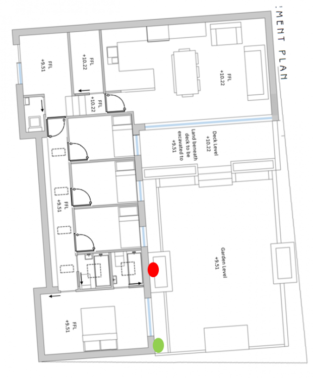

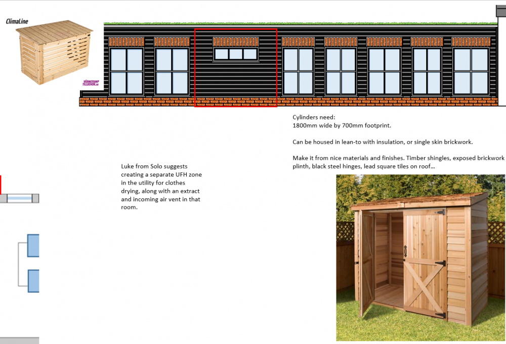

Tony K Posted August 7, 2021 Author Posted August 7, 2021 (edited) Useful advice as ever on here, thanks. Regarding noise alone, my conclusion is to install the ASHP, see how it goes especially when it is configured and programmed to best effect, and then go for a cover if needs be. I've recently looked again at the advice I received from the heating engineer who quoted for a system that includes the nibe pump, UFH and water tanks. I'm reminded that he raised the idea that my water tanks could be housed in an external timber lean-to if I preferred, so as to free up space in the utility room, so long as the lean to was properly insulated. As part of this scheme I would place my ASHP on the far side of my (small) garden, and run a 160mm round diameter connector with 2 x 32mm poly pipes installed inside it, all 1.2 metres below ground level. In the end I felt I could fit the tanks in my utility room (just), so I didn't pursue the idea. Looking at it now it also occurs to me that placing the ASHP on the far side of the garden means facing it towards my property, which appears a bad idea if, as I think I now understand, they operate a bit like speakers with most sound projecting from the front. Edited August 7, 2021 by Tony K
