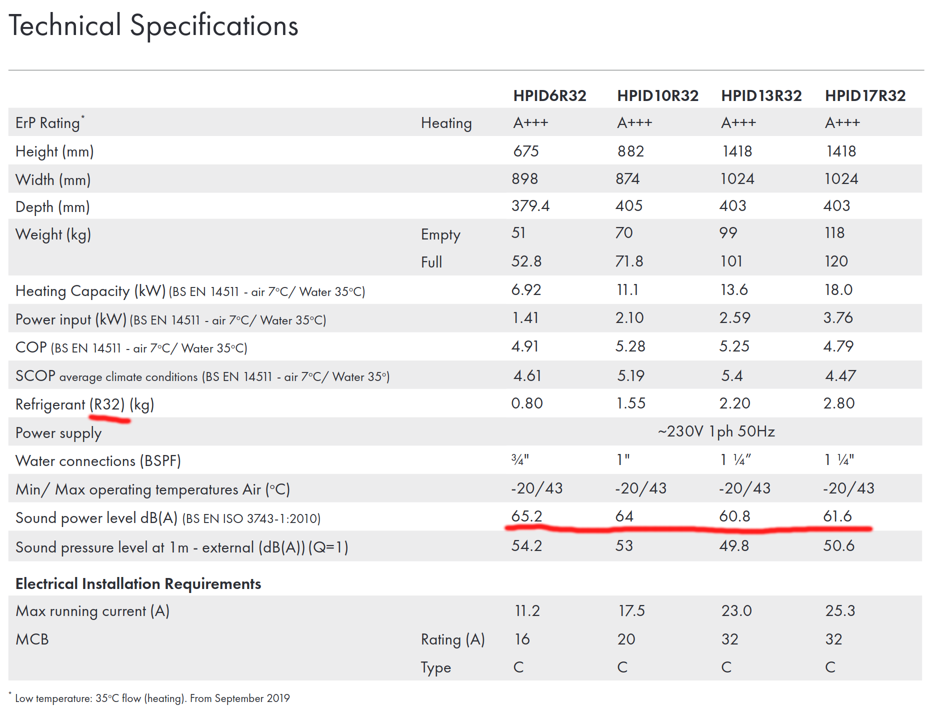

Ommm Posted July 31, 2021 Posted July 31, 2021 While I have it open, this is the info for Grant. It's why I'm not entirely happy going with a Grant system:

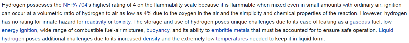

jack Posted August 3, 2021 Posted August 3, 2021 On 03/08/2021 at 08:52, IanR said: In short, it's not going to happen. Hydrogen will be the niche when it comes to heating homes, where using electricity is just not possible. And for those houses that have to rely on Hydrogen the costs will unfortunately be higher than electricity. Expand All this talk of hydrogen - especially pure hydrogen - being fed to boilers is utter nonsense. There's no way you can pipe into people's homes a scentless explosive gas that leaks better than just about any other gas in existence. From Wikipedia: At best, there's research into diluting natural gas with a small percentage of hydrogen - 20%, say. And how do you manage a transition from gas to hydrogen? You can't exactly do it gradually, but to do it all at once would require everyone to convert their boilers to be hydrogen-capable all at once. And finally, the idea of on-site production of hydrogen in the near term is ridiculous. Why would you generate hydrogen inefficiently, only to immediately burn it? Clearly there's no point using it to generate electricity in a fuel cell - you might as well just use the electricity directly. 2

ToughButterCup Posted August 3, 2021 Posted August 3, 2021 On 03/08/2021 at 10:36, jack said: ... utter nonsense. There's no way you can pipe into people's homes a scentless explosive gas that leaks better than just about any other gas in existence. ... Expand Lets start with a list of candidates whose houses should have their very own private supply of ... scentless explosive gas ... I can think of quite a few at the moment..... 2
