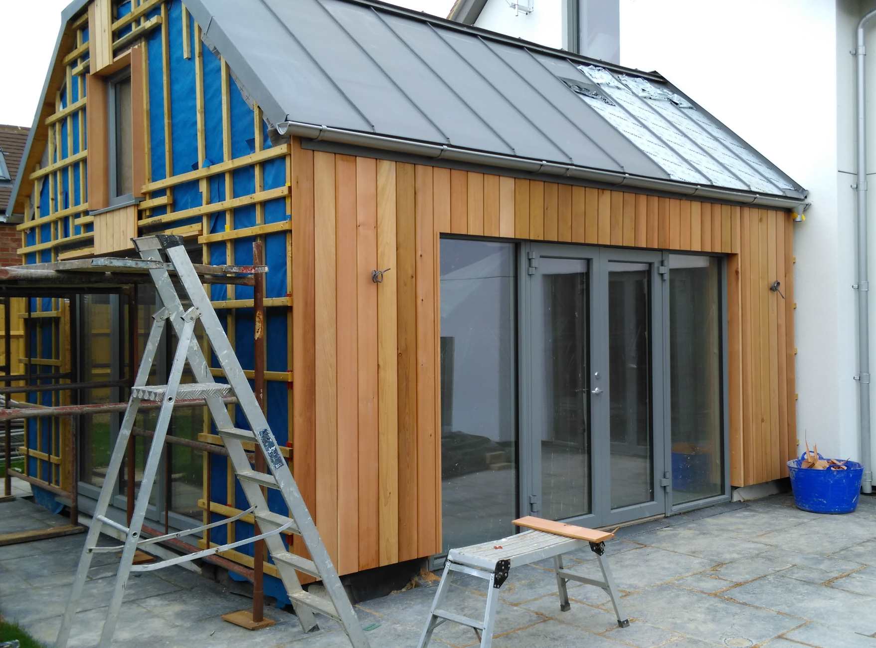

ragg987 Posted March 30, 2017 Share Posted March 30, 2017 We have vertical half lap boards for cladding in one area. The detail we have is vertical batten over the membrane, screwed into the board, with horizontal cross battens on which the cladding is nailed. The cross battens are tapered so water can run off towards the wall. In our case counter battening is needed for effective run off of water or condensation. Link to comment Share on other sites More sharing options...

ragg987 Posted March 31, 2017 Share Posted March 31, 2017 6 hours ago, ryder72 said: Any chance you can post a photo? Link to comment Share on other sites More sharing options...

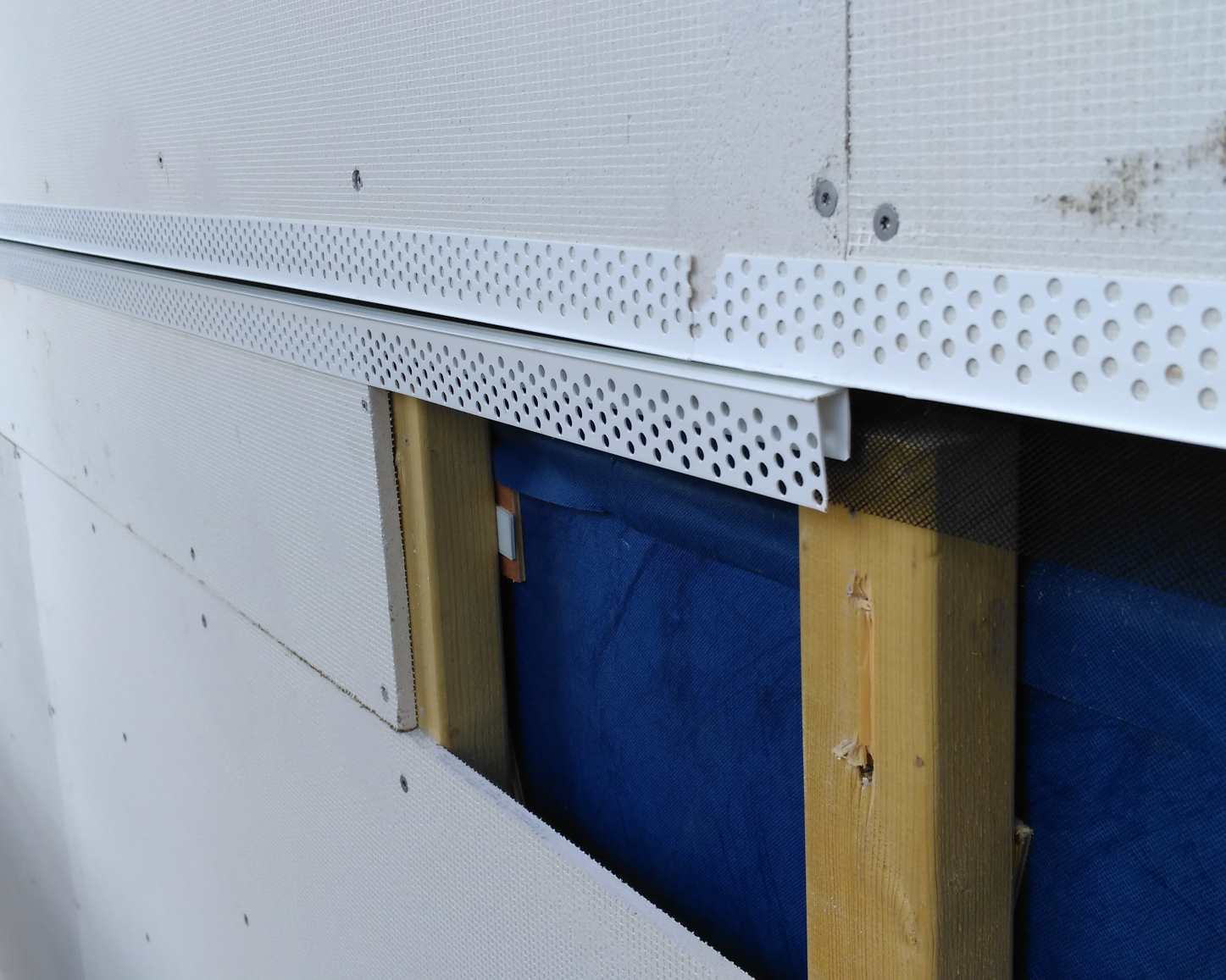

ryder72 Posted March 31, 2017 Author Share Posted March 31, 2017 One point thats emerging is that the 25*47 batten for the renderboard wont suffice as most render boards specify a 60mm wide batten when 2 boards are jointed at a single batten. Has anyone faced this? Link to comment Share on other sites More sharing options...
ragg987 Posted March 31, 2017 Share Posted March 31, 2017 We used 80x35 batten at 600mm centres as specified by STO. Detail of batten and board showing expansion joint. Link to comment Share on other sites More sharing options...
