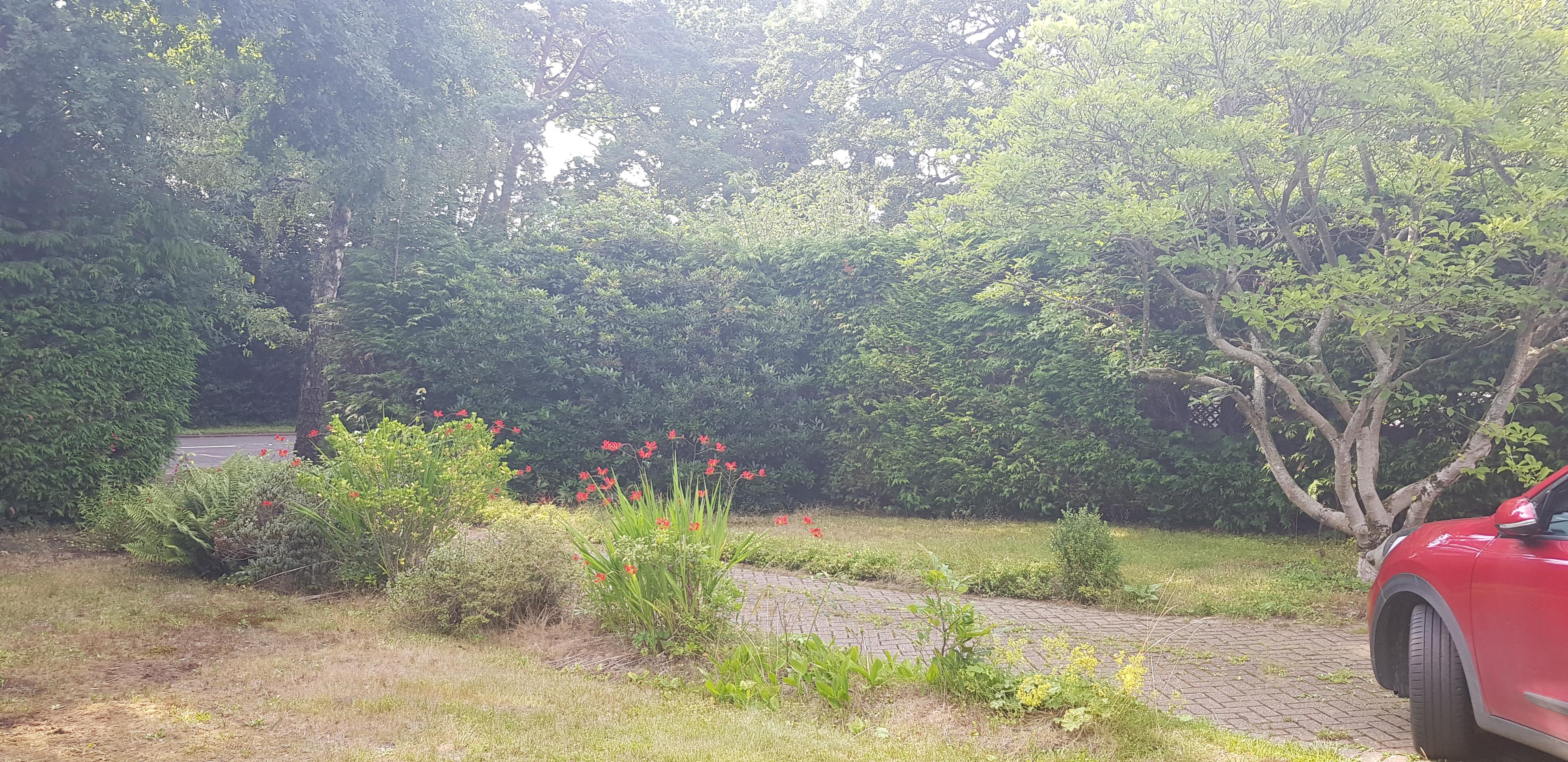

1) I have a narrow drive where a lorry will fit but it won't be able to turn slightly and tip to the side (unless some can do it?), so I am planning to get a grab lorry delivery - they usually quote 14-16-17ton as a full load at £30-35+VAT (we are in Woking).
2) Do I need to put anything on the grass (or rather moss ? ) first?

Yes you should remove the moss and topsoil, and put down a geomembrane that will prevent the stone and earth mixing.
Thanks! I know some people use ply but I don't have any lying around and it's not cheap. OK for a single bug that will be used in a week or two, but this can be here for a long time.

before I buy - is it geomembrane (polyethylene) or geotextile that I need? Polythene won't let the water through but won't let fines through either...
1 hour ago, oldkettle said:
@saveasteading
depends..? Under what and for what purpose ..??
@PeterW
Under the temporary storage of aggregates delivery - in this case likely MOT 1

Non-woven geotextile through preference. This allows water to drain away, prevents mud from coming up into the stone, and prevents stones getting pressed down into the earth.
Costs anywhere from  £1 to £2 /m2 normally but there is very heavy duty stuff at high prices.
Easily confused with woven, which works but not usually so well, and is more suitable for weed control.
You could use this to protect the drop-off point too, then recover for original use, whereas polythene will get  thrown away.
