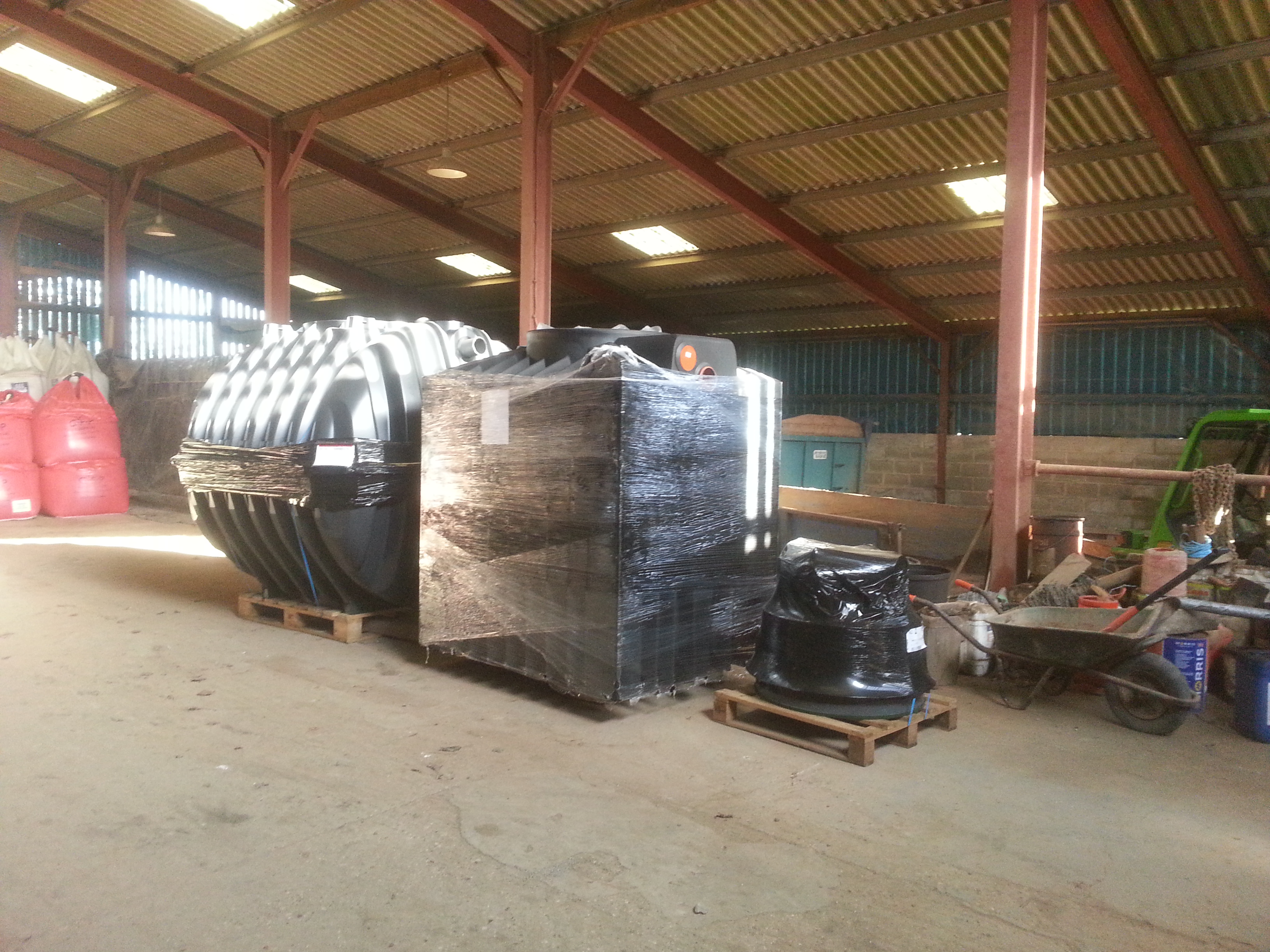

readiescards Posted March 15, 2017 Share Posted March 15, 2017 Following on from: http://forum.buildhub.org.uk/ipb/topic/1963-excessive-cost-of-sewage-treatment-plants/ The Clearfox with Graf baffle tank arrived today - worms coming next month Going to need some big holes! Link to comment Share on other sites More sharing options...

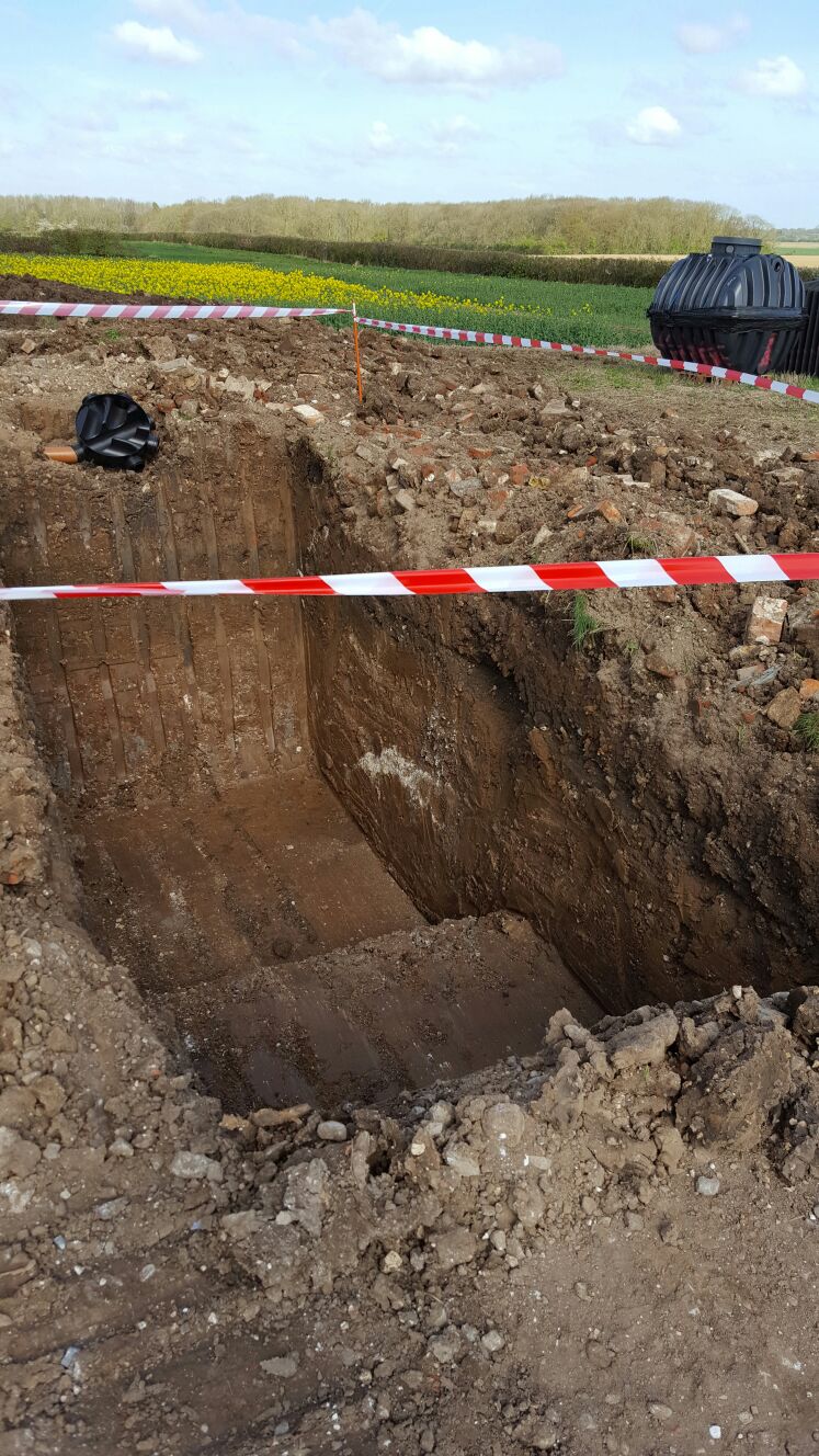

readiescards Posted April 5, 2017 Author Share Posted April 5, 2017 Big hole ready for tomorrow's Clearfox installation 1 Link to comment Share on other sites More sharing options...
PeterW Posted April 5, 2017 Share Posted April 5, 2017 Have you got a bowser ready to fill it ..??! Thats a huge hole ..! Link to comment Share on other sites More sharing options...
MikeSharp01 Posted April 5, 2017 Share Posted April 5, 2017 (edited) 1 hour ago, readiescards said: Big hole ready for tomorrow's Clearfox installation Somebody is bloody good with a digger! Smoother than a babies bottom and just look at those teeth (tooth) marks! Edited April 5, 2017 by MikeSharp01 Link to comment Share on other sites More sharing options...

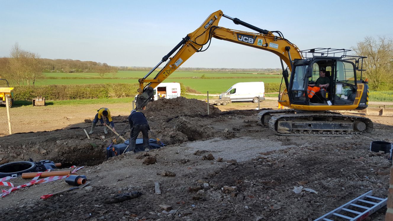

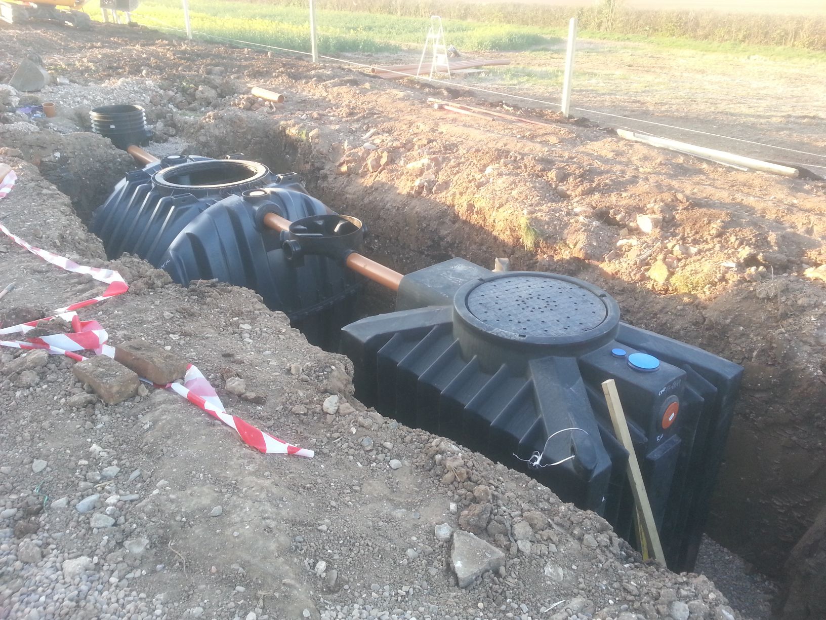

readiescards Posted April 7, 2017 Author Share Posted April 7, 2017 After an initial hiccup (I got the first tank put in backwards - very poor documentation and no-one available to contact at SepticTanks.co.uk or Graf UK) the tanks are in thanks to the landscape guys big digger. Link to comment Share on other sites More sharing options...
readiescards Posted April 7, 2017 Author Share Posted April 7, 2017 The cost of installation has risen considerably as I had not realised just how much gravel was going to be needed - as we went with one big hole rather than two separate holes to get the tanks close together. (min separation is 5ft) plus the drain to the water course also needs lots of gravel - which helps to ensure the hole never files with water (since the Clearfox is basically a empty plastic box likely to float out of the ground if the hole filled with water) Link to comment Share on other sites More sharing options...

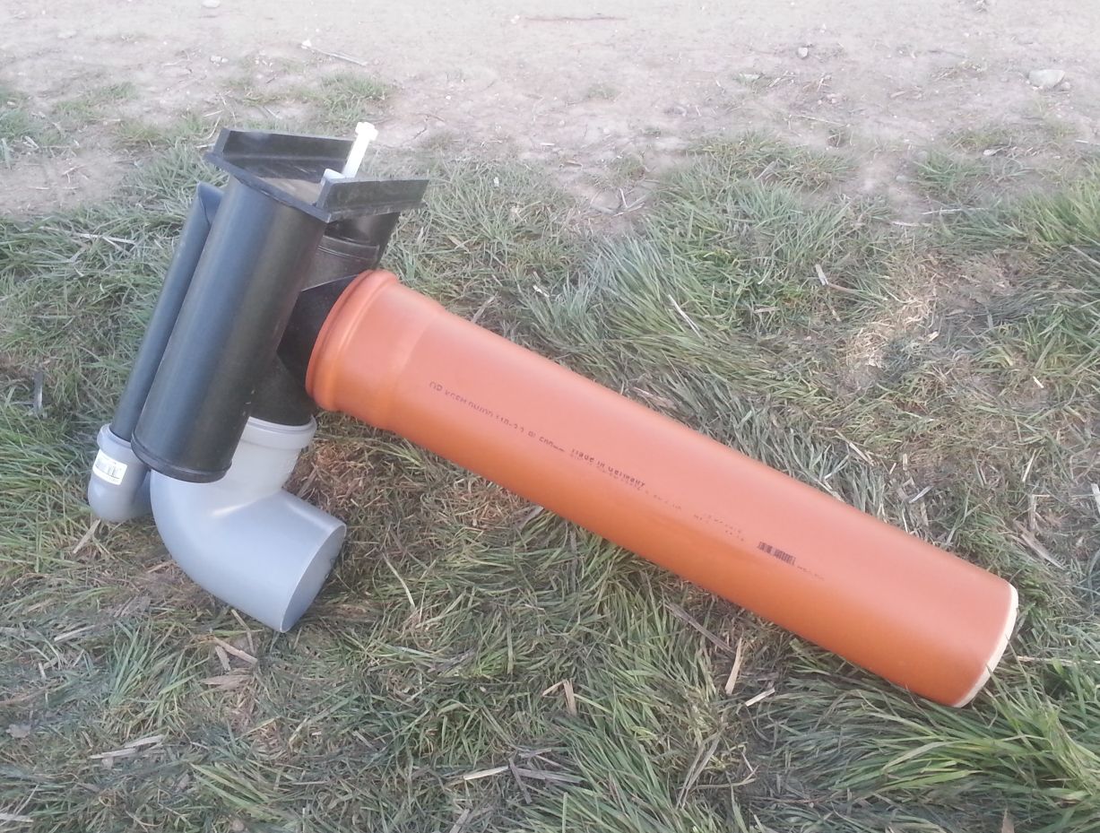

readiescards Posted April 7, 2017 Author Share Posted April 7, 2017 This is the redundant 'thorttle' - supplied by Clearfox but not used when the Graf baffle tank is supplied - disappointingly no instructions to tell me that. It will now be this week's bath toy for me 5 year old boy - saves raiding the recycling box for new bath toys! Link to comment Share on other sites More sharing options...
Nickfromwales Posted April 7, 2017 Share Posted April 7, 2017 Your boy is living the dream. Who needs Toys r Us, eh ?!? 1 Link to comment Share on other sites More sharing options...
