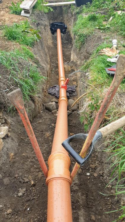

Hydra Posted July 15, 2021 Share Posted July 15, 2021 (edited) Quick question as I note in part H of the building regs it makes specific mention of the minimum gradient of a pipe run. Currently I have some workers putting in a soil run that's going to be more like 12-15 degrees, which I believe is something around 1:4 - 1:5 gradient. From what I read online for advice this isn't ideal - My groundworkers insist they don't have any choice (think they want to avoid a backdrop) Any thoughts as I have Mr inspector round Monday and the groundsmen will be long gone by then. Update - yes i've contacted regs, but after they haven't responded to my last 7 emails, i've given up with getting any advice from them. Cheers Edited July 15, 2021 by Hydra Link to comment Share on other sites More sharing options...

Hydra Posted July 16, 2021 Author Share Posted July 16, 2021 4 hours ago, George said: I've never heard of an issue with too steep a gradient. Soil pipes start vertical after all! Backdrops are preferred because it minimises excavation - but you do need to have the right components available. 6 hours ago, MikeSharp01 said: +1 Unfortunately not the case, just got off the phone with the BCO and he said he won't accept more than a 6cm drop per meter. (1/60) Which leaves me feeling a) slightly peeved, and b) Slightly happy about being a first for something. Now I either need to go outside and dig another 1.2 meters down, though nothing but stones and clay for 6 meters, or use a backdrop which would mean the pipe would be about 4 inches under ground level for half the run, and will be smashed to pieces when I have a driveway put in next year. Potential solution, Perhaps i'll get the initial run a little lower using a stub stack, then a backdrop at the end. To at least get it low enough that I can actually put soil over it! Thanks for all the replies and sorry to be the odd one out with his BCO. Link to comment Share on other sites More sharing options...

Hydra Posted July 16, 2021 Author Share Posted July 16, 2021 (edited) 40 minutes ago, MikeSharp01 said: Hmmm sounds odd - did they explain their reasoning? Also 6cm / Meter = 1 / 17 while 1:60 is between the BR 1:40 and BR 1:80 Possible that i've misquoted him with my 1:60! He stated for every 1m of run, 60mm was the maximum he would allow for drop. (for foul drainage). His reasoning being any steeper would leave the solids hanging dry. Given the dislike for steeper gradients I wonder if he will dislike my stub stack! (joking) Asked for a written conformation to present to my groundworkers, who aren't that happy, and in their own words "are too old for this" Edited July 16, 2021 by Hydra Link to comment Share on other sites More sharing options...

joe90 Posted July 16, 2021 Share Posted July 16, 2021 Just read the regs and no max slope quoted, just minimum slopes (unable to cut and paste it for some reason?) why not challenge your BCO to quote the regs where it says max slope ? https://assets.publishing.service.gov.uk/government/uploads/system/uploads/attachment_data/file/442889/BR_PDF_AD_H_2015.pdf H1, page 16 table 6. Link to comment Share on other sites More sharing options...

saveasteading Posted July 16, 2021 Share Posted July 16, 2021 I believe the regs have been simplified...although I am not about to look up the old books. There was once a rule, or at least understanding, that there was a maximum gradient to prevent separation as described. That of course does not apply to vertical stacks as obv it all just falls together. Also it is a fact that there can be separation, but it may now be recognised that another train will soon be along to give it a shove. Diagram 9 stops at gradient 1:10, so it could be argued that this is the maximum. AND it used to be that every change of direction, horizontal or vertical, required an access chamber. That has been dropped. Well, not dropped exactly: it now says 'as straight as practicable, so that does leave it up to the inspector. So be happy that he is ok with it , as that is not as straight as it could have been. If the groundworkers are too old to remember these old rules then they aren't really very old at all, or were not paying attention. In reality, your arrangement with the steep section, rather than a simple grade, will work fine. Did you say why they didn't do a constant grade? I tell BCO if I disagree: Some are happy to agree when they hear the argument or see the proof. Some get very angry indeed to be shown to be wrong, and then it is time to demand someone else, usually younger. BUT to their credit they come across some awful work, where the builder does not care or understand the theory. Perhaps they have to assume we are all like that until proven otherwise. 47 minutes ago, ToughButterCup said: asking the BCO -while still on site- to agree my notes Yes, this is management, even teamwork, and has the least chance of causing disagreements. The BCO is not a designer, and neither, usually, is your groundworker. Link to comment Share on other sites More sharing options...

saveasteading Posted July 16, 2021 Share Posted July 16, 2021 If that is your decision, then show the groundworker diagram 9 and clauses 2.19 and 2.20 of document H. Any change of gradient to have an access point. They have none Bends as large a radius as possible. They have tight bends. Unfortunately I can't screen grab it, but here is the link https://assets.publishing.service.gov.uk/government/uploads/system/uploads/attachment_data/file/442889/BR_PDF_AD_H_2015.pdf Link to comment Share on other sites More sharing options...
