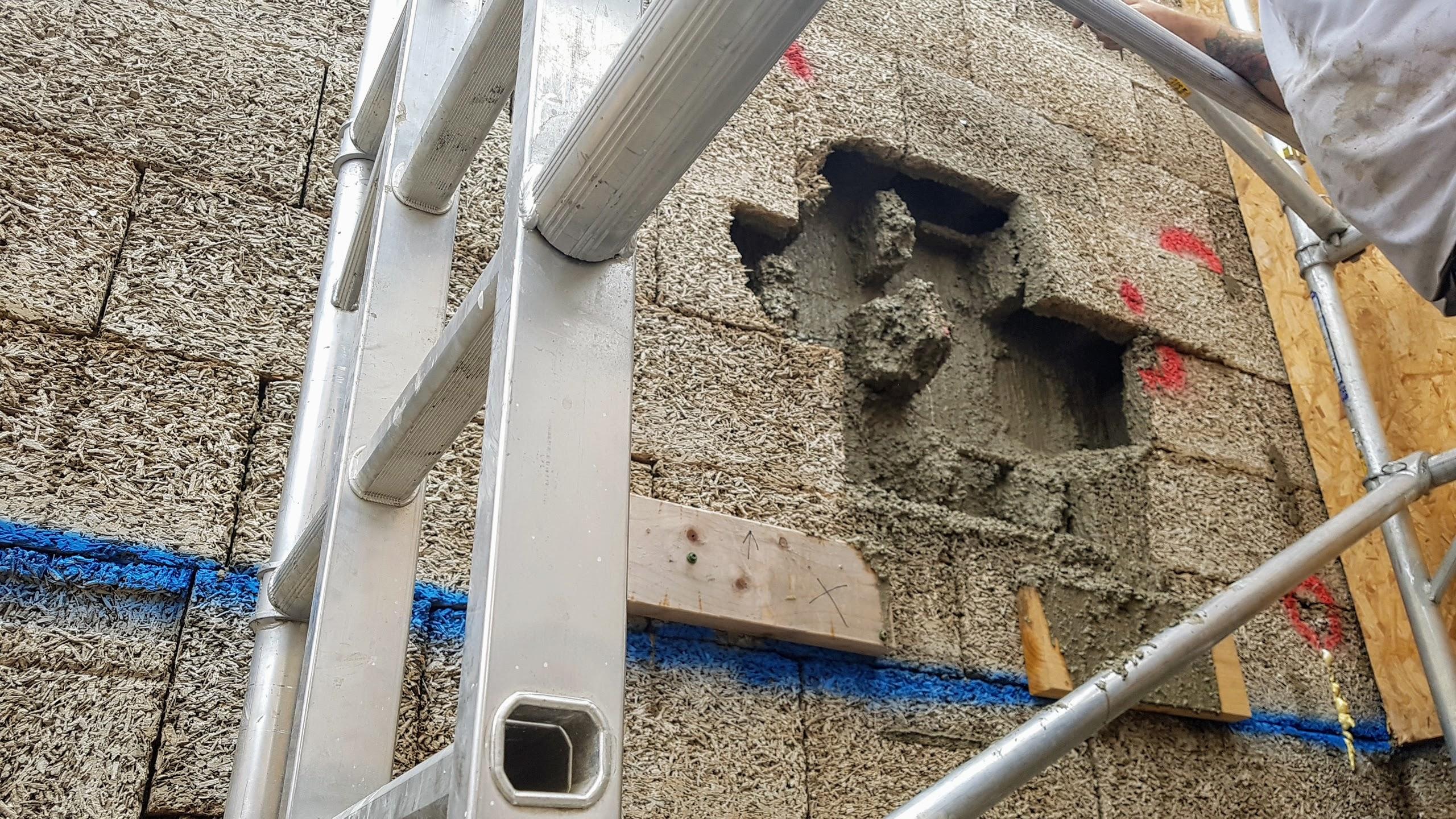

ToughButterCup Posted July 12, 2021 Posted July 12, 2021 6 hours ago, Chanmenie said: .... I did also watch the Grand Designs episode where the guy used Durisol and suffered a blow out round a window, ... I remember that episode. I watched it again the other day, and laughed out loud. That was a leak, not a blow-out. That was a leeeeedl peeeeedl .... This, this is whatcha call a blowout. And yer right, it would have had a bit of an effect on the airtightness. I came as close as I ever have to pressing criminal damage charges on the facking bain-dead twat who knocked the blocks into line with a lump hammer. Had it all on time lapse camera. But I hadn't reviewed the film for a few days ..... Thats 5 year old news now. Moved on - so much wiser and such a lot nastier now than I was then.
Chanmenie Posted July 12, 2021 Posted July 12, 2021 2 minutes ago, ToughButterCup said: I came as close as I ever have to pressing criminal damage charges on the facking bain-dead twat who knocked the blocks into line with a lump hammer. Had it all on time lapse camera. But I hadn't reviewed the film for a few days ..... Thats 5 year old news now. Moved on - so much wiser and such a lot nastier now than I was then. Yeah i read all your posts, that was a shitty experience that was so easily avoided if the builders had any brains. 1
