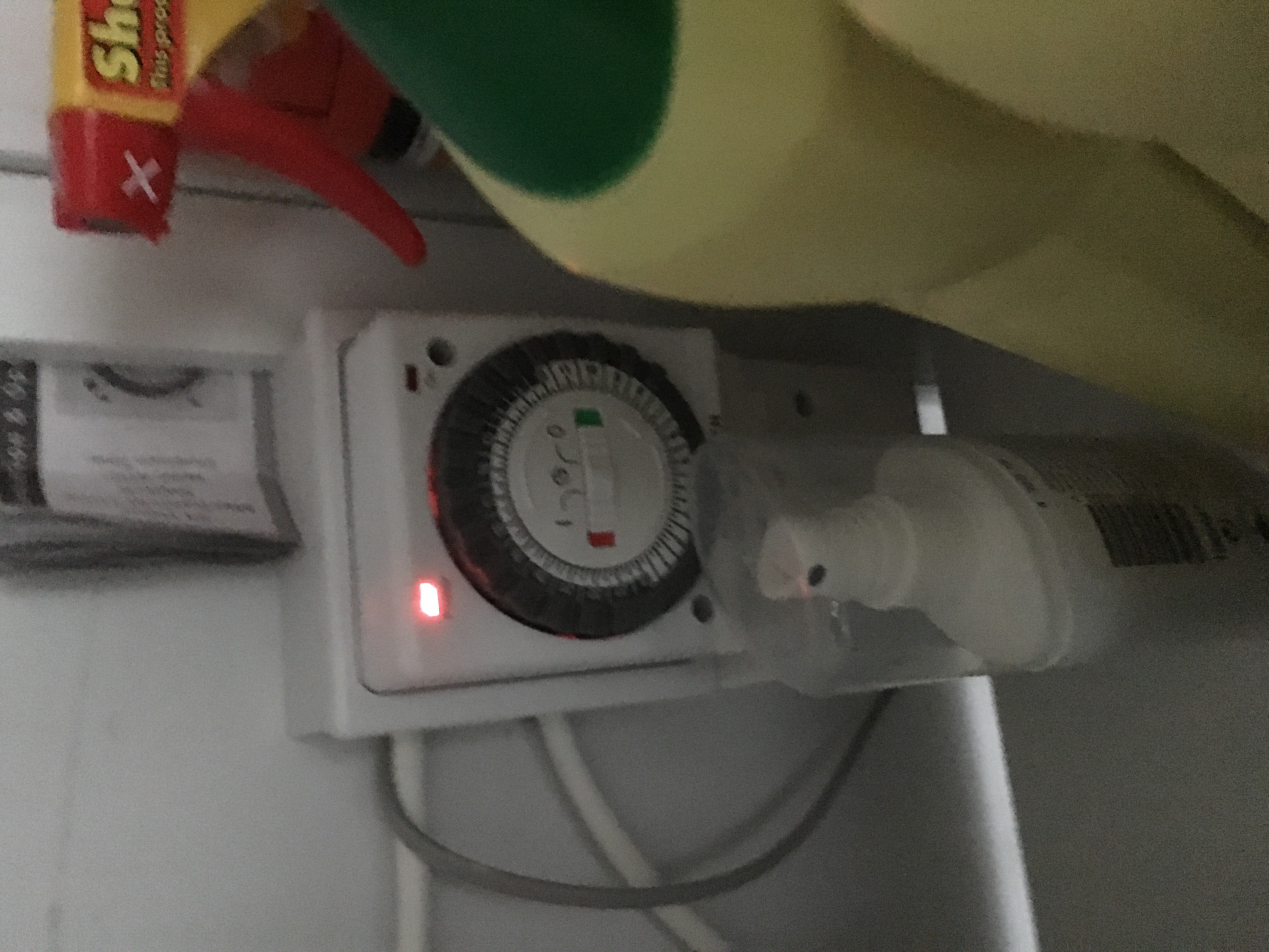

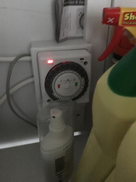

Calvinmiddle Posted March 18, 2017 Share Posted March 18, 2017 Hmm Not sure I can do this experiment - as the pump in the first photo is wired into the timer that controls the pump that goes from buffer to manifold. The pump on the manifold and also the NC value. So no way to isolate the pump in the photo from the NC value which is what I would really need to do. Link to comment Share on other sites More sharing options...
Nickfromwales Posted March 18, 2017 Share Posted March 18, 2017 Just dewire the pump and put the cable ends into connector blocks ? Or does that pump have a wireable plug that you can remove ? All you need to do is lift the live and just conn block it, don't even need to remove the wire tbh. . Link to comment Share on other sites More sharing options...

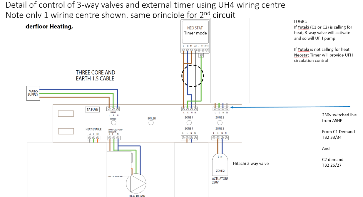

ragg987 Posted April 26, 2017 Share Posted April 26, 2017 (edited) I used a separate timer (Neostat) for the passive circulation and a UFH wiring centre (heatmiser UH4) to control the overall logic - very simple and no automation systems required. Schematic attached. The Hitachi 3-way valve is used to open or close the supply of heated water from ASHP to UFH. When off, the circuit is closed, ASHP is off and the timer controls if pump needs to be on for passive circulation. Edited April 26, 2017 by ragg987 clarify logic Link to comment Share on other sites More sharing options...
